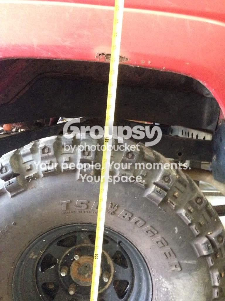

Here's my before frame height 21" on 37s

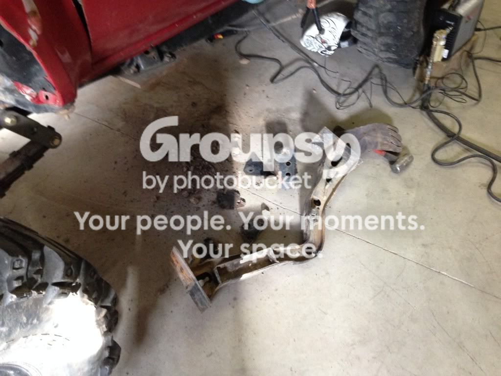

Didn't get a lot done last weekend so no update, cleaned the shop. Cleaned for 2 hours, installed a blower motor in a Bonneville. Managed to get the plasma torch out for a hour or so. Cut off old spring hanger, torsion adjustment bracket and my raised horsecollar.

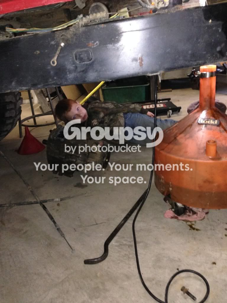

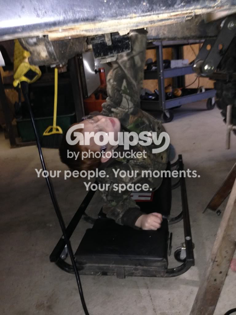

Me and rylan got lots done today. Was so busy only got a few pics. We disconnected the wiring harness from ecm, all the vacuum hoses, brake lines, heater hoses, battery. Anything that wont allow body to be lifted off the frame/drivetrain.

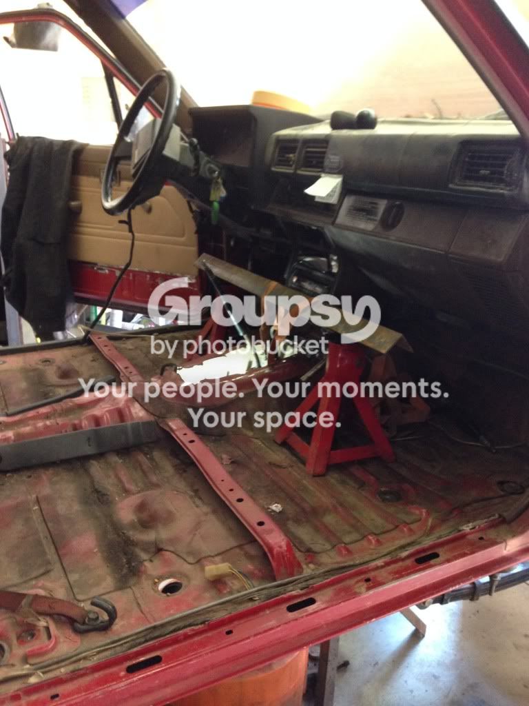

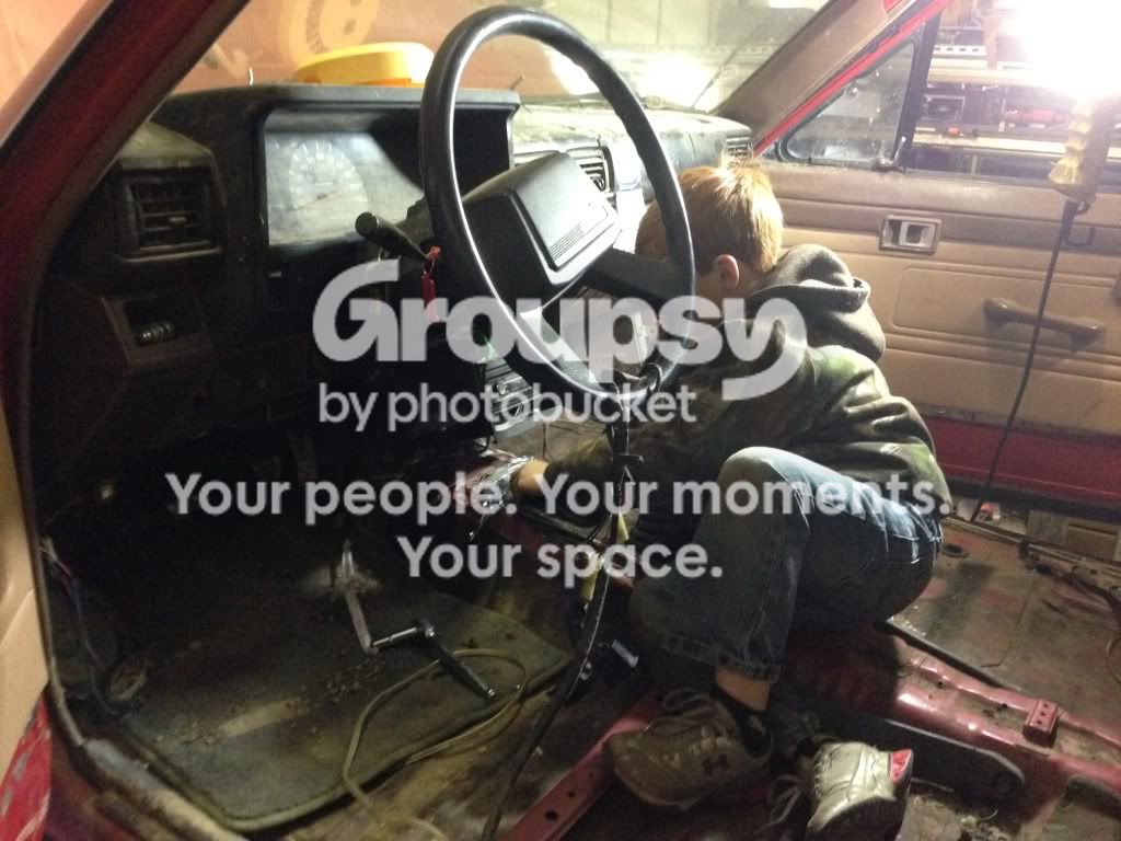

We than removed both front seats/console. Here's rylan taking off the shifter boot and t case shifter
While he worked inside I took off the crossmember.

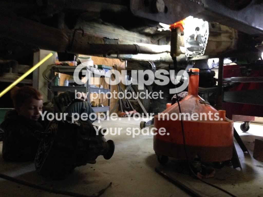

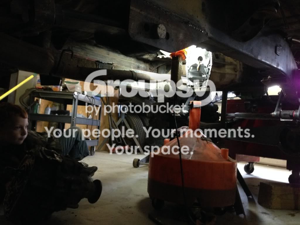

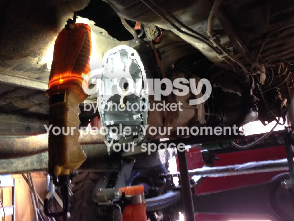

Then rylan helped me remove the transfer case bolts after draining of coarse.
Here's the case out
Made a hoist for the transmission

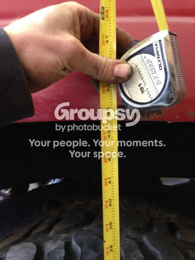

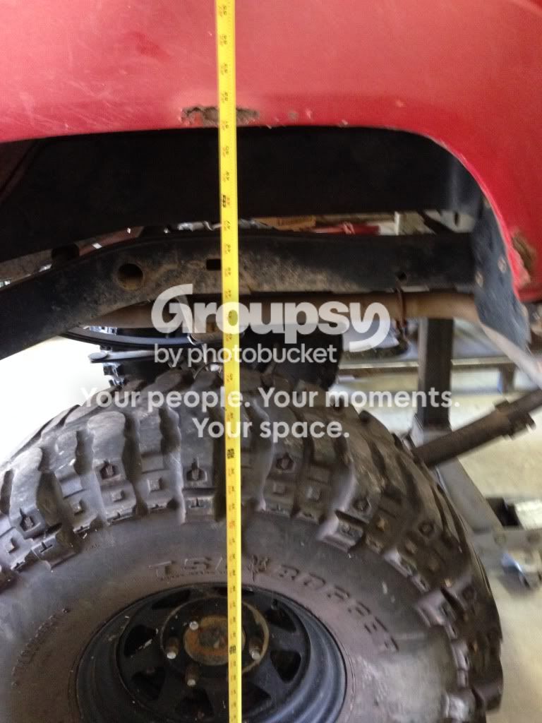

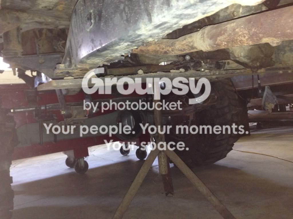

Alot of people end up running a 2" block in the back to make up for the height. Rear looks like it flexes well, but the front looks like its hardly moving? Do you have flex shots after taking a leaf out?
Sorry busy today I do have pics after me and my son pulled that Downey leave.
null_zps83b95cf6.jpg~original
null_zps2b44f4cb.jpg~original
null_zps34601bdd.jpg~original
I don't think this cherry picker flex test is the best method. I'm going to get the body lift off. Buy my buddies bead locks with 37" pitbulls. And flex for mounting bumps and shocks. But I have to be able to drive it around the back of the building( big pile of logs ).
I don't really want to run a block in the rear. The springs I got are like new, so don't want to replace. What about doing the ZUK mod like the the saggy original springs would need?

Im at 25.75 frame height on these 37's with tread.
shackle angle looks alot better also
