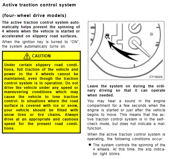

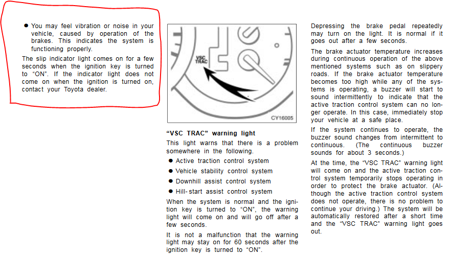

Just to be perfectly clear, here's the straight scoop from the 2004 owner's manual on ATRAC in 4WD models - hopefully I'm not breaking any laws by posting this. Link included for completeness. There's no verbiage in there anywhere I can find that links ATRAC to 4LO or Diff Lock. It's always on. I do think it's funny how the manual says "Leave the system on during ordinary driving..." when there's no real way to turn it off :)
http://www.toyota.com/t3Portal/document/om/OM35811U/pdf/01omsour/2004/044runne/17.pdf

Ahh wait, I get to correct myself now. :)
Apparently in 2004, it wasn't called ATRAC. It was just called "TRAC"!
Based on my scanning of all the various 4th gen product brochures, ATRAC wasn't available until 2009 and only then on the Trail Edition models, which also came with a factory rear e-locker. Other 2009 4Runners (SR5, Sport, Limited) came with plain old TRAC and not A-TRAC.
What's the difference between TRAC and A-TRAC? Beats me. :)

ok so youre still a little off. TRAC is the normal street driving traction control. it makes the same sounds as ATRAC its just not as aggressive with its application of the brakes. ATRAC is the more aggressive version of TRAC. all 4runners with 4x4 from 03-current have ATRAC. unless you see VSC off on the dash ATRAC is not active since the two would pretty much end up countering each other on a lot of cases since ATRAC is so aggressive with the control of the brakes and its stopping and releasing wheels so quickly VSC would just cut power to the wheels. In 2009 the button was added to manually activate and deactivate the ATRAC in the TRAIL edition just like how it is in the TRD offroad tacoma and trailteams FJ.

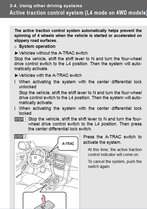

Here's what the 2009 manual says.. Kinda confusing. It appears that on the 2009 Trail Edition, when you lock the center diff (which it has, apparently), A-TRAC doesn't turn on by default. You have to toggle it on with the button.
It does say that if you have the rear locker enabled, A-TRAC is only effective below 4mph.

yep my dad has a 2012 trail. every time he turns it off when were on trails he has to remember to not only hit the rsca off but also the ATRAC button. and the speed limitation is kind of a ***** some times too, i really need to do the gray wire mod on his
