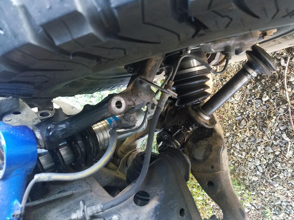

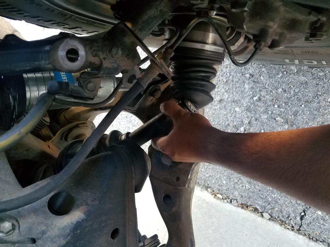

Here is some pictures of my last run.. Take a look at the axle, thanks to Atrac. This is what happens when you run Atrac too hard trying to make it do things it doesn't really wan to do but I guess technically could..
If you plan to run your 4th gen 4Runner hard, I mean really hard, do not rely on Atrac or you may be walking home. Get a locker or something

welcome to the broken CV axle club. after i broke both front CVs at the same time and had to drive 30 miles home is when i decided i needed a locker. best investment i've made aside from the sliders. but for mild to some moderate wheeling ATRAC should be fine for the average user, i'm just not the average user.
