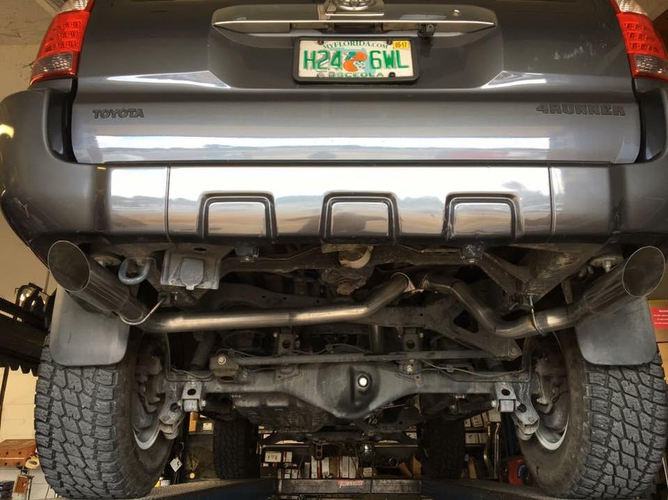

I've got both pipes flowing into one dual chamber Flowmaster 50 series with no resonators and the second set of cats cut of = one LOUD exhaust system. I wound up putting larger resonators back on and now it's perfect. Feels like it has a little more power and mpg's have stayed the same, around 16.5mpg mixed city and highway driving .
