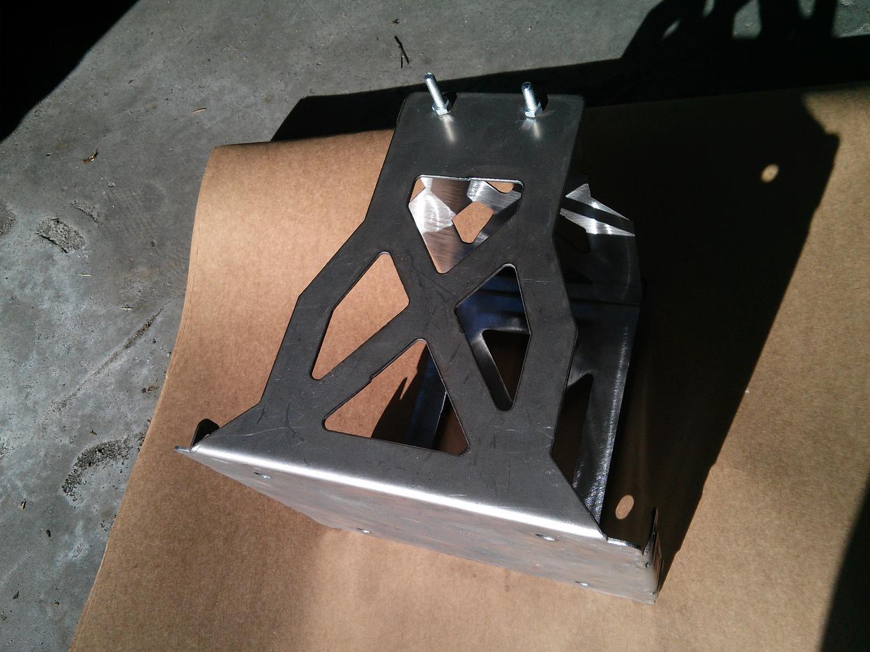

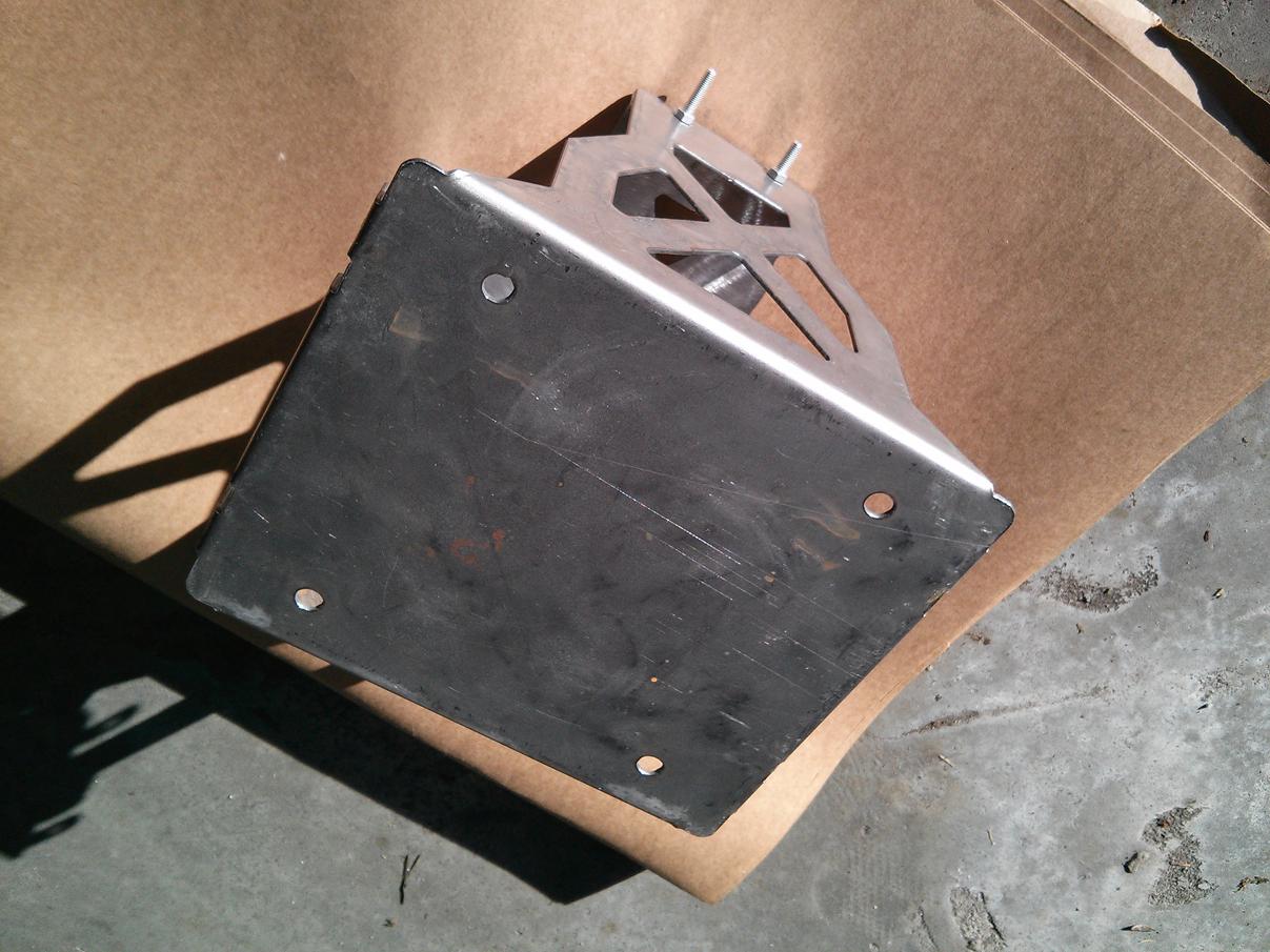

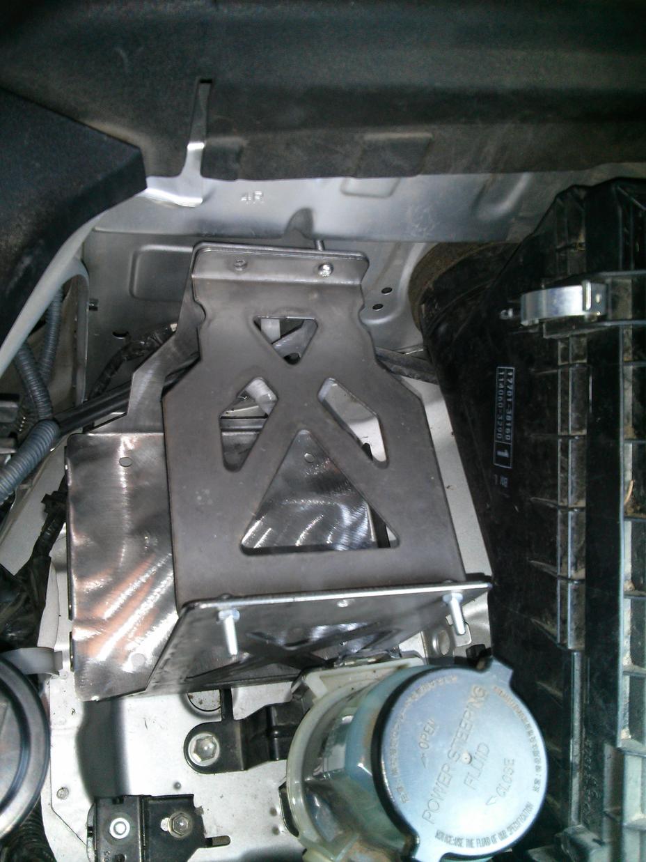

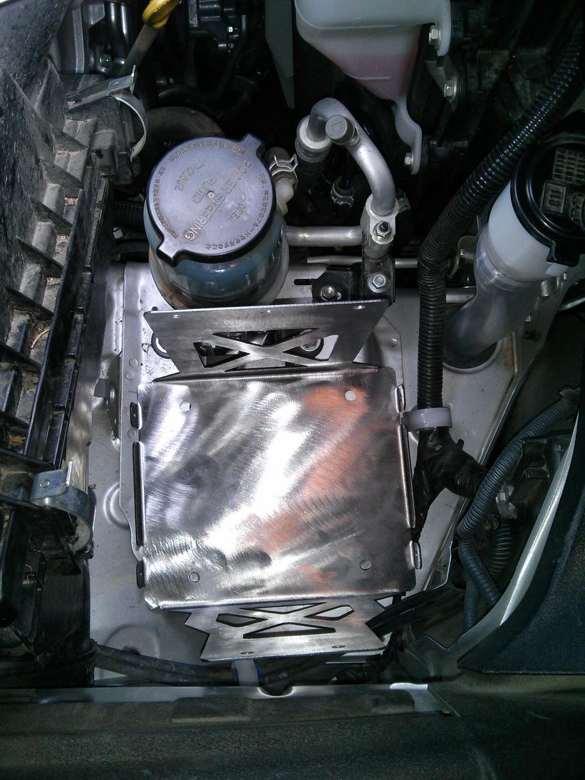

1. To start with, I target the battery Odyssey PC1200 ($220) which is also used in other threads of dual battery system of 4runner. It is small size and provide medium power, should be sufficient for most of the applications.

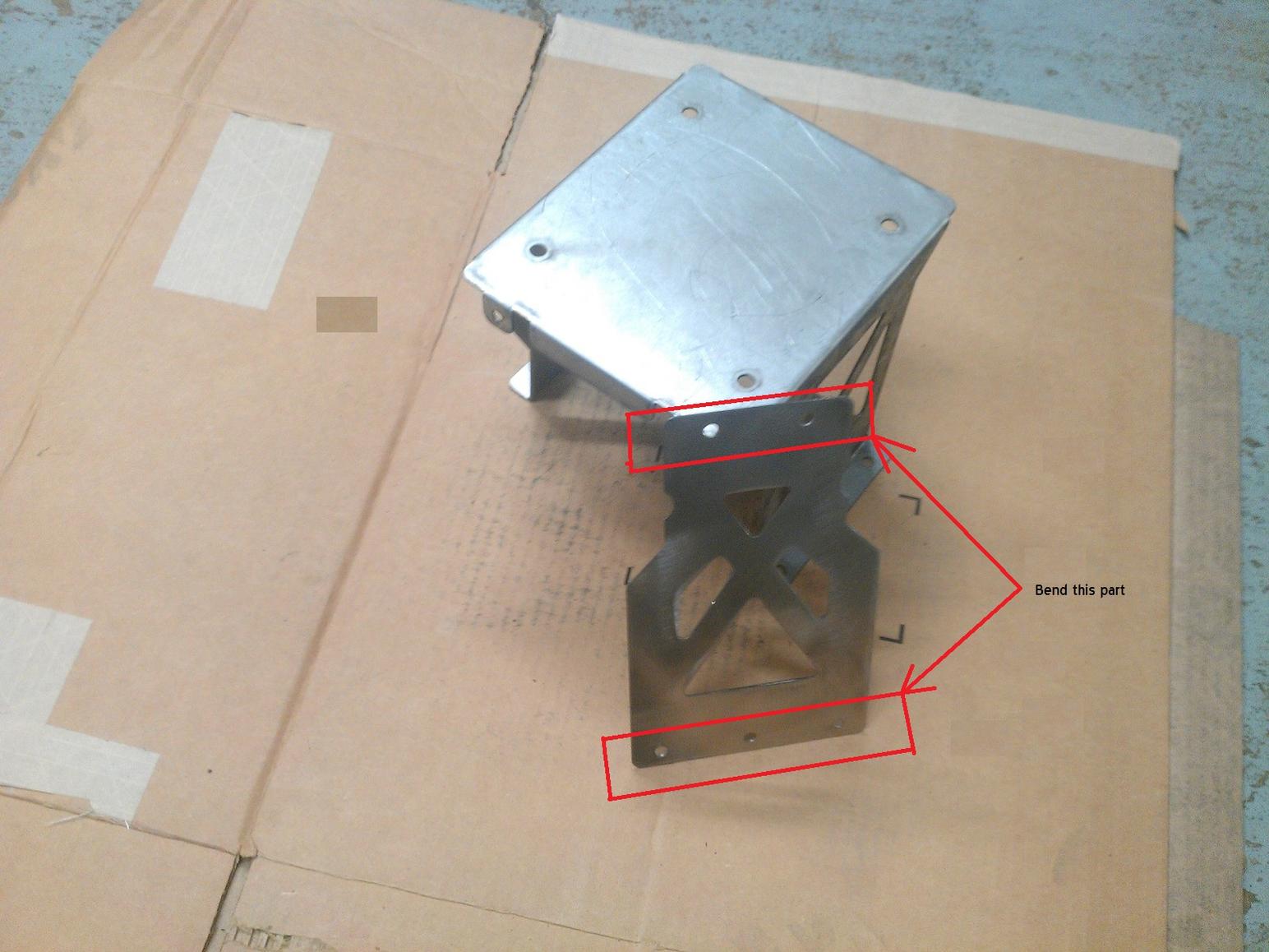

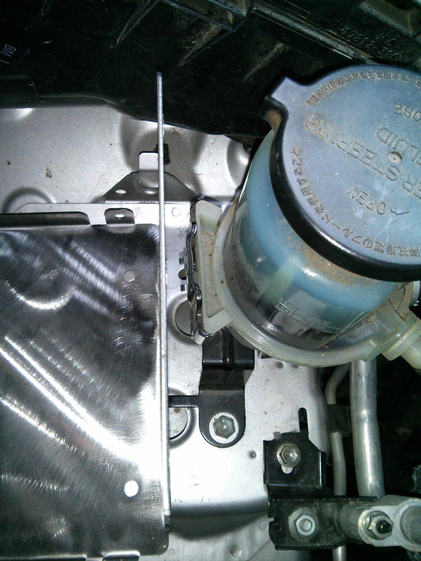

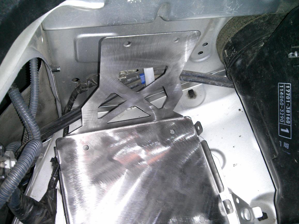

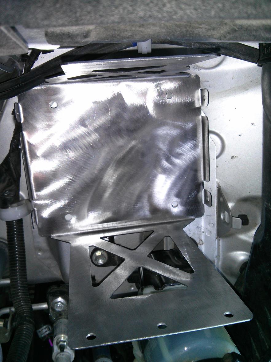

2. With minimum cost investment and lowest risk to verify if this is feasible, I have to find a battery tray to see if it can fit into the 4runner. I found a battery tray ($23) in Ebay which can fit EXACTLY under the hood. Yes, $23 only ! The supplier can modify the tray (make it compact, the lid bends upright, see photos below) without ADDITIONAL cost. This tray is thin (width X length X height) enough to fit into the slot ! No need to spend hundred dollars for the ARB battery tray !
3. Your initial investment is only $23 to see if it works before you proceed to buy those expensive items e.g. battery, isolator….

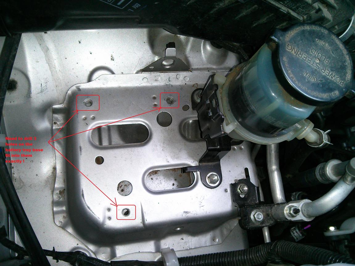

4. The challenge would be how to drill 3 holes on the base of this battery tray so that it can exactly mount on the empty slot. Stop here and think about it before go further.

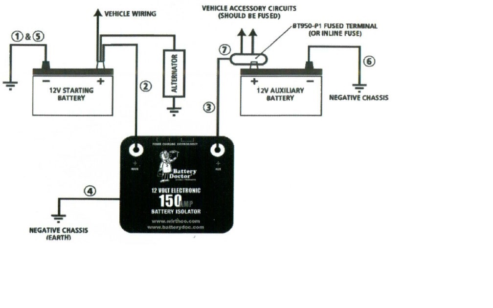

This is to give update. A circuit / wiring diagram is attached for reference. It looks that this configuration is quite simple and easy to understand without connecting to your engine (start power wire). In addition, there is no modification to your 4runner alternator as well.
Hope to see some feedback about the choice of material and diagram proposed.

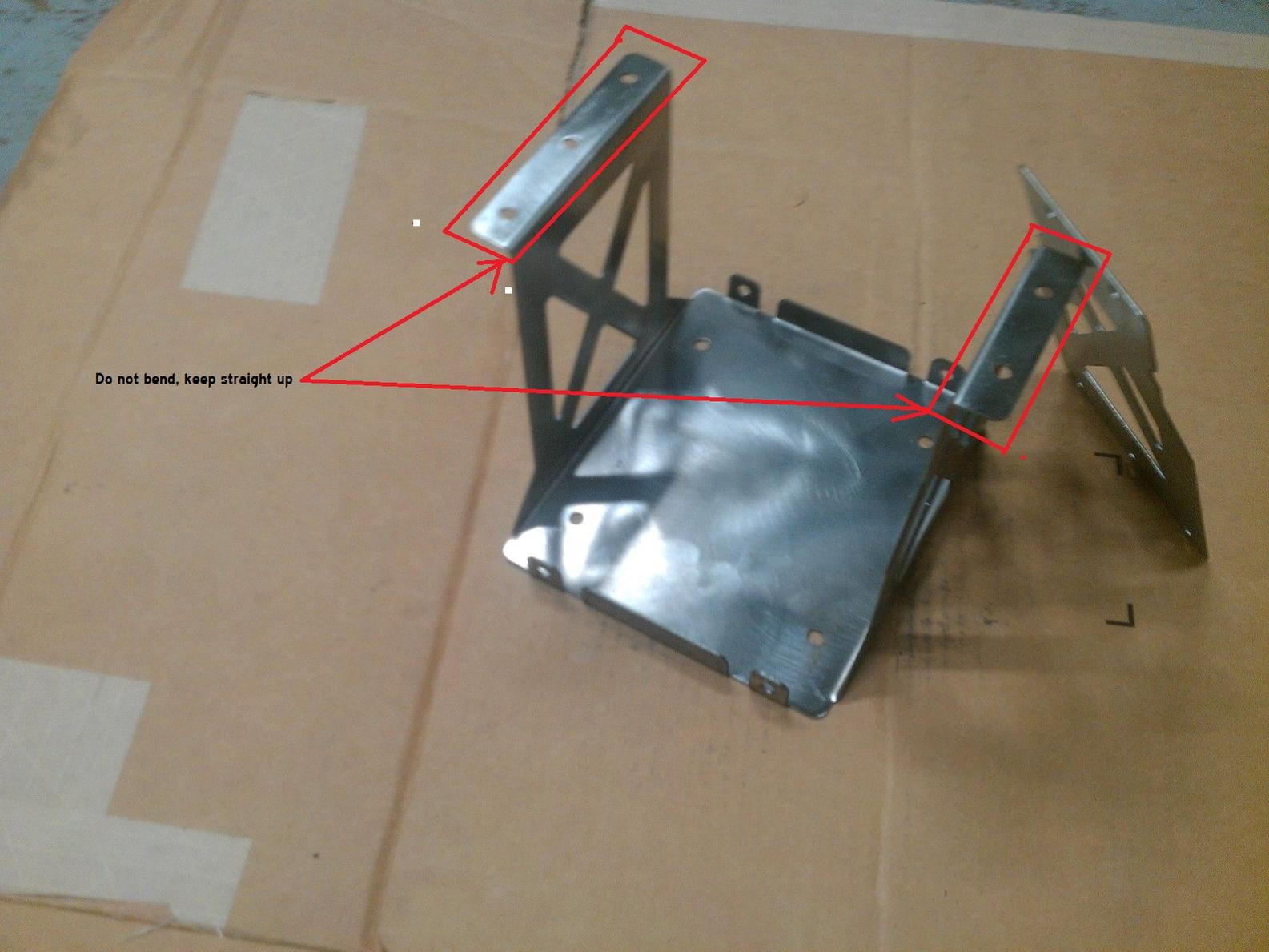

Would you consider to start with a minimum investment to purchase the battery tray ($23) to see if this really fits into the empty slot? If yes, please be reminded to ask the supplier to do the tray modification that I asked. There is no additional charge for it.
What modifications was it you had them make to the tray?
On a side note you'll need to put some paint on that tray since it's bare steel or it will rust.
I have the contact name and Email address of the battery tray supplier. If you need his Email, I can send it to you. He is a nice guy and willing to modify the tray without additional charges.
I attached the photos of the modification requirement that I sent it to him. He really did a good work and ship the modified tray to me.
Please feel let me know.
** Yes, need to paint the tray. I don't know what kind of paint to use as well **

Could we move the gizmo that's in the way? Looks like it could move aft the air intake with a longer hose. Comments?
It is definitely movable. This other tray from Sidewinder in Australia includes brackets to relocate the power steering reservoir: Prado LC150 2010. However, I think the point of this thread was to be able to put in a battery with minimum work. It wouldn't be too hard to modify a battery tray with a bracket to move the reservoir if needed. For my needs I don't require a large battery in this location.
The easiest thing would be to spray it with some Rustoleum etching primer (since it's new non-rusty steel) and then with what ever color of Rustoleum paint you want. You could also use the spray on bed liner stuff if you prefer.
That tray doesn't appear to have any way to tension the battery down like your typical battery tray does. I wonder if the battery would end up rattling around much if it's not tensioned down to keep it from moving.
I was thinking the same thing
