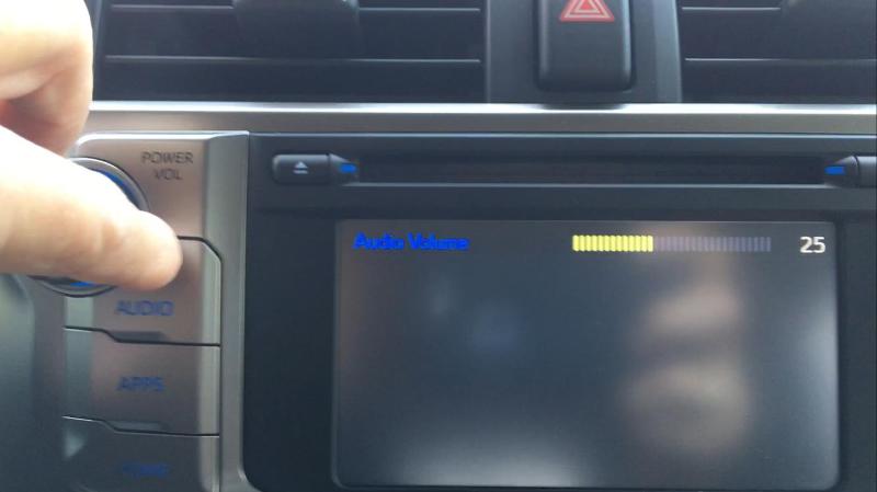

Coincidence.....
Got in the 4Runner this morning to take it to the dealership to get 45000mi checkup and get tires/wheels balanced and rotated.
The HU that was replaced back in March 2016 under warranty had a black screen.
As soon as I hit the Home button, I had full function.
So, I mentioned it to the service writer and since it is out of the 36000mi warranty, they want to charge for the update (if needed).
So I am going thru the motions in the event I continue to have problems.
If they update the HU w/ new software update,
I will post it.

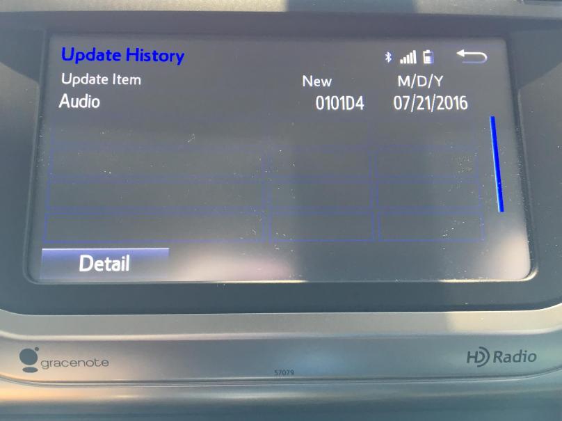

Ok, so there is a new software update for our HU's.
The tech said Toyota is definitely aware there are issues!
