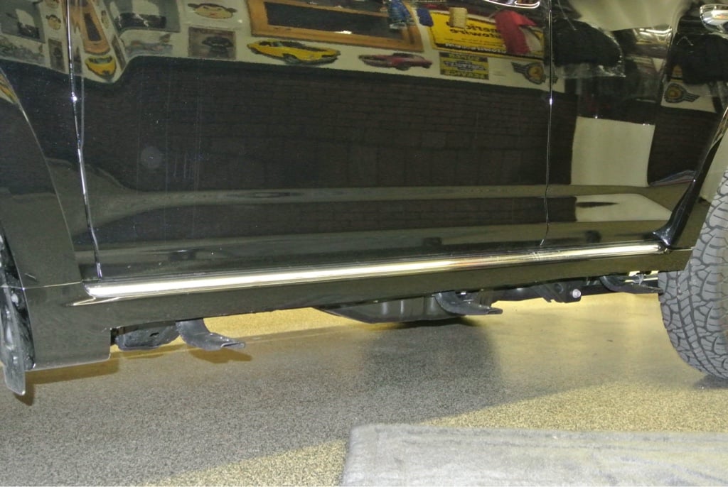

Option B would be to trim your limited rockers. Super easy and it's free
You have a good point! I hate to cut into anything on mine since I've not yet had it a year. But after doing a simple lift, I'm ready for upgraded suspension..X-reas isn't anything special (to me anyway) before or after the lift.
I keep thinking I don't want to cut them, but chances are that i most likely won't ever put the LE rockers back on anyway...just trade in for a newer 4R, assuming Toyota doesn't go crossover on us. Also need to look into finding someone local to wrap the front chrome on my bumper. I LOVE the look of the non-LE and TRDs but for what I do, no use in going that far. But the side rocker panels is definitely something I'm going to do!
After hanging out in this forum for a few months now, I've concluded the least expensive lift for T4R LTD's is to remove the rocker panel. LOL
I did the TRD Pro Suspension but if I were to do it again I would consider the Bilsten's.
Just cut it and when you trade it in no one will ever notice. I should have continued the cut on my all the way to the front and it would have looked just fine.
You are spot on especially on a limited and someone actually trimmed the front cover on a limited back in the day and I just need to find the picture.
btw it looked really good.
I have to mention that I did ZERO cutting just removed & mighta busted some of the clips but all can be added back on if needed ! :humble:
Did you find a reasonable priced Online store to purchase these? Curious on what the total cost came to?
Nope. Most places priced around the same, and the most expensive part was the actual rocker panel. I tried looking at junk yards but it was a hit or miss. I may opt to cut them or just put some N-Fab nerf bars on for now.
