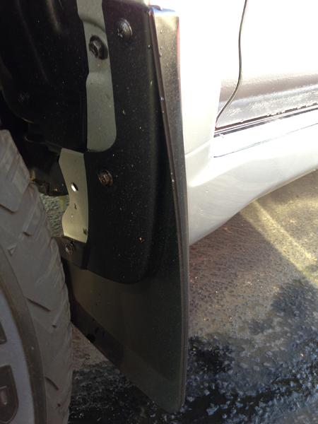

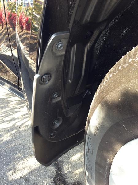

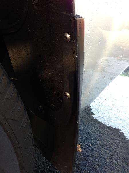

Parts are installed. Install was straightforward, I just had to trim a small piece of the plastic as shown below. Luckily the modification is not visible from outside. The 2014 front flare extension fits the contour of the 10-13 LE flare perfectly on the outside but there obviously some very slight differences to the underside of the 2014 front flares. The 2014 flare extension came with the snap clips, and the rocker covers came with all the snap clips. I reused a handful of the screw from my old LE rocker trim. The only thing that was missing was four plastic rivets for the mud flaps. I had a few laying around in my garage that I used. The end result looks great and I'm happy. It was dark when I finished, I'll try to take some pictures of the truck tomorrow.
The area of the 2014 fender flare extension that interferes with the 10-13 LE flare circled in yellow:
The area of the 10-13 LE flare where the 2014 flare extension interferes:
The area of the 2014 flare extension that I trimmed:
Another difference, the 2014 flare extension has two yellow fasteners, the 10-13 LE flare only has a mounting hole for one of them (i.e. the rearmost yellow fastener doesn't have anywhere to snap into). So the extension is held on by one clip and one screw. I installed the mud flap which provides additional support, so I'm not concerned about the lack of the second clip:
Here's a picture of the flare extension and rocker cover installed:
Here's a picture of the front 2014 mud flap installed:
Now, the LE Rear door flare doesn't line up with the rocker trim. It's fine for the time being. I have a hunch that the 2014 door section of the rear flare will line up with the 10-13 LE rear quarter section. I traced the profile of the 2014 rear flare on a piece of paper, it appears to line up. The part is around $50 each side but it comes unpainted. Eventually I may give it a shot, we'll see:
