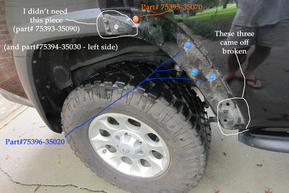

You will need to remove 6 bolts on each side of the with the 12mm socket. Then use the 10mm socket on the smaller hex head screws. I used the 1/4 inch socket to hold a Philips head screw driver bit for the button head screws on my mudguards. Once all the screws/bolts are out you will need to remove the red clip at the front and the rear plug seen in picture two and three.

Once everything is off, line up the drain plug in the trail rocker with the hole from where you removed the plug and then snap in clips and replace all screws. Then snap in the trim covers and bolt on on the mudguards. I also replaced all of the 12mm bolts so that there was no open holes for debris to get in.
Does any one know what is used in the hole seen in the below picture? Looks like I need a plug or snap or something.
I think I found what I need. I am taking these metal clips off the limited rocker and mounting them on the trim covers. I should then be able to use the extra button screws to finish fastening the mudguards tomorrow when I install my shrockworks step sliders.

Thanks [MENTION=45752]byrden[/MENTION] and [MENTION=97134]IronManKansas[/MENTION] just installed my trail rockers tonight, your info and pics made it a piece of cake. For kicks I measured the difference in height, depending on the point you go to it was about 3.5 inches higher with trail compared to my LE rocker. I also recently took factory steps off, went from 12" of clearance to over 18" (keep in mind I'm lifted), shrockwork step sliders up next...
Oh and I did put the 14+ front mudflaps on, good stuff, just had to snag one plastic clip off the old rocker for each side, otherwise went on easy as could be.
