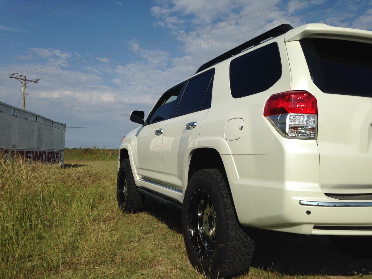

looks good. This is gonna be a highway driver so Im looking to run on factory suspension with no lift. Just looking for something wider than the 20x7 factory rims.

Anyways, heres a pic of my new ride. I think a machined faced wheel will look good with the silver. I actually like the look/finish of the factory ones, just wish hey were wider. Trying to avoid chrome. Haven't seen many silver ones with black wheels.
