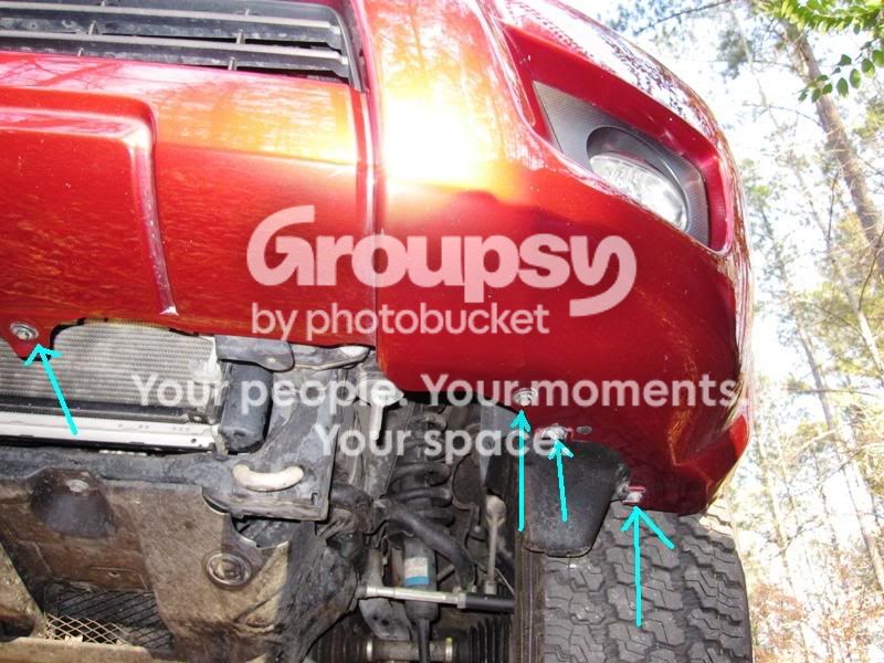

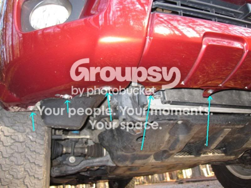

I got my GYSA this morning, $594 total for a set of 4. There is some rubbing when i turn the wheel at full lock, also it rubs alot more when im in reverse turning left/right. Looks like i need to do some trimming :[. Anyways GYSA are great tires, went to a trail with couple friends and i was just driving thru everything, i almost got stuck at one point where the snow was as tall as my tires BUT i didnt get stuck.. just almost.
That's odd and a bit disappointing to hear... Wheelspacers? Are you rubbing mudflaps or the front of the fenderliner?
I just went out to mine and looked at mine (assuming you were rubbing the front side of the fenderliner). With a 10mm socket I was able to get myself even more clearance easily, no cutting. I loosened all of the bolts shown in the pics and held the parts forward while I resnugged the bolts. I re-tightened from the center out. All of the holes have 'slop'. By putting the liner and the lower bumper at the fwd limit of the holes you'll gain some clearance. The whole thing took me 6 minutes, tops!

:iagree: if your not using wheel spacers, & your just rubbing the inner fenders, dont cut anything, move it forward like cj3flyer says

I removed the nuts, but what do you mean by moving forward? Seems like i need to drill a hole for the new position if i moved the plastic liner forward..

Nevermind, found the guide on J.A.'s Site. Thanks J.A.!
"Moving the wheel well liner forward:
But after the installation was complete and I headed out for a test drive, I immediatly noticed tire rub on the inside front plastic wheel liners when turning the wheel at near full crank, or when encountering inclines/declines while moderatly turning the steering wheel. I anticipated this would be the case before the install and knew the fix was an easy one.
Looking underneath the vehicle where the front bumper meets the fender flare, you will find 2 10mm screws on the driver side and 3 on the passenger side. With the steering wheel turned so the wheel is turned fully into the well you will clearly see where the rubbing occurs. The tire was pressed right against the plastic liner. Remove the 10mm screws mentioned above, remove the plastic nutsert, push the liner forward as much as possible, and drill a new hole in the liner. You can discard the nutsert you removed, install a larger washer (I used a homemade rubber washer) and reinstall the screws."

Yea i would say go ahead and move your liner foward an inch or two. Very easy.

I moved the fender liners forward before installing them. It was pretty easy to do, but a drill and some shears (to trim the fender liner material) are necessary.
I have no rubbing anywhere, and plenty of space in the front wheel wells to the front of the vehicle (where I moved the fender liners forward). The tightest clearance is in the front wheel wells, at the rear, where the mudflaps are: at 3/4 turned, there's maybe 1/2" of clearance between the tire and the mudflap.
