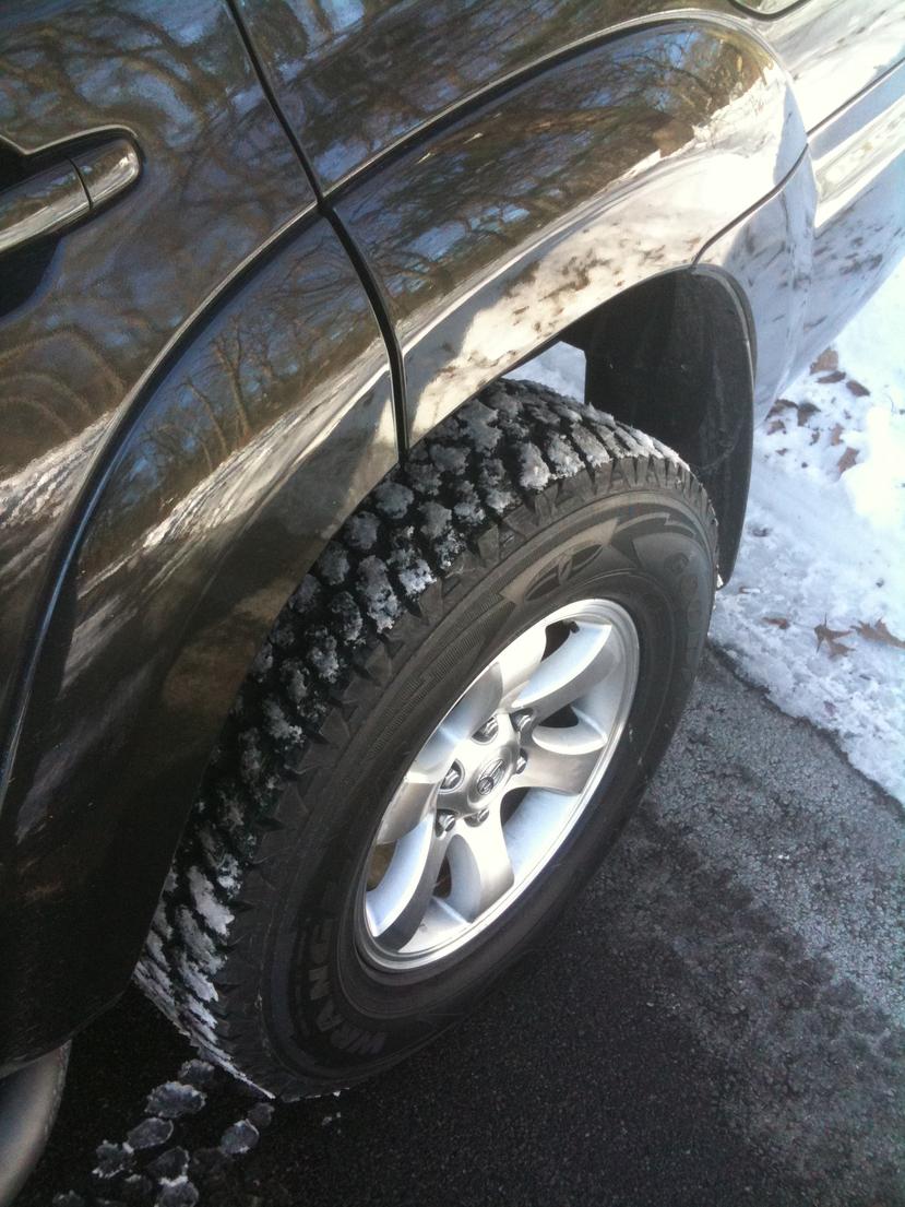

GYSAs1-1.jpg~original

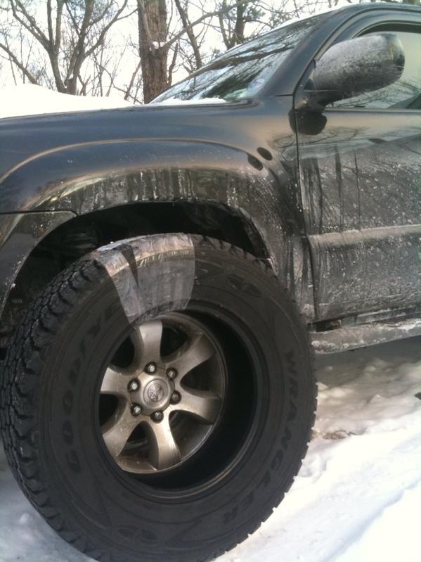

The wheel is cut to show where the tire has the least clearance.

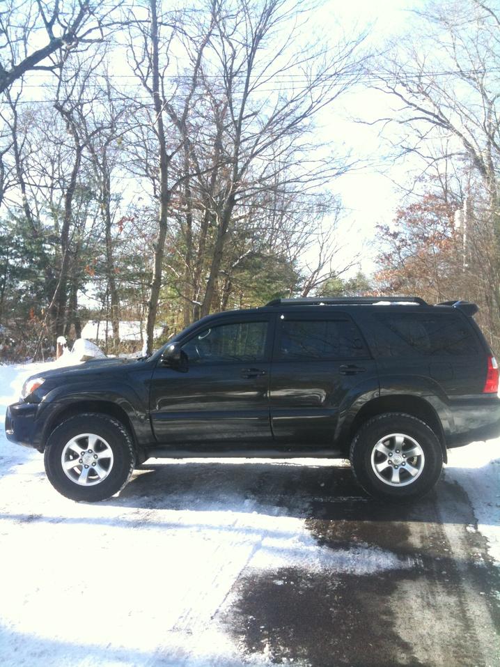

GYSAs2.jpg~original
GYSAs3.jpg~original
My helper…

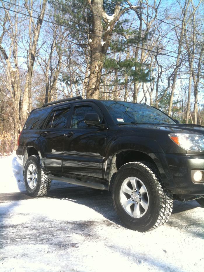

GYSAs4.jpg~original
GYSAs5-1.jpg~original
Hambone, Paraordnance and anybody else feel free to add a pic of yours. It'll just help the next guy wanting to know about 255/75/17's or 255/70/18's:D
hey, im happy to hear that so far, they're working for you. everybody has different tire likes & needs, but i thought these would work for you. goodluck oh yea, great helper!

Looks good! I want to try mine in the snow:D Your truck looks too clean for the roads... How'd you do that:confused:

The front looks CLOSE. :)
Very close but no hit:bigok: It is all good. I even backed up fast, turned and hit the brake to see if I could induce a rub but no rub:D
CJ3Flyr are you noticing any rubbing at all.. Not even talking full wheel turn.. i need to look closer but its been to cold and working too hard.
Otherwise these are great so far looks way better! Notice on highway that definitely taller tire.
No rubbing at all. No Spidertax either. J.A.'s website has wonderful how-to for fenderliner adjustment at the bottom of the page for 'wheelspacers'. http://www.top4runners.com/ja/2007/wheelspacers.html
