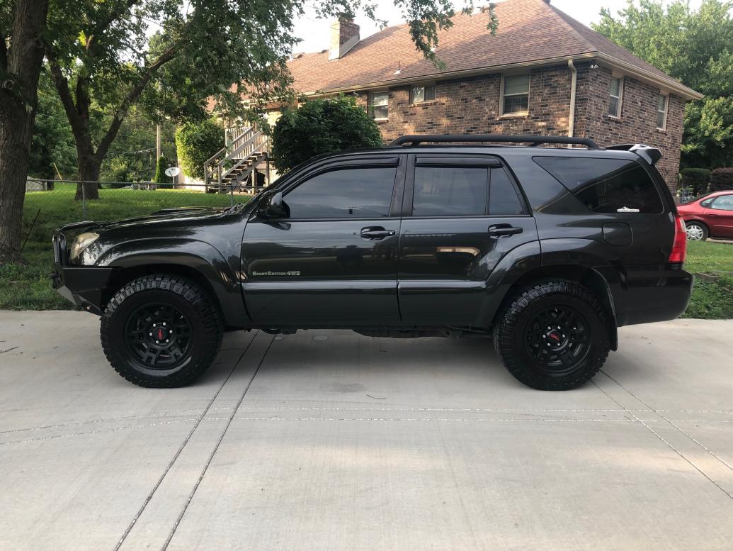

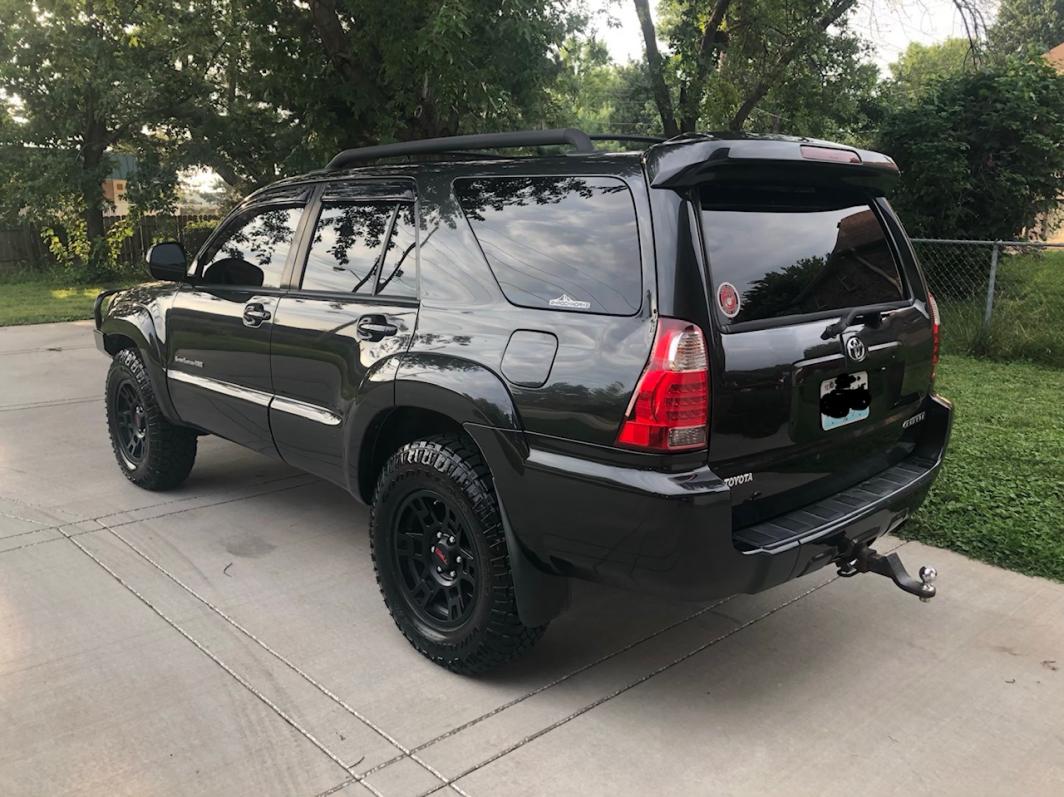

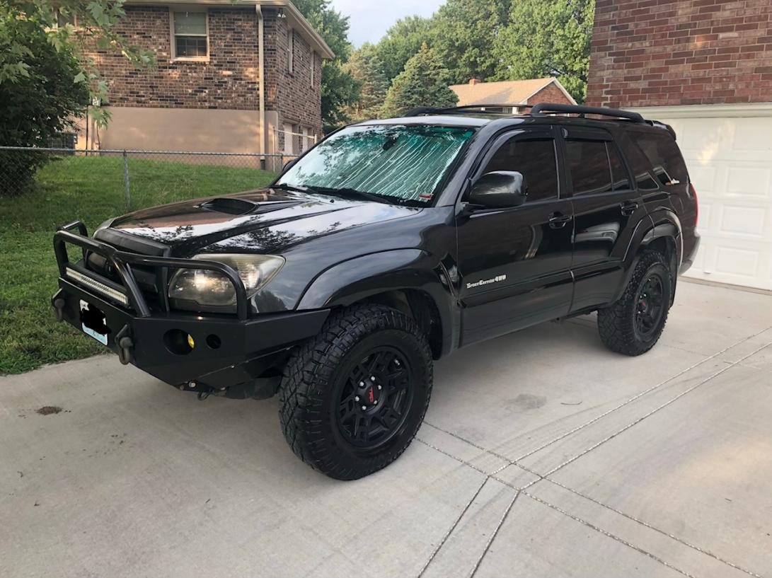

Old thread, but in case anybody wanted to see how my new 255/75/17 Goodyear Wrangler Duratracs look on basically a stock suspension. I have FJ coils in the front which level things out with the Shrockworks bumper. I think i get away with this a little easier than if you had stock front bumper. No rubbing at all front or rear, fully turned, articulating, or anything else so far.
