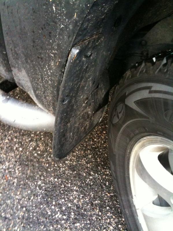

Just moved my front wheel liners forward but seems tires still hitting mudflaps on the rear anyone else getting this and what do I do!?

I just went out and looked again, positevly no rubbing.
You're not gonna like this... The Spidertrax are making this tight. Option 1: Remove the front spacers and sell them to me cheap for the rear of mine:D Option 2: Several run 285's & spacers with trimming and mudflap removal. I'm not truly up on the specifics but I know they do it.
A final suggestion, have you had an alignment lately? If not you can try an alignment and request that the caster be set at or very near the maximum positive value (of the specified range).

What about removing the mudflaps? Or seeing what i can do for trimming.. I am just shocked at how close it really is.. Yeah had an allignment too not too long ago

:iagree: it is the spidertrack spacers, so either you can remove them, or the flaps, just trim the flap where it rubs, or keep driving till it wears thru .
