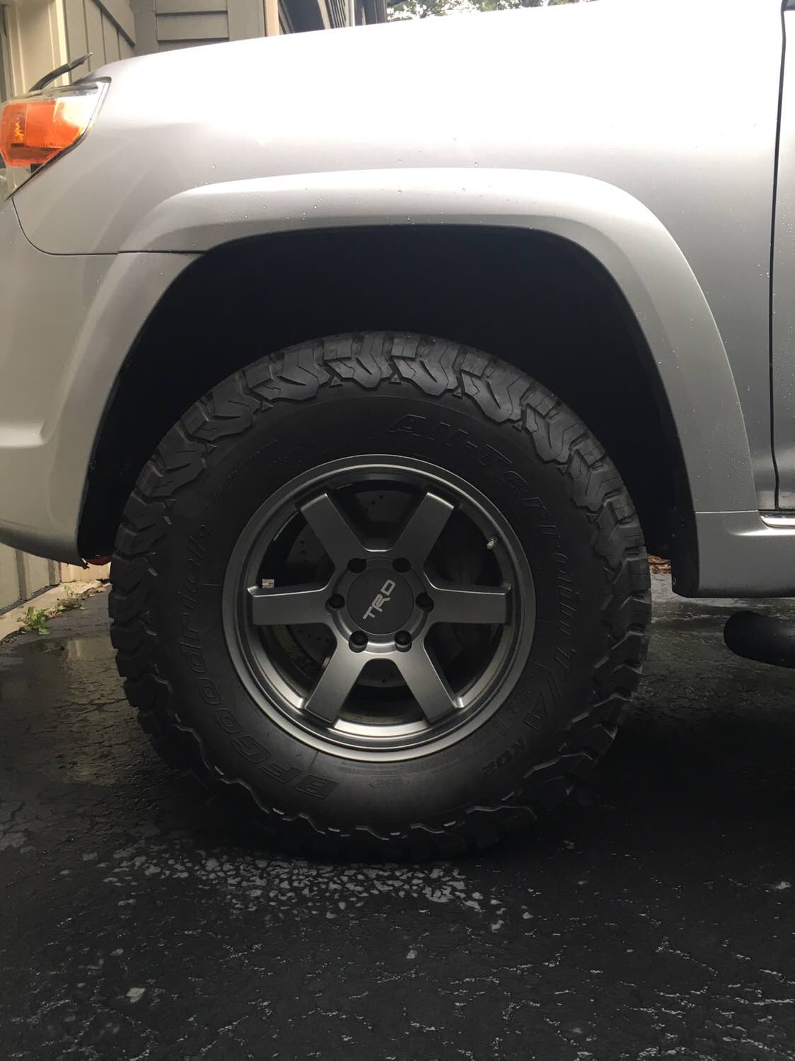

I’m wondering how much a 1/2” difference in wheel diameter makes in mounting this size tire to a 7” vs 7.5” wide wheel.
I see what BFG recommends but how steadfast is that?
I opted to use my OEM 7” wheel solely because of OEM quality vs aftermarket, especially since I actually take my rig off road and beat my wheels and tires up. It was never about being cheap for me. The three tire shops I priced out for mounting didn’t voice a single concern with their systems and mounting up this tire. Nothing was ever flagged.
I went to a fourth shop to patch a tire with a nail in it and they also failed to mention one single concern about the width and tire size.
285 on a 7'' rim is going to pinch the bead in and crown the tire....at recommended inflation the center will wear quicker and the tire will wander. 8 to 9'' will cure this.

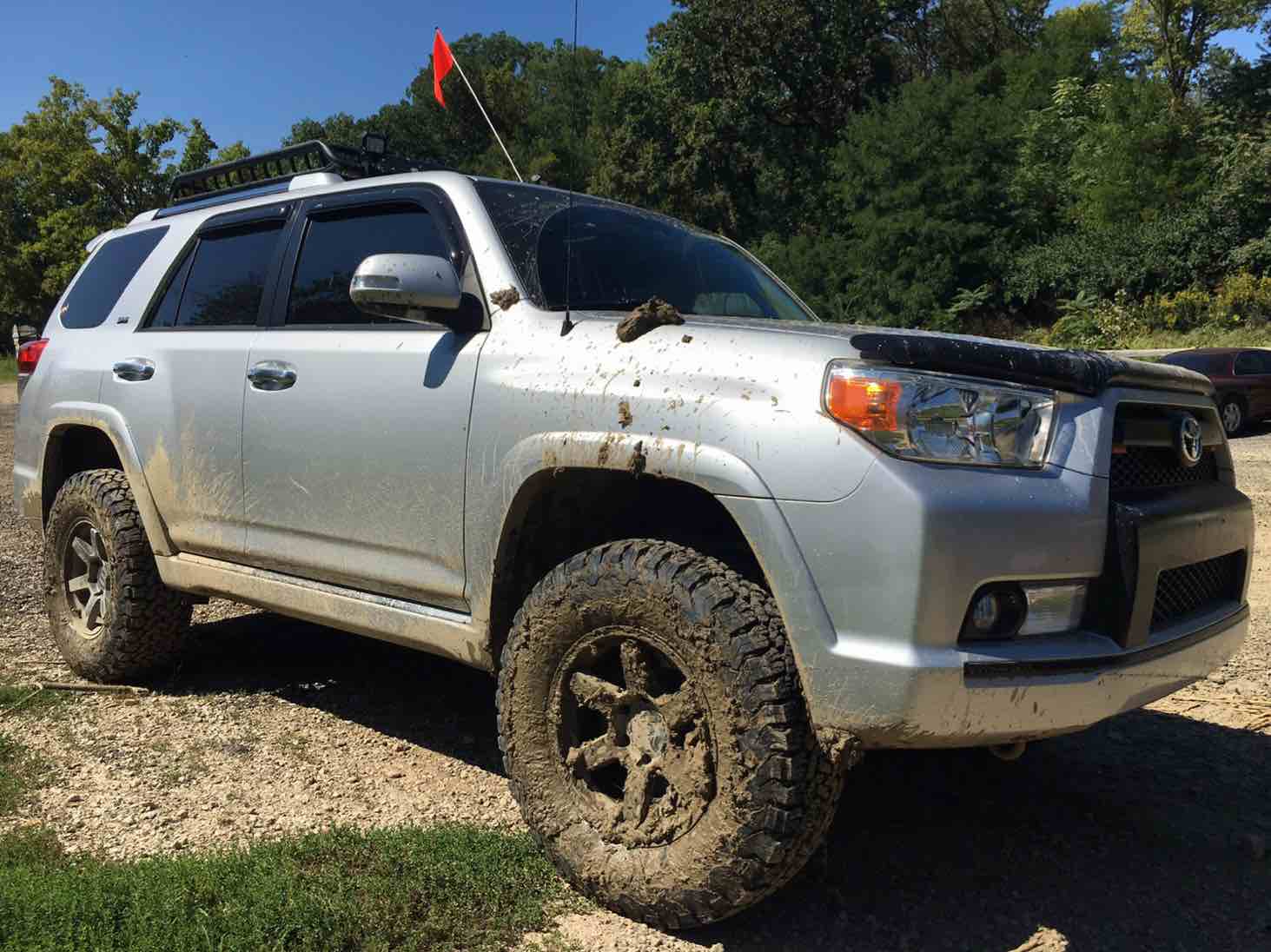

With the record rains, I figured I’d get out and find some mud to truly test these tires. All I can say is wow. I ran through obstacles, deep water and mud that should have created some serious issues but I breezed right through without a lick of drama. If you actually Off Road, get these.

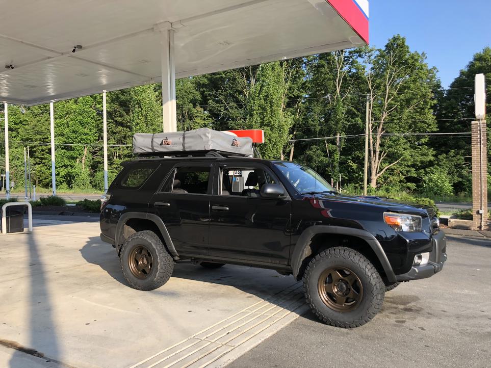

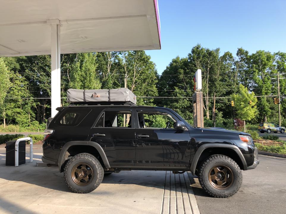

Here they are. Very happy so far with the minimal perfromance and MPG difference
Went with the E rated (had the on my raptor and they were bulletproof) the KO2s are definitely a great all around tire! Just ordered them for the 4Runner today! Along with icon stage 2 and some method nvs in matte jet black, the tires look sweet though on ur rig, I also have the black and it’s a good visual!

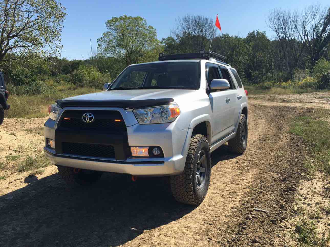

I’ve been testing tire pressures extensively. I’m pretty OCD about this especially when I start with a new tire because it’s an easy thing to monitor that will effect the life of the tire.
Anyways, the sweet spot for tread contact seems to be 40 front, 38 rear. So far it seems to be the right balance for those still feeling it out.
Here’s some new pics with my Level 8 wheels for those interested...

I like those wheels too. :thumb:

Looks good! Are those the actual TRD wheels? If so, the 7” width isn’t in the recommended width for this size tire. You may get a bad ride, drifting, and bad contact patches on the tread. Ask me how I know...
This may not be a big deal to a lot of people but if you’re actually off roading and airing down, you’ll see a difference.
