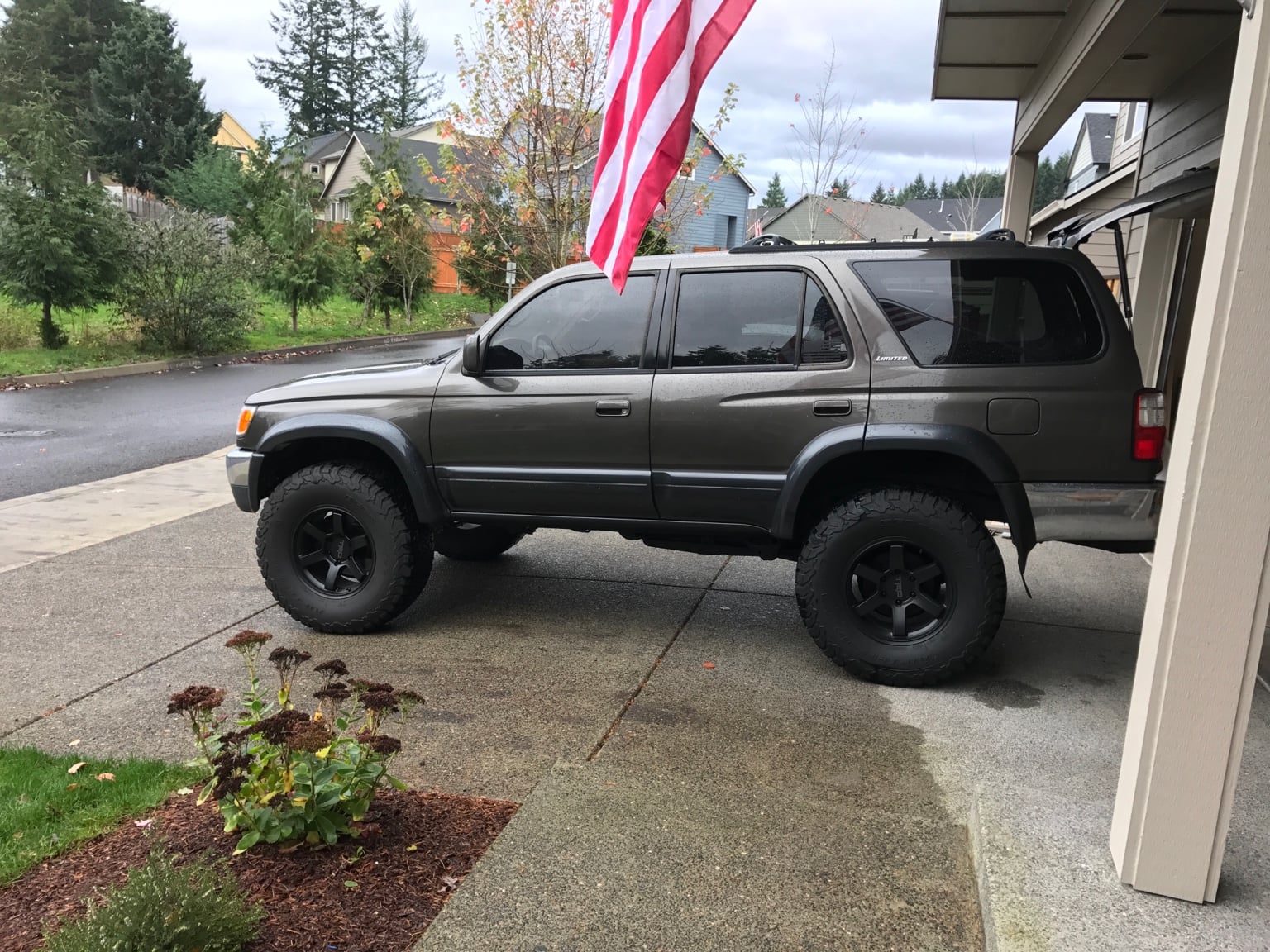

Mine on 315's- I think the 17x9 wheels make the tires look smaller.
