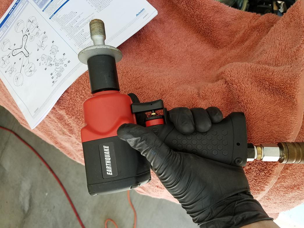

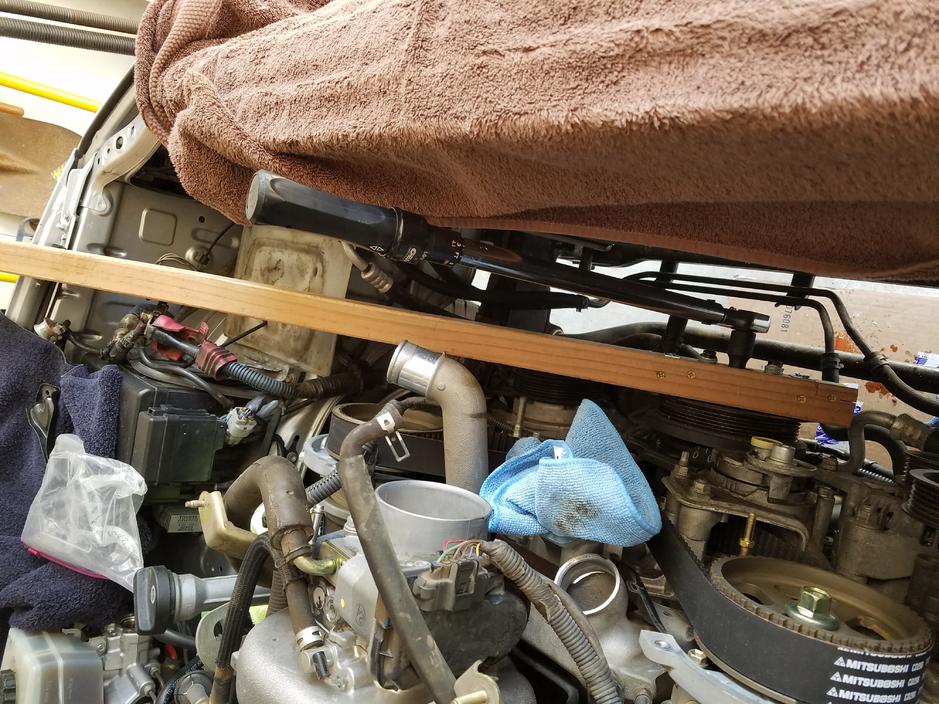

Sure enough. Autozone's 1/2 did the job along with a 2x4 to hold the pulley.
How did you use a 2x4 to hold the pulley? Did you just wedge it in there, or add something to thread into the holes on the pulley?
My homemade pulley holding tool didn't work, so I wrapped the old drive belt around it and hooked it either to the fan mount or one of the UCA mounts, depending on the direction I was turning it.

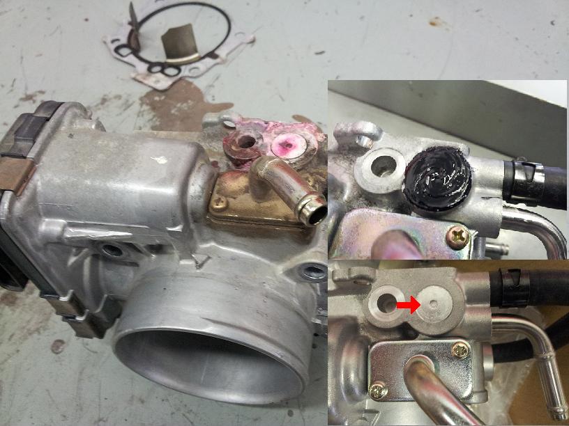

This is just a small "fix" to help save you roughy 1k on a new throttlebody.
When I did my Timing Belt I noticed my throttle body was leaking from one of the plugs on top, its about a grand for a new throttle body and it honestly does not affect performance, but does put your coolant at risk (OAT coolant does not like dissolved air and leaks can quickly degrade coolant's attributes.) I got mine covered unde rmy extended warranty, but a quick and simple fix is to just clean the area off very well, then apply either something like FIPG, or maybe even JB weld over the plug's edges as a "seal".
Here's a picture showing the leak, new Throttle Body's clean plug and my "fix" to the old plug.
I kept the old throttle body, because as I said its still a good part mechanically, just that small leak was the issue.
I noticed my throttle body has the same issue. Why is that plug even there? Is it removable so it can be sealed at the threads?

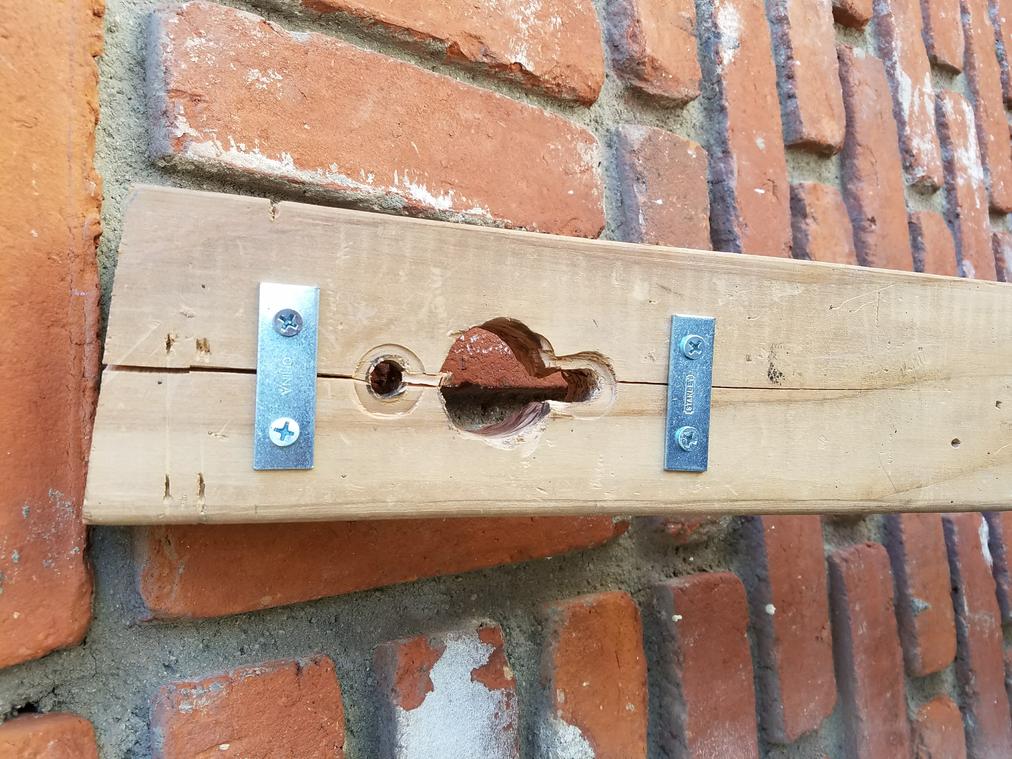

I used the Harbor Freight 1/2" stubby impact to remove the bolt. For install, I used the 2x4 with four 3" screws through the sides as well as 2 metal braces on the face. Even with all of that, it just barely held up to the strain as the pictures show it split badly. It also bent the screws I used to mount the 2x4 to the pulley. Fortunately the wrench clicked just as it was about to let go. :crazy:
I tried to use an old serpentine belt but couldn't find a way to get enough bite on the pulley -- it just slipped. Would love to see a picture of how you secured it as that might be the most strait forward way for guys to do this without any extra tool or home made jig.

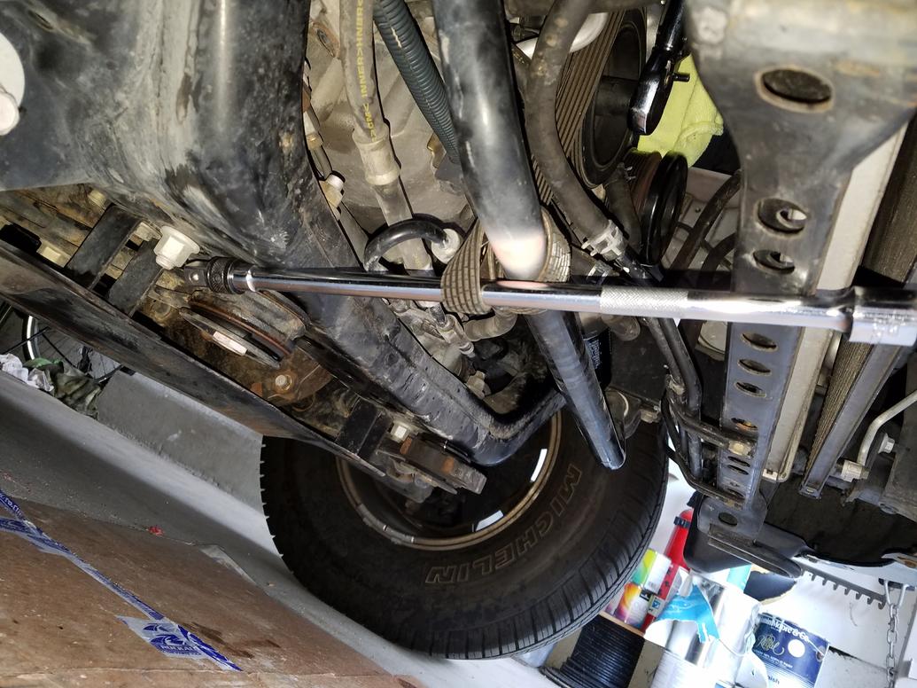

Cool, there might be enough room on the belt to push an extension through the loose end and secure it around the sway bar or UCA. I definitely share your concern about the fan mount -- wouldn't dare try that.

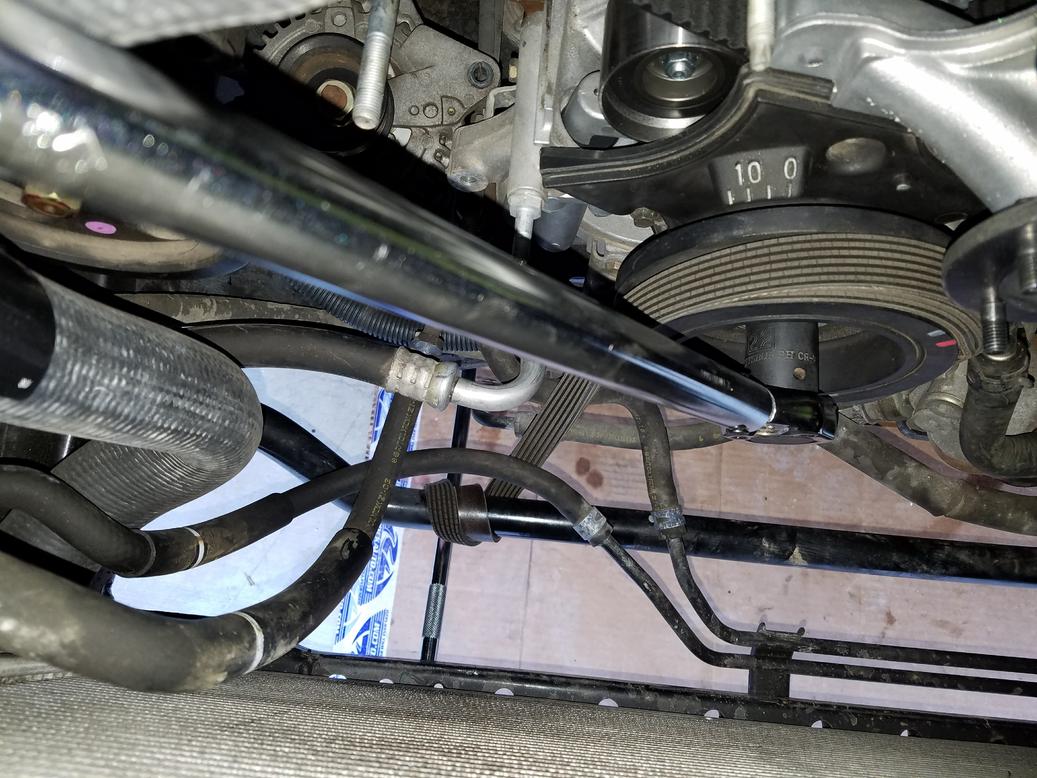

I just gave it a try and was able to easily click the torque wrench at 181ftlbs like this. For anyone that was already changing their serpentine while doing this job, this is an easy way to do it without any other tools.

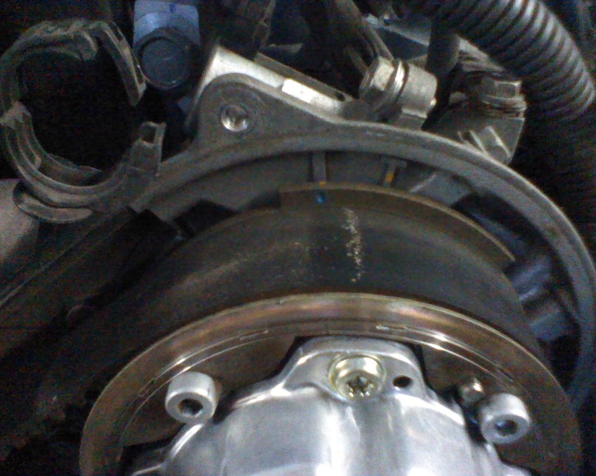

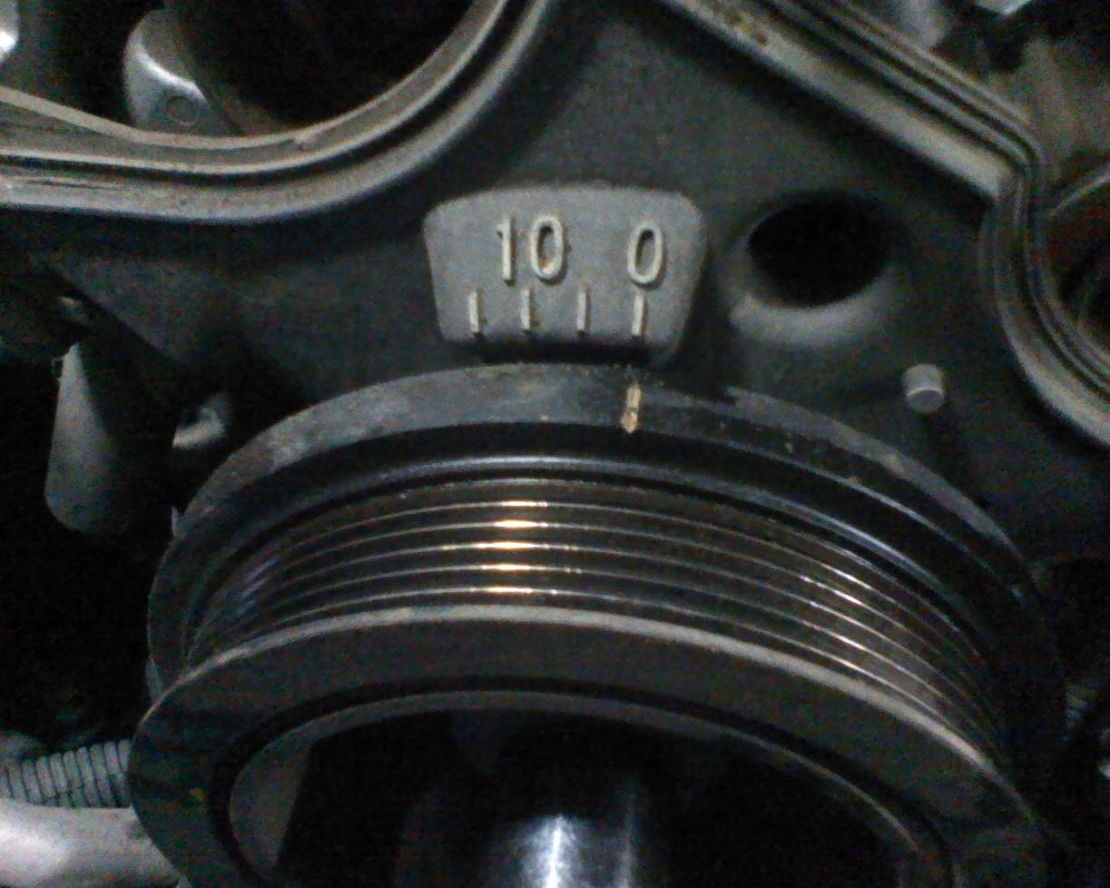

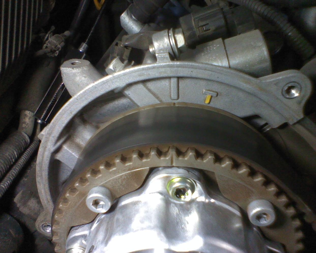

The white dot on the plastic cover conveniently lines up with the little bump on the engine block, that's what I was pointing out in the post. So if it's lined up with the white dot it should be at that mark.
just to add in some more confusion...
im doing another belt on an 08 today.
when the dimple is lined up to the crank pulley, the cams are lined up with the LINES, not the T, and the crank is on 0*, NOT on the dot. the dimple and dot do not line up..
this engine lines up identical to my 06. though it does not match any literature I have found. none of it makes any sense..
That's how it should be. The "|" is top dead center or 0 degrees. The "T" and the dot next to the crank pulley are the timing belt service position. So I guess the dimple and dot on the crank timing gear are 0 degrees.
I wasn't really able to see the dot near the crank gear (your last photo) since I couldn't get my head there, but I made my own mark on the front on the same tooth as the dimple, and I made sure everything matched the belt I took off.

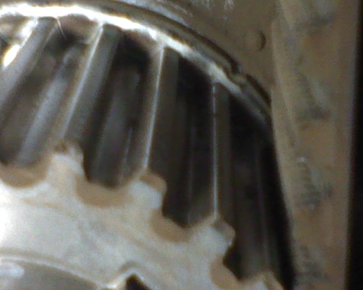

oh yes, im aware. I wasn't debating that. just addressing the fact, that the dot doesn't in fact match up with the lower dimple.

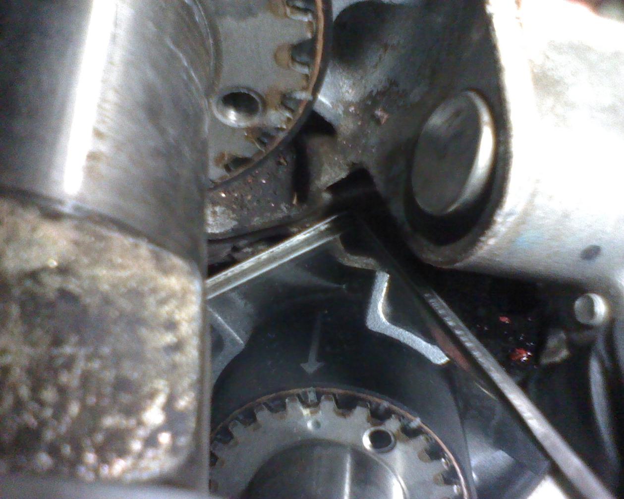

another thing I discovered on this job, the marks on the belt. previously, I have never used them. but this time I decided I would, and see wtf.
oddly enough, the crank mark on the belt doesn't line up with the above pictured dimple. there is yet ANOTHER timing mark on the crank sprocket that it lines up with. crazy. wtf was Toyota doing when they set this system up?
I had to use a mirror to see it, as its on the bottom.
