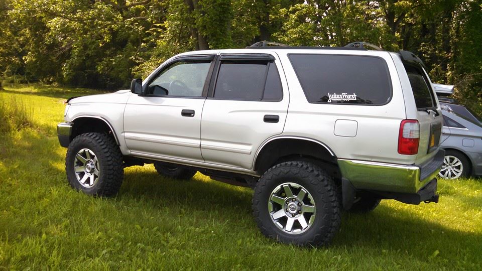

Sorry I'm late to the party! 3RZ FTW!!!!
