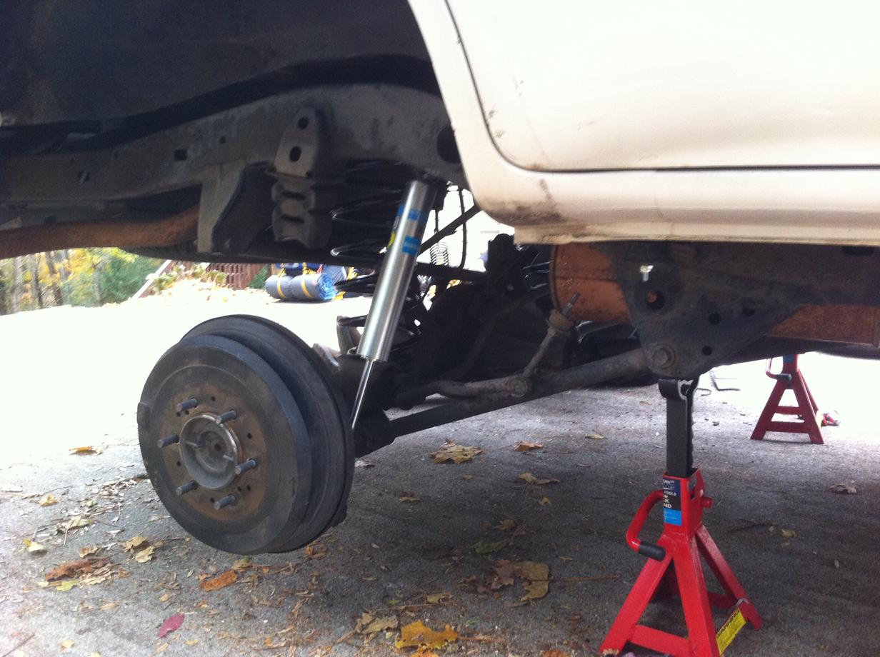

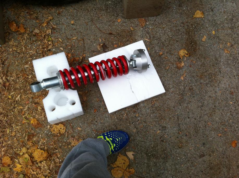

I'm updating my suspension setup since it is the original with almost 200k miles on it. After researching i think im going to go with Billy 5100 and OME 906's for the rear. It seems like this would be a good setup according to the site, but wanted to see if anyone here with the 3rz has done this, and see if there is any difference.
Also, What would be a good front setup to pair with this?
Thanks :llama:
I have that setup right now. Rides well but it's a little light for my personal amount of metal I have attached. If you are currently stock and plan to be so it is not a bad setup. I have a solid rear shelf, full length rack up and a custom swingout. This summer....hopefully....I will be doing a rear bumper. I'm actually looking to do 891 springs soon but probably not soon enough for you.
I have 99 coils paired with Billy 5100 and I think they ride great on the second perch. I think it's around 2" of lift there.

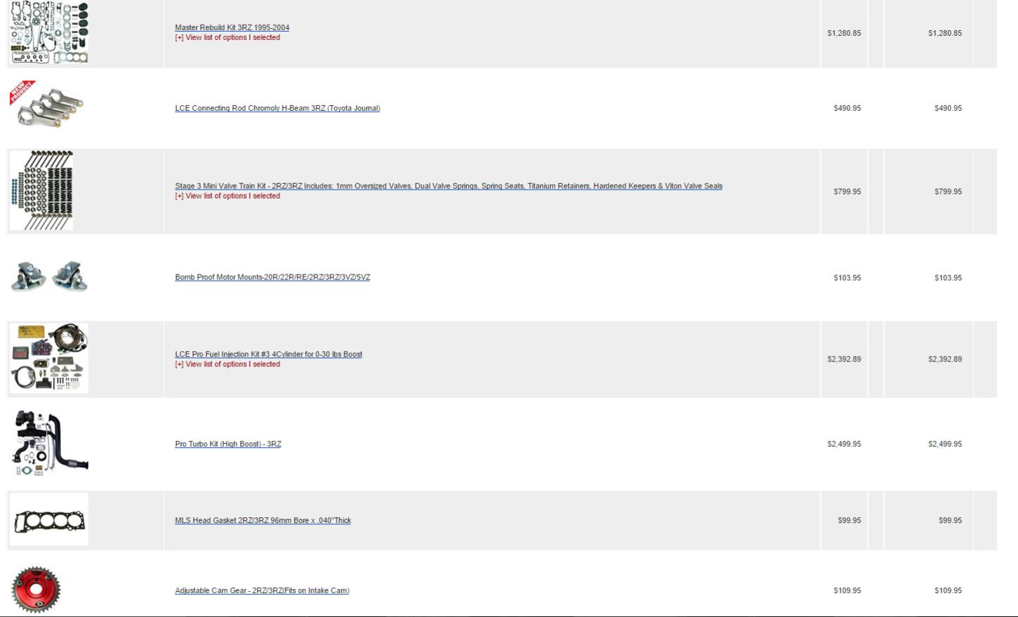

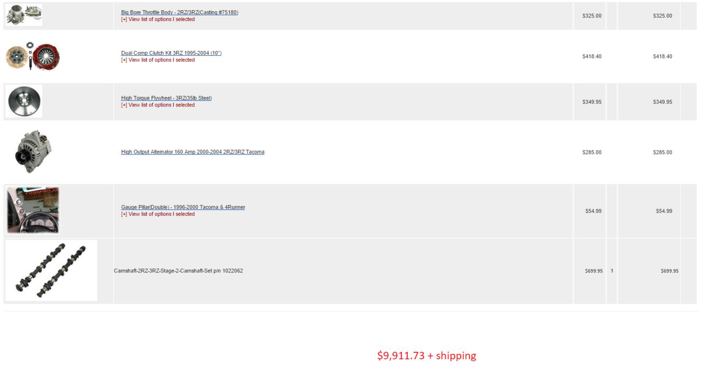

In a short while probably today, I will be posting a parts list in chronological order of what the plans are as of right now. So far, I have spent hours on the phone with Mitchell from Marlin Crawler, to talk gear ratios and case set ups.
PLANS ARE:
- 2TR-FE Bellhousing out of a 05+ Tacoma 2.7l Access Cab
- R150F Transmission with Marlin Crawler T-Case Adapter to run their Gear Driven Dual T-Case.
*Reason for running R150F* - The R150F is a direct bolt-on to the 2TR-FE bellhousing platform, input shaft length will be the correct size without modification. HOWEVER, the R150f came in the 3.0 V6 as well and in that case I would need to trim the bellhousing to match the input shaft length. So, less Fab = more OEM in my opinion and more security for my own conscience.
-Dual Case will be the 2.28:1 because I want close to OEM gearing and 4.70:1 would be a bit too low for something DD/trail/Overland. In Double Low it will be a 5:1 ratio for technical stuff which is PLENTY low and I can keep near factory gearing in 2wd and around town.
-Running this will allow for me to run the Gear Driven T-Case which is [Passenger Side] Drop, this is important because I can run a Toyota FZJ80 axle up front which again MORE OEM. I will run 4.88 Yukon Grizzly gears in the chunk. It will be a coil bucket system just like what comes in the land cruiser from the factory with a 3-link kit (still juggling with johnny joints vs heims b/c I will be in colorado for the next 5+ years or so and colorado is rude to heims, it would just mean more maintenance.
*Reason for 4.88 Gears*
-I am also acquiring parts for the performance side of things LC Engineering 3rz turbo kit. If you have any insight to add to my cause post up! It will be the LCE high boost not low boost, keep that in mind.
-Turbo means Engine components:
Bottom End, Top End, Rebuild etc.
Stay Tuned for a List!

This is just my .02 but for dd/expedition type rigs reliability is more important than power. I vote for the high boost supercharger and a pair of cams. Stage 1 will be plenty and you will gain considerably all around with the supercharger. Turbos have a narrow band of power, it comes on suddenly, and it's more stressful on the block.
What size tires will you run? I have a 4.30 in mine right now with a 31" tire and it is too low for that size. I believe for a 255/85 I will just need 4.56 and if I were to go 35" or 37" then you would want the 4.88.
I've dd a 34" tire and it grew tiresome lol. It's a longer way up than I had anticipated.
I would go ahead with the 4.7 gearing in one of the cases. You will retain the stock 4wd gearing since you will have a dual case, plus you will have the 4.7, then if you're really somewhere where walking is better than riding but you want your truck to follow I believe it's 13 or 14 to 1 in low low.
I completely here where you are coming from and I agree with you. However, one thing is that I will be including adjustable cam gears, a full valve kit, MLS Head gasket (Multi layer shim), as well as some other engine supporting mods, this won't be as simple as bolt on and go. There is an extensive engine supporting mod list I've made with the help of Brad over at LCE. These mods could allow me to adjust the boost from 10-12lbs around town to 18-20lbs on the trails, dunes, etc. (wherever there is dirt).Parts list 1.jpg
Essentially I will have full tune-ability with all of the mods, most helpful will be the stand alone system. Parts list 2.jpg
*Note* Not mommy and daddy's money that will make this happen I have worked consistently for 5 years building and acquiring as I go.
My plans for reliability will depend on auctioning with a dealers license to acquire an FZJ 80 or FJ 80 that is wrecked to part out and keep front suspension mounts, links, components, axle (maybe rear axle).
Opinion about SAS with the FZJ 80 axle?
RHD axle wont be a problem because the R150F>2TR-FE Bell Housing>T-case adapter>Gear driven case is in fact RHD. I will be running 35's at the largest as of right now, I have 33's and 4.10 gearing, I have noticed a bit of a power loss from the 33's but if you look at the factory spec it is a 31 tire with 4.10 gearing, I think Toyota knows their stuff because they nailed it on the head when they geared and spec'd the 4Runner.
-My gearing will be 4.88, with 2.28:1 double low again, it will be plenty low to creepy crawl, I would be in 4th and 5th if i had the 4.70:1 Duals running that setup.
