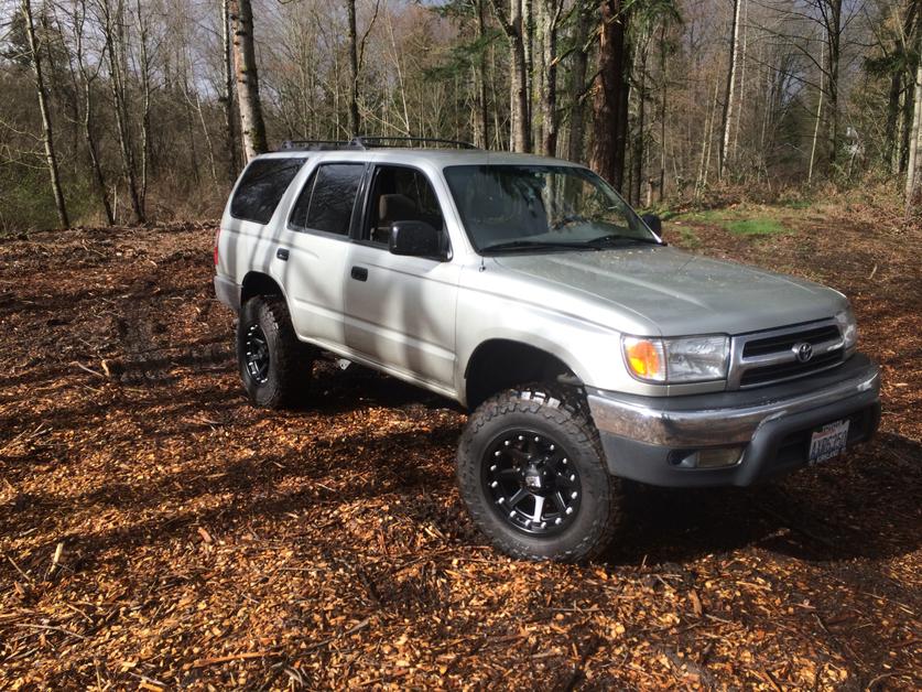

3RZ, 5speed, 4x4, 3 inch lift, Deck plate mod, DVD Kenwood, Bilstein's, 32's Toyo MT'S. 2nd owner with 89k.

How do you like the DT's?? Was it an easy fit ?? Im trying to decide between that and LCE? Which would you recommend?
I've had the DT in for 2 years now & no issues. I never researched the LCE because I didn't hear of it until after I bought the DT. I am a regular customer of LCE now & highly recommend them, great customer service.
