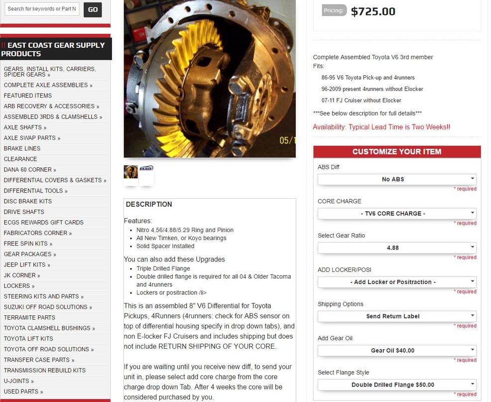

Built diffs for the rear are easy to find in the PNW any 8" Toyota rear is a direct bolt in, mine was 300 with Yukon 4.88s installed in great shape. Then you drop the front yourself, buy some gears and have them installed and you should be around 5-700 on the front, so 800 to 1K.
I've heard 2700 from people getting all brand new with arb lockers front and rear, so I'd at least get more quotes.
I agree with freshseabass. This is what I did. I'm no mechanic and was able install the rear (3rd member) by myself and the front clamshell with the help of my 20 yr old son. Simple and straight forward.
I highly recommend ECGS! Best part about going this was is you get a 5 year warranty and you have the option to add a locker. Which I also highly recommend.

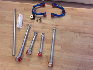

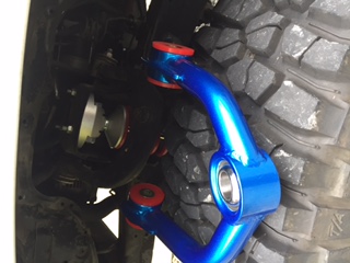

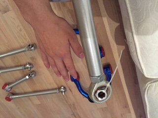

UPDATE:
Arrived last week with some new Tails and making some preparations to install as long as everything checks out with bushing/sleeve spacing, re-greasing heims, etc.
These bad boys are BEEFY :reddance:
Pretty stoked about this, I just want to get to driving it around and notice the difference. Eventually I will be upgrading to FK Heim Joints as well as slightly nicer zerk fittings. Stay tuned on here! Will update during/after install. :zoom:
