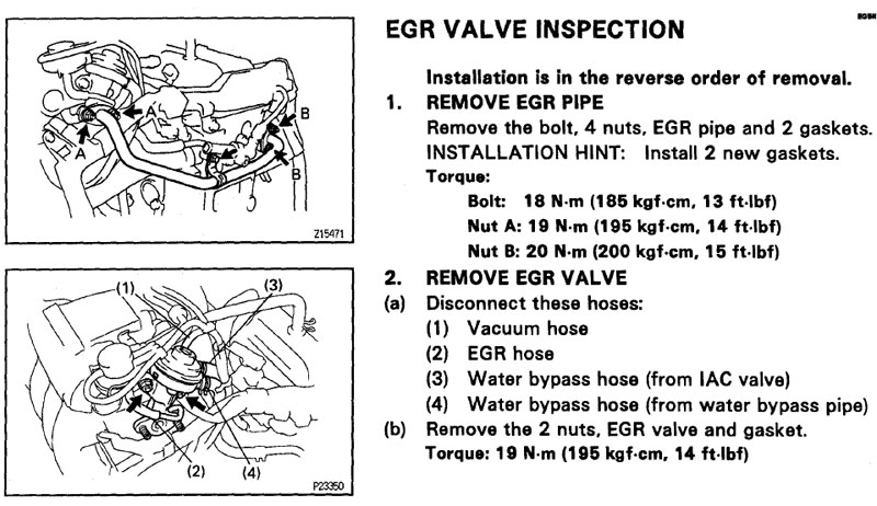

The EGR pipe clean it and the main part of EGR clean it ,but a spray cleaner at autoOne.
Here is the instructions.
Also, clean the throttle body, buy these parts.
If you go to the dealer they will rob you. I went there last week and I feel I got rob. I invest my truck on Toyota dealership almost $5,000.00 I was lazy but it's time to work using my hands.
Buy a new EGR or clean the existing one? I would be more than happy to clean the current one as opposed to going to get it done at the stealership. Also, had any experience with TB spacer? I know on n/a engines it doesn't really do anything for us but some people seem to have different opinions.
You have also the option to buy new EGR but I rather to clean main EGR/ pipe . But replace these parts I tell you.

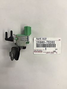

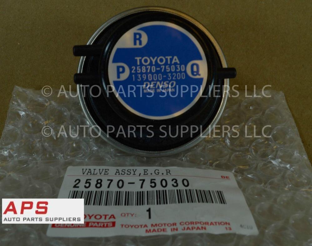

Here is the parts to look and recognized and the 3rd part is a gasket by 2227175020
