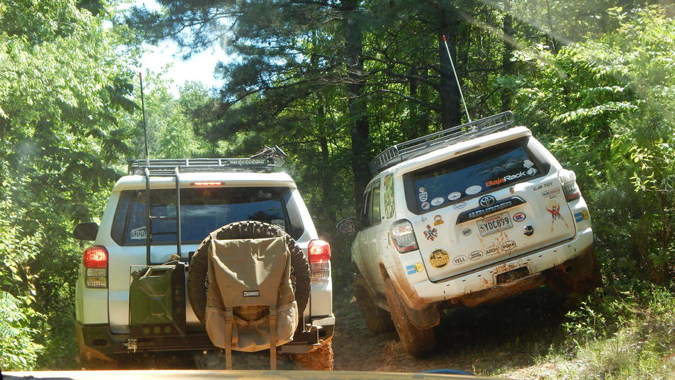

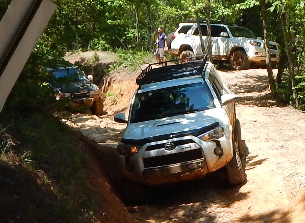

Photo courtesy of [MENTION=105021]thelouv[/MENTION]. Who I didn't even know I was talking to at the time because he was disguised as a Jeep driver... :confused:
I could have bypassed this hole on the left, but NOOOOOOO, I was too cocky and knew the 4R would just roll right through it. Little did I know the clay was too slick for the fronts to get a bite to pull up out of it to the side, and the tree out of picture to the right wouldn't allow a straight run. To its credit the White Whale did back right out, but this little hole was my humility check for the day. You can't see me in the vehicle because I'm hiding under the dash hoping nobody will notice us....... :redface:

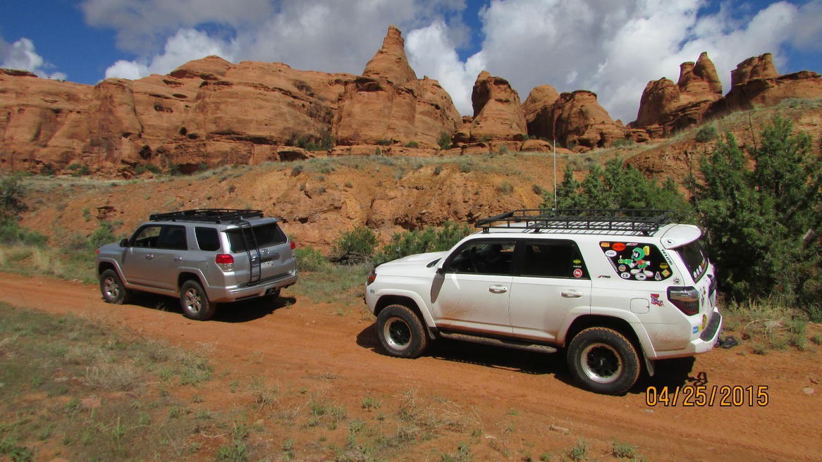

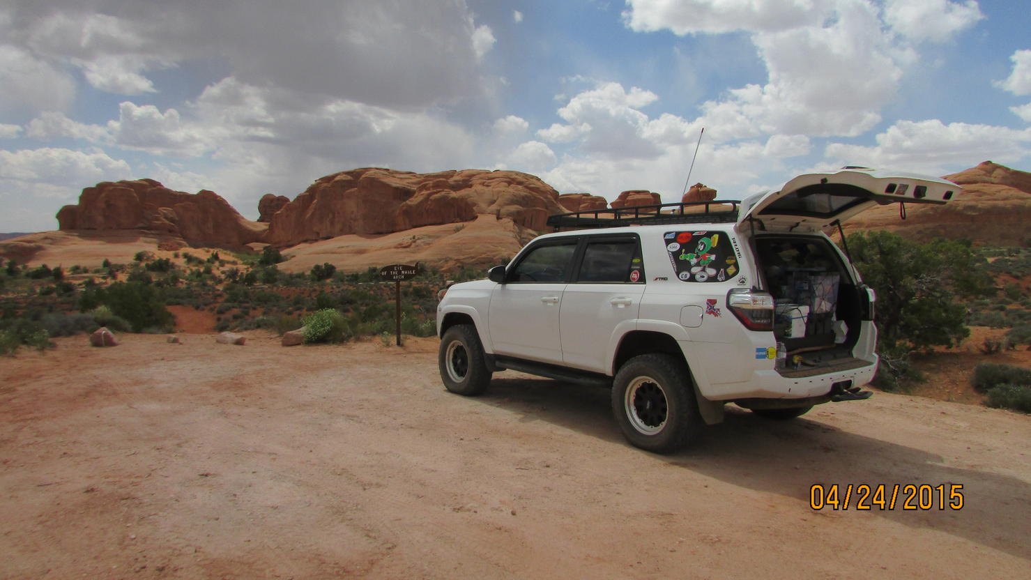

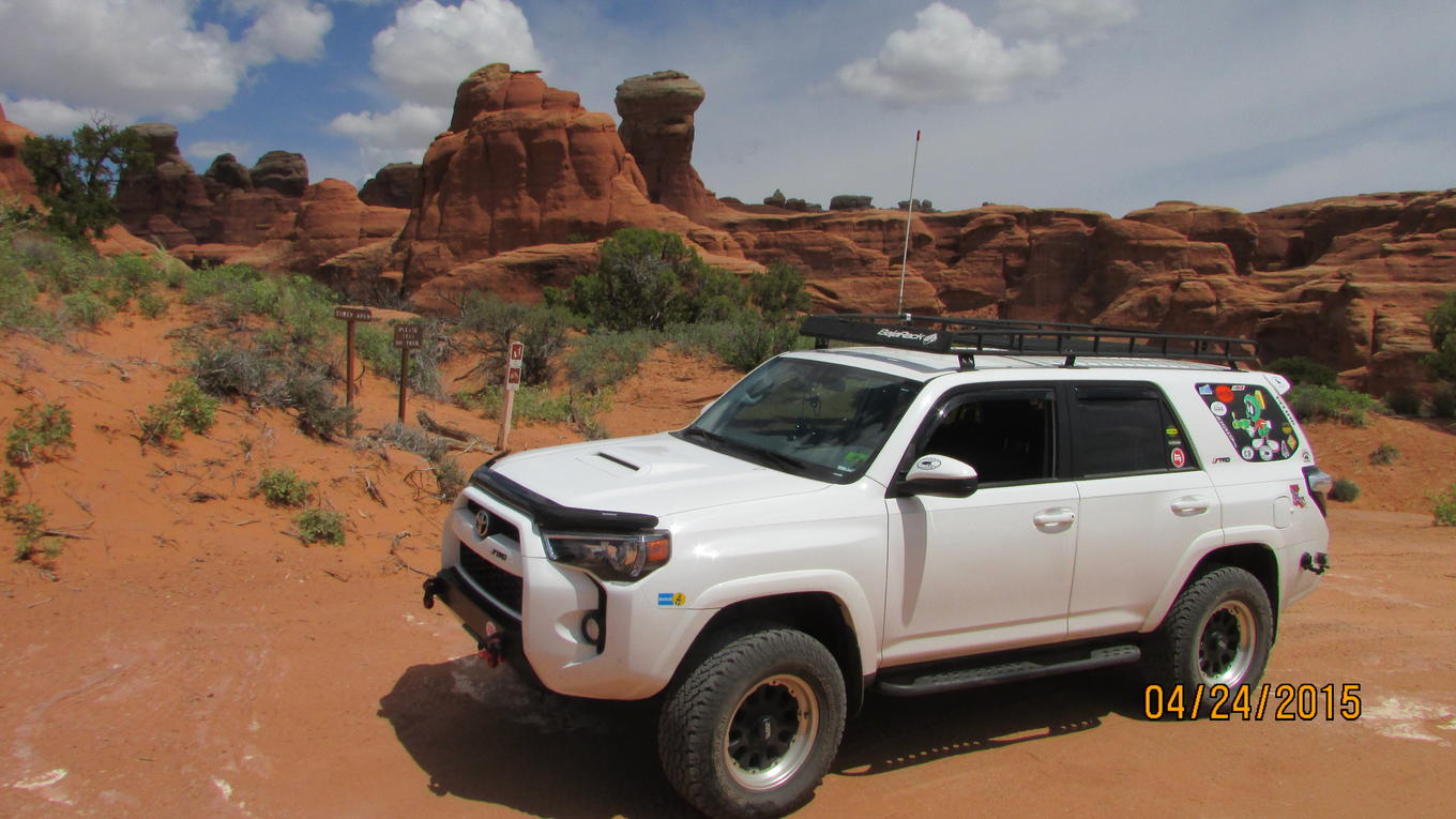

Moab, Ut.

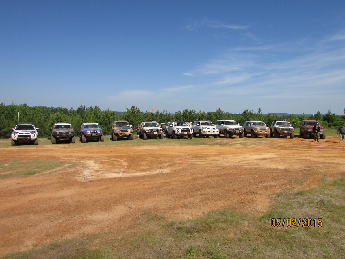

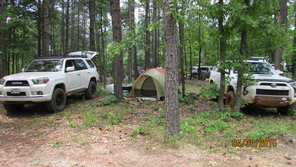

Lone Star Jamboree 2015.

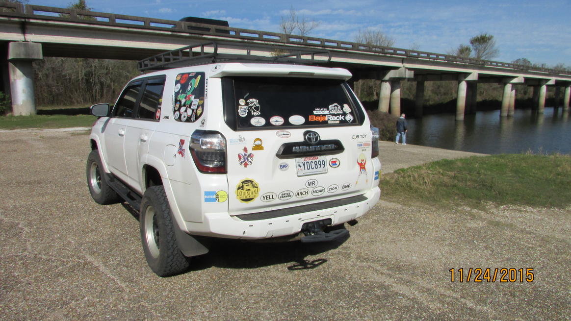

On the Atchafalaya basin in S Louisiana on Tuesday. No new steeckers since May. And no wheeling stickers.

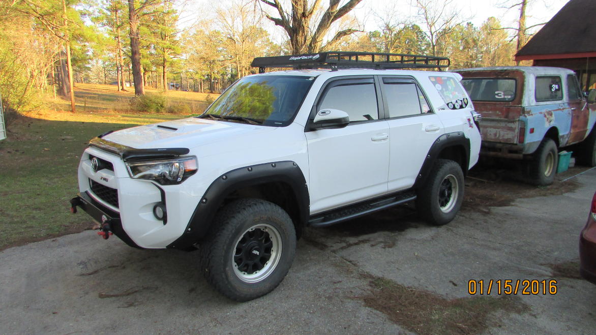

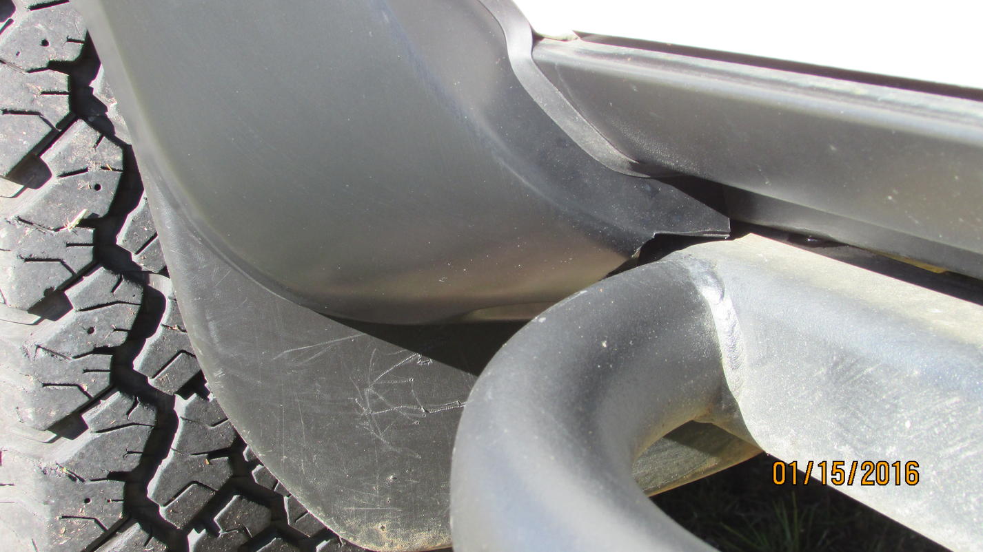

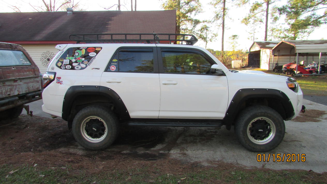

Got my Bushwacker Pocket Flares installed today. Took me about 2 hours start to finish, not counting washing it down to the OMG White and a couple smoke breaks. I also had to trim a 1 1/4" x 1 1/4" piece out of the front flares to fit over the square tube of the Shrockworks sliders. Knocked right out with a Dremel. Sorry about the pics. I keep forgetting OMG White and clear sunny skies do not make for good pictures!!!

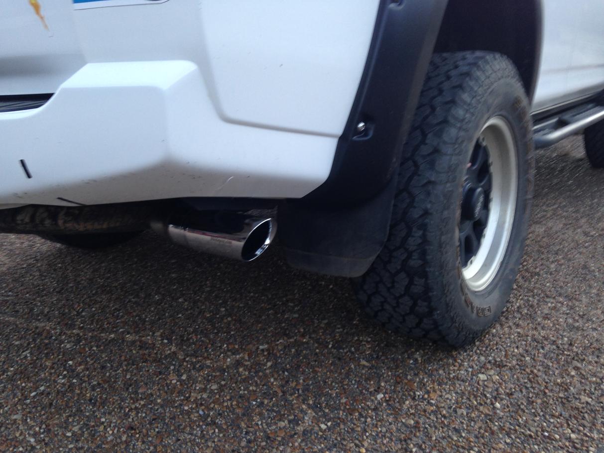

Got the Magnaflow 15584 exhaust kit (3" side exit) installed today. Search indicates it is for 09-11 4Runner? 12-14 is a 15145 kit (2 1/2" rear exit) but otherwise I can't see a difference besides the straight vs side and 2 1/2" vs 3". Time will tell...... :confused:

Tires look smaller with those fender flares now, time to upsize! :pop2:
