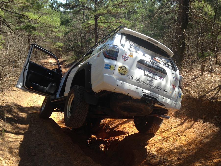

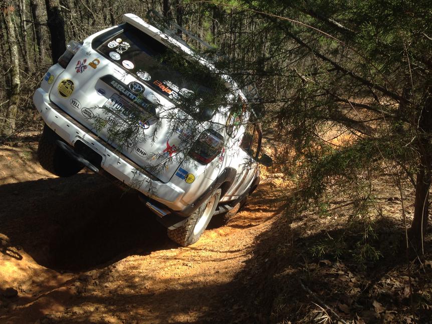

Who put that hole there!!!??? I wish I'd thought to get a side shot. It was already pointing pretty hard downhill when it went in that hole. I had to use hands on both door frames to get out for the pictures. :wow:

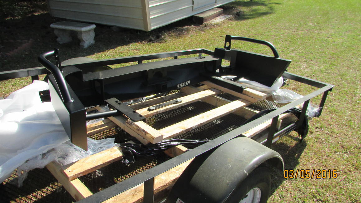

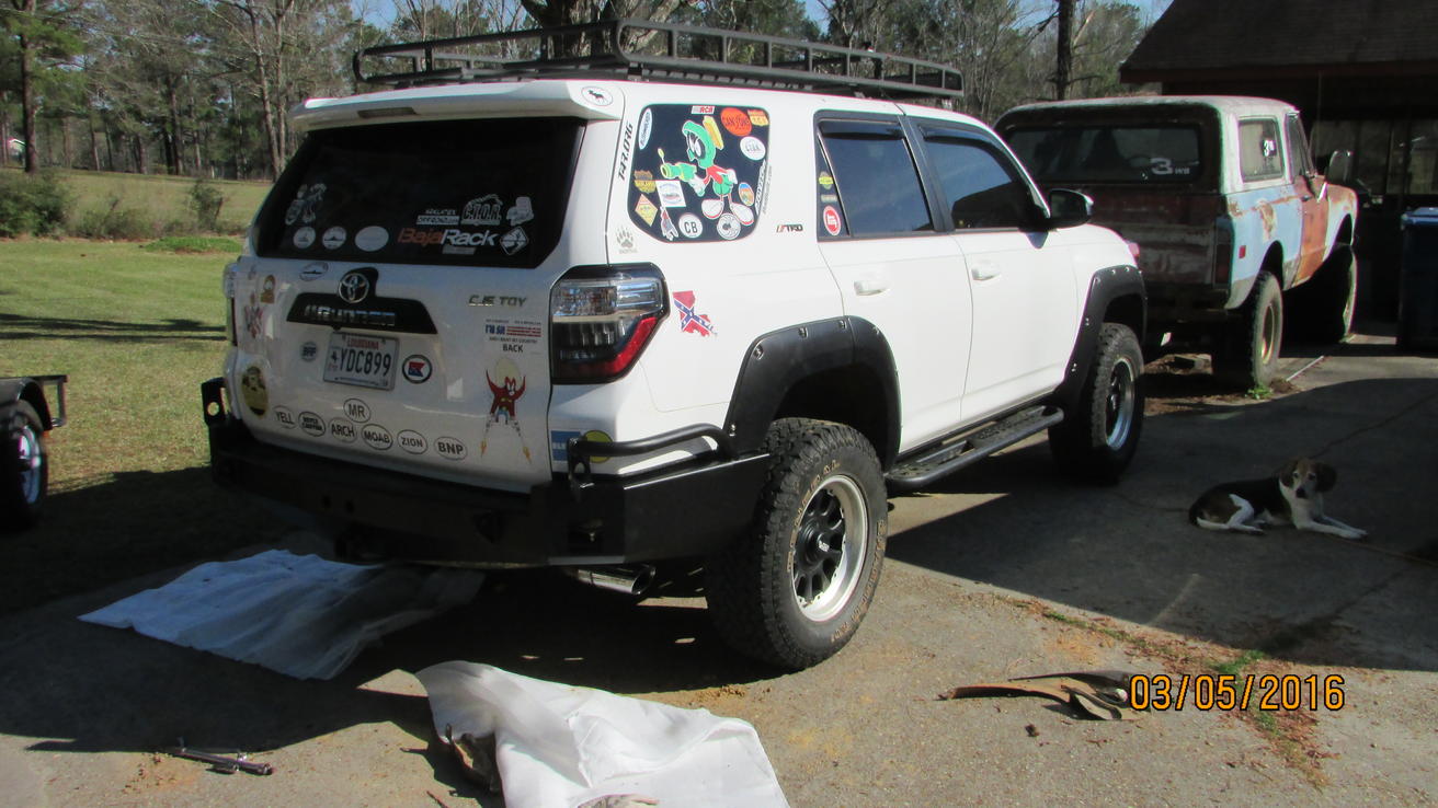

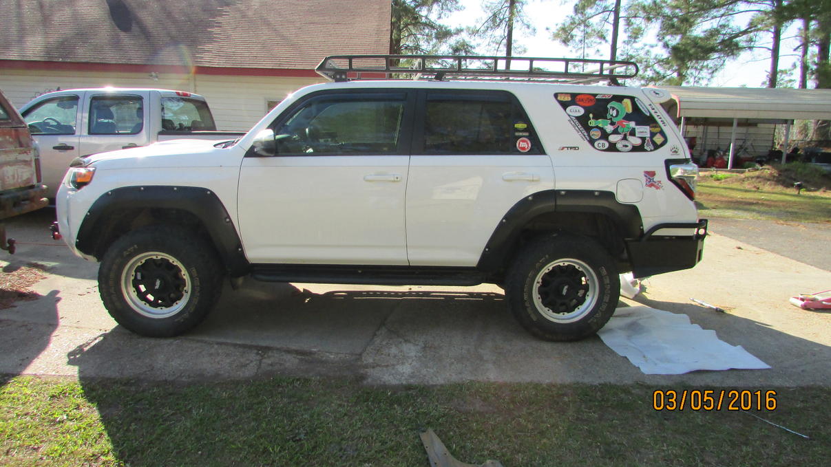

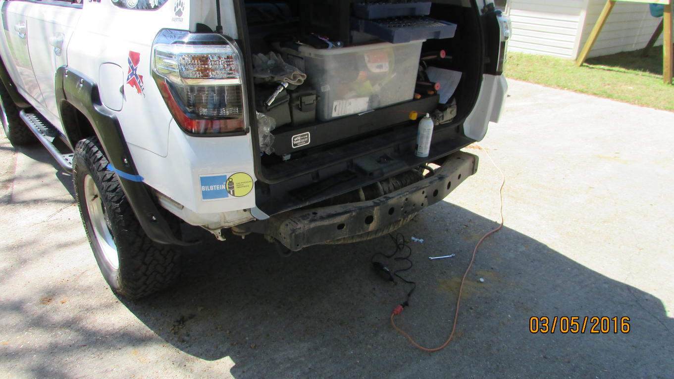

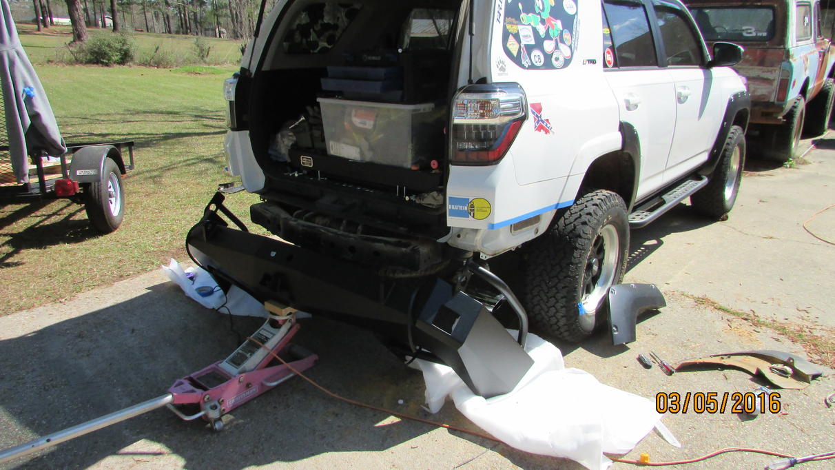

Installed my CBI bumper today. It took about 4 hours start to finish. I did all of the removal and cutting before I called a friend to help lift and fit the bumper. One quick final trim on the passenger side and it slid right in. There were zero issues with clearance on the side exiting Magnaflow exhaust. The rear end only settled about 1/4" so far. Test drive and measure later. Daddy needs a hot soak. :crutch::bathbaby:
