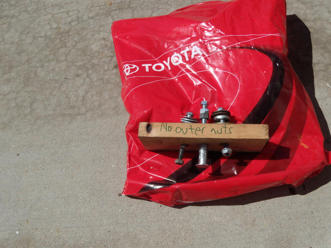

Wish I had seen this thread earlier. We struggled mightily with our 89 MR2 crankshaft pulley bolt and then just after that- the pulley itself.
I had a feeling after we built a custom tool ourselves (pictured) that a steering wheel puller would accomplish the pulley removal. Thanks for the confirm.
