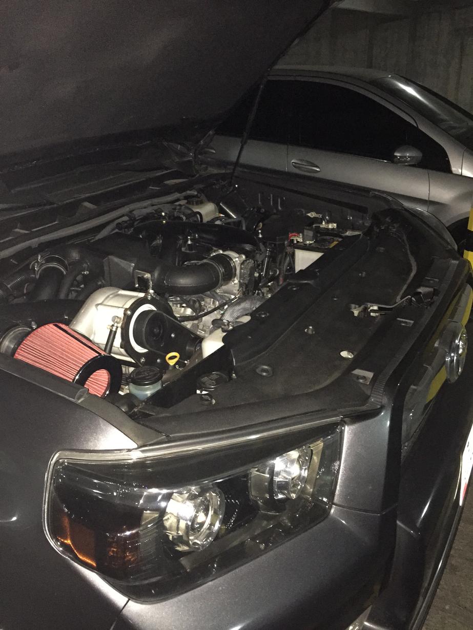

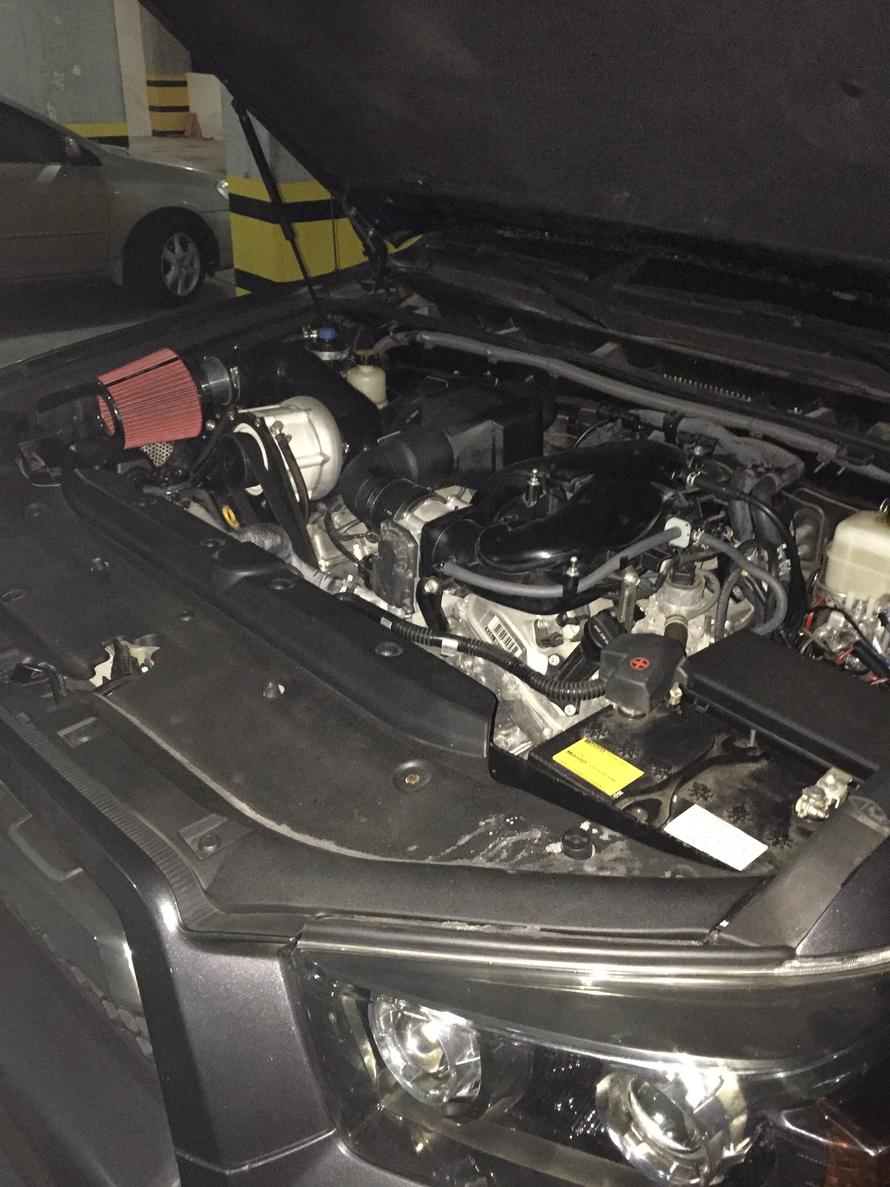

So... wouldn't you want a Twin-Scroll set-up like the TRD/Eaton vs. the Centrifugal Set-up pictured above? I mean I understand the Centrifugal units are somewhat customizable and more affordable, but I have always read the Twin-Scrolls to be more efficient/powerful.
Not really. The positive displacement units do tend to make boost at lower RPM, but the efficiency usually drops off pretty quickly. They can also be decent, but the centrifugal designs almost always have more HP potential. A big factor is that they can use traditional air to air style inter coolers. Postive displacement units have a lot of issues with heat soak.
The downside to the centrifugal is that they often require more RPM to make boost, but I never found it to be a problem. I have never had one on anything but a V8, so not sure how it would feel on the 1grfe. I'm sure it would feel good with the right pulley and head unit. Some do make more noise also. Often a loud whistle at low rpm.
