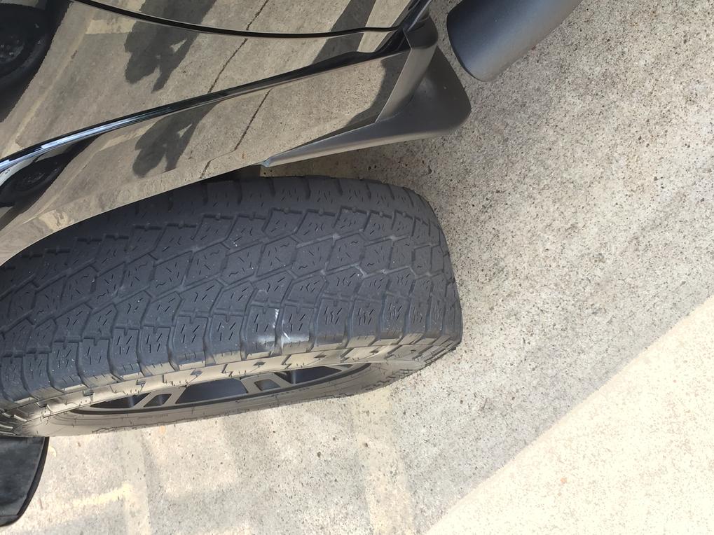

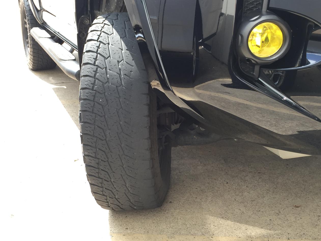

Has anybody had any weird wear patterns on their tires (one or more)?
I went for my regular service interval (at 25,000) and told I needed a 4Wheel Alignment. I thought this was odd, as I've done nothing after market, and the only off-roading I've done is an occasional dirt/gravel trail...no rock crawling fun. My passenger side is balding on the inside, and every other tire is even (mostly, though wear seems excessive for 50,000 mile warranty tires).
Photos with the wear are from front (can see fog light) and one without the foglight is the driver side taken from the back of the tire.

You sir have a camber problem on that side. You need a front end alignment. Potholes and curbs, while not as damaging as in a regular CUV or car, can still knock the 4Runner out of alignment. Do you not routinely check your tires for uneven wear? To get wear that bad usually means it has been out of alignment for some time. You now need a new tire. I check my tires every time I fill up with gas and I put 30K/yr on it. Just a quick visual check to make sure I don't see what yours looks like.

Then you need to go back and re read those threads. The 4Runner, regardless of trim, is no more susceptible to alignment issues that any other vehicle. Actually, it is stronger than many but again, a hard pothole or curb hit will knock it out of alignment.
That is more of a TOE problem than a CAMBER problem.
That tire is not driving straight, most likely toed in towards the center of the truck.
I would try to play dumb and complain about it to try and get a new tire(s) for free but as others have stated - it has probably been wearing like that for quite a while and they probably wont help you out much.
If you're doing toyota service, that should have been rotated and noticed long ago.
If you're not doing toyota service, I might suggest rotating your tires much more often. I like pricey tires, so I do mine every oil change.
Should drive a lot better once you get that corrected!

I honestly didn't feel anything, UNTIL they rotated my tires at 25k...
I got on the highway and she started to wander all over the place, like, almost not paying attention I could have drifted into the leftmost next lane into another car. I called a gal I work with and told her "If I die, check my wheels!" She told me to go back and have it rechecked, but then it seemed to go away. It was as if one side of my wheels weren't tightened down...OR I had pizza cutter wheels on one side. But like I said, it went away after driving several more miles.

I had it in the dealership EVERY service interval. Toyota care. Tires had been rotated several times, with no know uneven wear until now.
(I am coming up on 30,000...so I was checking over everything before I take it in)
That's the thing, none of the other tires are worn like this. I am taking it in, telling them it is going to need something adjusted, and oh, BTW, I need new tires on the 50,000 mile warranty. There's WAY I'd get another 20,000 miles out of these. They are ALL worn equally like the "good side" of the passenger front that's giving me problems.

Camber or toe adjustment is individual per each front wheel. One side is way out and the other side looks to be OK. Again, since you don't take it off road you probably hit a hole or curb and knocked one side out. It happens. The tires will be pro rated if they give you anything for it.
10K is fine for rotation but you have to inspect them every few thousand miles between rotations.
I have seen tires wear out on one side in few thousand miles if they are out.
Yeah, it went in every 5,000...and each time they told me they were rotating the tires. I should pay closer attention, but that Toyotacare makes it easy to drive in, have a coffee, then drive out and assume everything is on the up and up.
