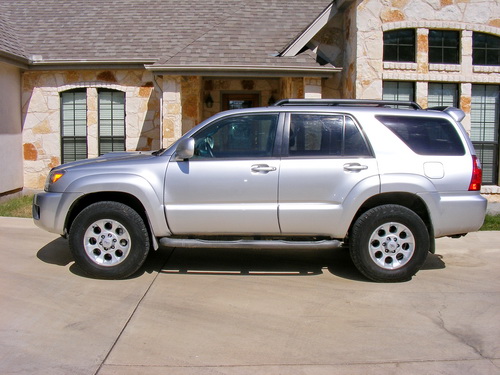

Here's a pic from yesterday.

Just installed 5100's at .85 setting with FJ Springs all around
Before:
L. Front - 33 1/2
R. Front - 33 1/2
L. Rear - 35 1/4
R. Rear - 35 3/4
After: These are taken with a full tank of gas.
L. Front - 35
R. Front - 35
L. Rear - 36
R. Rear - 36 1/2
I also put on 2010 Trail Edition wheels and Pirelli Scorpion ATR 265/70/17 which add about 1/2 inch in height.
The Trail wheels are each about 1/2 in further offset, so the stance looks great
All in all a noticeable difference in handling and ride, a lot less "floaty".
Before:
L. Front - 33 1/2
R. Front - 33 1/2
L. Rear - 35 1/4
R. Rear - 35 3/4
L. Front - 35
R. Front - 35
L. Rear - 36
R. Rear - 36 1/2
