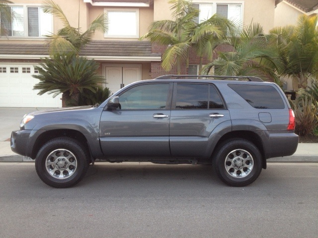

Here's a one of a kind front end only Fj swap...
Its an adjustable Pro Comp drop bracket, modified to fit a fourth gen (05 limited V8). Max allowable lift is seven inches, I currently have it set to just over 4 inches, need alot more work and bigger tires before I can go to 6".
Current wheel well height is 43.5 inches off the ground (sittin on 35's).

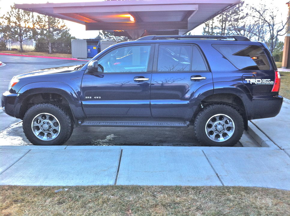

FJ swap complete
2006 2WD FJ Coils and Shocks from a 2008 FJ with off road package. 1/4" toytec spacer. Fj cruiser 17" alloys with 265/70/17 tires
** One note the rear is sagging about an inch because all 5 stock wheels are in the vehicle **

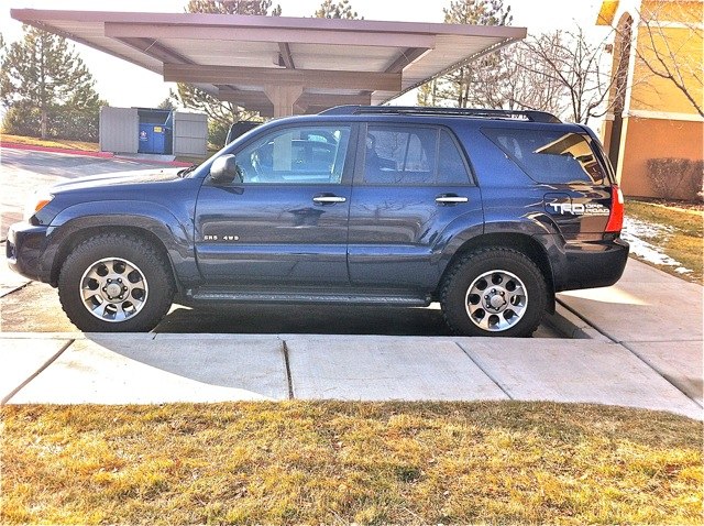

Finally got my lift installed I'm very happy with the way it rides, It's much better. It seems I ended up with more lift than I thought, but I'm really not complaining. I need to fill the tank and put some miles on it let it settle, then I will figure out exactly what I got.:confused: So far it gave me 4" in the Front and 2.5 Back.
Sorry for the lame quality pic's low light with a phone.:redbrick:
FJ coils springs (4)
Bilstein 5100 (4) Front set at 2.5
Daystar 1.5 spacer Rear
BFG Mud T/A 255/75/17, FJ wheels.
