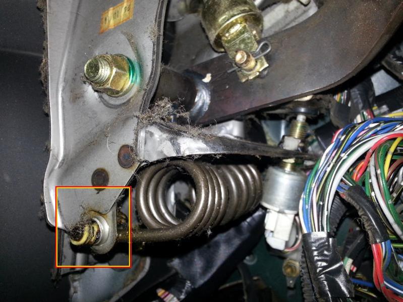

AFTER-THE-FACT-EDIT (to save you time):

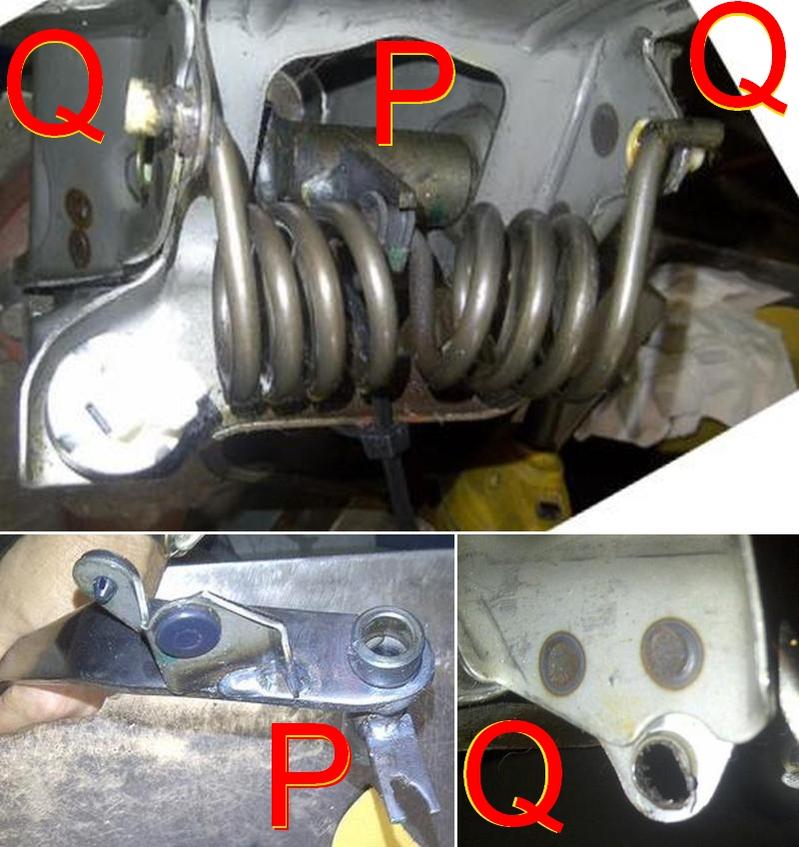

It turned out to be the pedal-return torsion-spring & Q-P-Q bushings (see detail below sufficient to identify and solve the problem if you get here by searching).
RELATED THREADS JUST ON THIS FORUM ALONE:

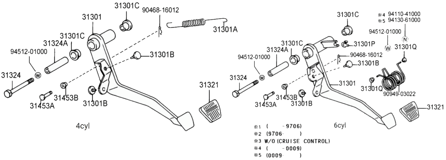

Link to 6cyl pedal assembly:
https://postimg.org/image/eah9p8rsx/
Link to 4cyl pedal assembly:
https://postimg.org/image/5qxvrhjgh/
They use two different types of return spring. The 6cyl assembly bushing always need to be replaced.
Can you point out this white bushing in the 4-cylinder assembly?

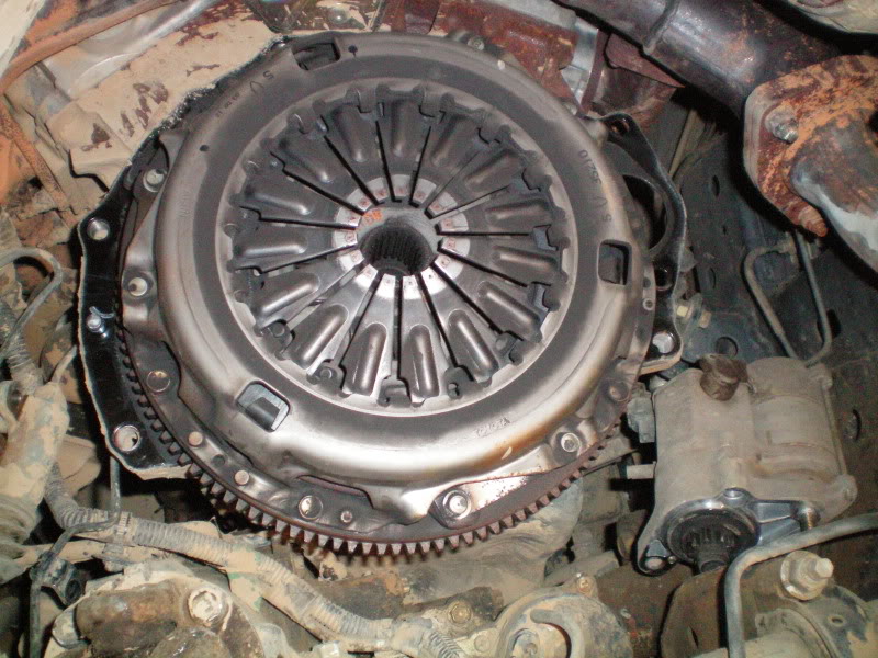

Good job. The DIY's I used a few years ago are mostly dead or at least have lost their pictures. These are still alive:
5VZ Clutch Job - TTORA Forum
Toyota 4Runner Clutch Replacement on 4x4Wire.com
There is a picture and diagram of the "pressure plate" in that thread.
But it makes no sense to remove the transmission until I figure out what's wrong with diagnostics that prove it (or at least make sense).

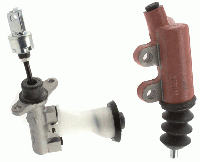

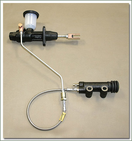

I googled for why there are *two* hydraulic cylinders, where the answer seems to be that the master cylinder's job (of course) is to convert mechanical pressure to hydraulic pressure. Seems to me that should be enough, because all you'd need is a brake-caliper-piston-like "cup" at the other end, but what they use instead of a cup is another cylinder, the slave cylinder, to convert the hydraulic pressure back to mechanical (to force the pressure-plate springs to yield).
Since the hydraulic fluid was definitely murky, maybe a rubber seal has disintegrated in the hydraulics?
Or maybe debris has scratched a piston?
I don't see any leaks, and the fluid level was high, so, I don't think things are leaking "out" but fluid could be leaking past the pistons, especially overnight.
In looking up how best to test that both the slave cylinder & master cylinder are actually working properly, I found this thread which suggests Aisin as the OEM brand for both.
http://www.toyota-4runner.org/3rd-g...ng-non-oem-clutch-master-slave-cylinders.html

If the clutch is on the floor, and there is tension between the fork lever and the slave piston, the issue is between the slave and the pedal.
Since diagnostics are what I'm asking for, I love this response since it gives me an idea HOW to test to see where the problem lies.
If the fork lever is only lightly under tension, or not at all, then the issue is inside the bell, and it's time to yank the trans.
Basically, the diagnostics you suggest make sense in that I BREAK the system in half at the slave cylinder, and then I test which half has lack of tension.

https://youtu.be/WoM9_30XdyQ?t=83way:

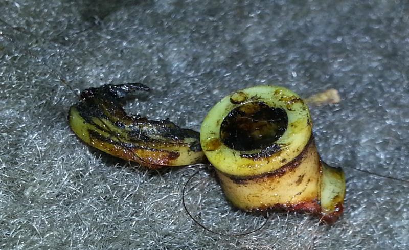

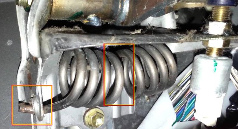

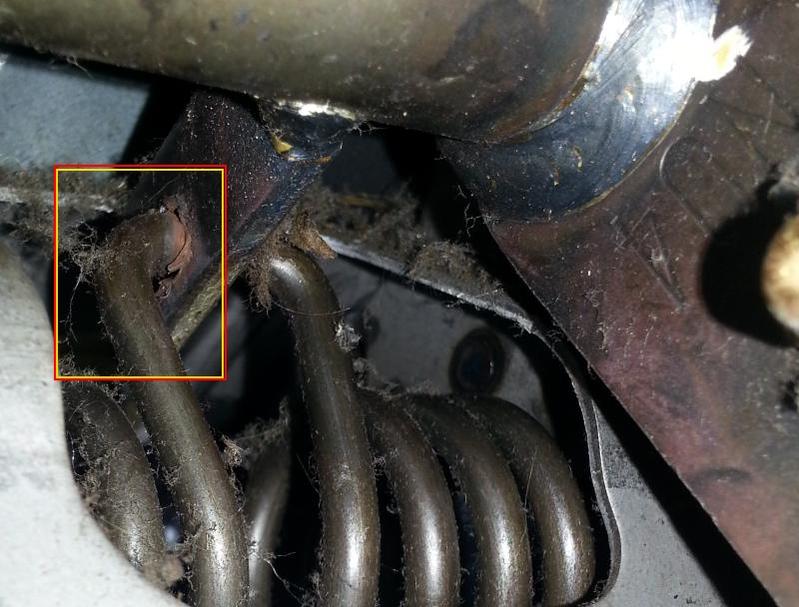

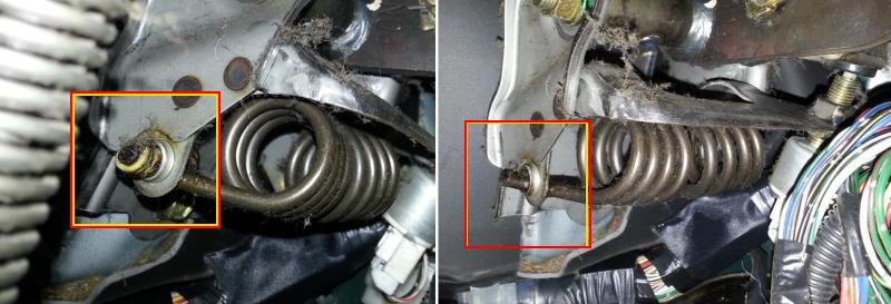

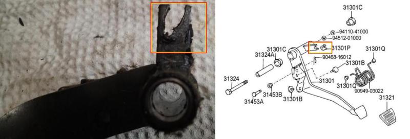

Actually, I only had a few minutes with the 4runner until now, but since I traded cars with the owner this afternoon, I have more time to explore all the great suggestions.
To that end, I looked under the dash for a good look for the first time tonight.
My first comment is that the "mechanical" part of that pedal assembly isn't as straightforward as a simple lever. There is a "double-coil" horseshoe spring, and a bushing on each end, and a bunch of other extensions and switches, but I can't tell exactly how it works yet (partly due to the fact that I'm apparently far bigger upside down than the space Toyota alotted to me down there).
Particularly, I can't see why a broken spring bushing alone would have any effect on the pedal not lifting up the last inch.
However, I did find this broken round white spring-end "bushing", about 1/4 inch ID and about 3/8" od (roughly eyeballing it), which was on the end of the thick double-coil horseshoe shaped pedal return spring.
Do you think this little tiny plastic bushing can have this much effect?

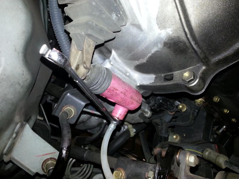

I did take a long hard look at the slave cylinder, which does not appear to be leaking anywhere (and remembering that the clutch fluid was dirty and full when I first opened it up).
Since the clutch fluid was dirty, I borrowed the owner's kid, jacked up the 4Runner, and with a 10mm flare-nut wrench, we bled the clutch more fully (the morning bleed was cursory).
Later, when I took it for a 1/4 mile test ride, it *seemed* like it was shifting better, but that's probably the same effect as when I wax my car and change the oil, I feel in my buttmeter an instant extra 10HP.

I went back and looked at my thread and I ended up replacing my master cylinder and slave cylinder along with the pedal stuff. here is the link

the white bushing is part number 31301P where the spring goes into the pedal.
Thank you very much for those photos and for the part number as I didn't even look at the location you showed, so I totally missed where bushing "P" is, since I was looking at bushing "Q".
I created a panorama of your photo with the diagram.
Is the boxed-in area the location you suggest I look at closely?

That diagnosis test by TheDurk and the bracket photo from Rockdawg84 helped a lot.
Just went back down under, and there is not only no bushing in the "P" position, but the clutch-pedal metal has sharp spurs, as if it was cut by a gouge.
I presume the spring metal is harder and that the clutch pedal metal is softer, but there is no evidence of a white plastic C-shaped "P" bushing!
Given the softer brake pedal metal is galled, what do you think the ramifications are?
Is it difficult to just replace the missing "P" and "Q" white plastic bushings?
Or, is the correct replacement a new pedal (and unknown other associated parts like the spring and the "P" and "Q" bushings)?
