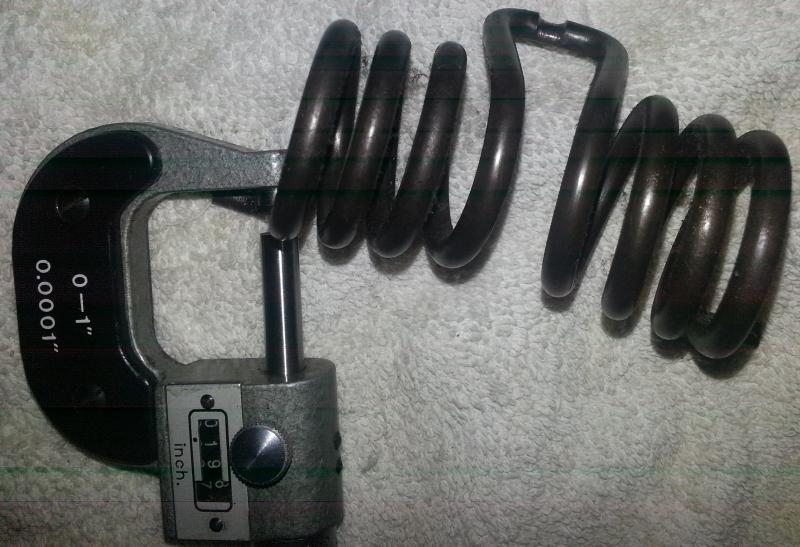

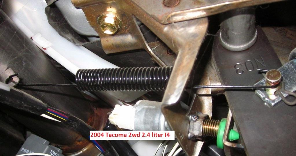

A clutch spring from an 80s 2wd toyota pickup. Pretty much the same set up. Have had it in place for about 3 years. I found it in a junk yard.
I have to agree with you that the clutch spring seems about the right length.
As everyone had said, there are already the two attachment points, one of which is a tab which is apparently snapped onto the dash with a plastic fitting, the other of which is a brass nipple on the clutch pedal lever as shown below.
Slipping the clutch spring onto the tab and nipple was so easy that I was surprised since some had said it was difficult; but it was child's play.

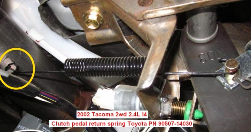

I used a Toyota brake pedal spring. i had an extra one when I did my transmission swap and it is working fine after a couple years.
The brake pedal return spring is appreciably shorter in length than the clutch pedal return spring, being almost exactly one inch shorter, while the diameter is appreciably larger, with the length of the coil section being less drastically different.
I mainly opted for the smaller diameter clutch-pedal return spring because I knew, from research, that there were potentially two contact points, one at the bracket and the other at the P-tab on the clutch pedal.

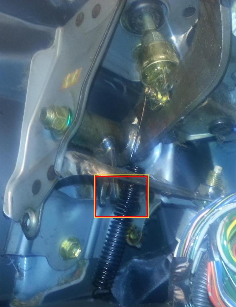

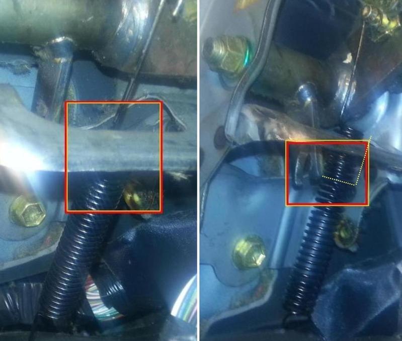

The current setup hits slightly at the P-tab, but not at the bracket, as shown below in the side-by-side comparison, with the pedal extended, and then depressed (left to right).

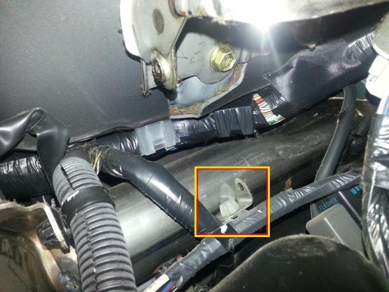

Just for the record, I mounted the SHORT end of the spring to the upper mounting tab, and I put the LONG end of the spring attached to the clutch pedal pivot point.
The 2.075 inches from the coils to the curved end on the clutch pedal was enough, apparently, to keep the coils themselves from striking the clutch pedal bracket when the clutch pedal was depressed (whereas the larger diameter brake spring might have contacted the bracket as others have found).

However, I think this clutch pedal return spring is the WRONG spring for this application, since it does hit the clutch pedal P-mounting tab when the clutch pedal is depressed to the floorboards.
I counted that there were about 10 coils too many (about an inch in length) when the pedal was depressed.
Given that, a BETTER spring geometry would be if the coils were moved down by an inch.
That would give us something like the following:
BETTER Clutch Pedal Return Spring Toyota PN unknown:
  • Length inside hooks unloaded = 5.610"
  • Length of body coils = 1.545"
  • Coil inside diameter = 0.413"
  • Coil outside diameter = 0.637
  • Wire diameter = 0.0555
  • Distance from the last coil to the inside curve of the hook (long end) = 2.075" 3.075"
  • Distance from the last coil to the inside curve of the hook (short end) = 1.960" 0.960"
That is, if we're limited to a spring about five and a half inches in total length, the closer the coil is to the one end, the better.
Said another way, we don't want the coil in the middle - we want it about an inch from the one end and about three inches from the other end.

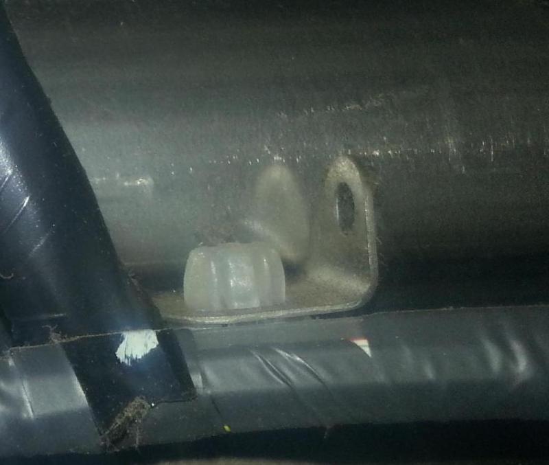

I gave the 4runner back to the owner, who says it feels "different" than before, but, even if I had put the OEM torsion spring & bushings back, it would have felt different, simply because that torsion spring had been gouging into the clutch pedal P-tab for a long time.
How long do you think it was chafing metal on metal?
I'd say years.
And, do you know if that half-sized rubber insert is directional?
What end of the spring is the insert supposed to go into?

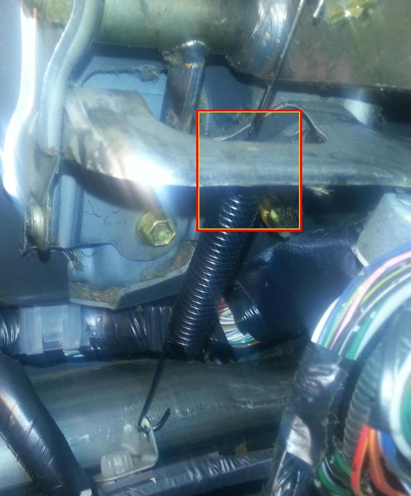

As for the spring, the owner didn't notice, but I don't like that the P-tab touches the spring, but it's minor enough that I'll let it slide for now - but - in the future, I recommend a similarly sized about 5 inch spring but which has a 3 inch long end.
You don't want it as wide as the brake pedal return spring since it will then hit the clutch pedal bracket, so, you kind of want a similar diameter as the clutch-pedal return spring - but with the main change being a 3-inch long arm.

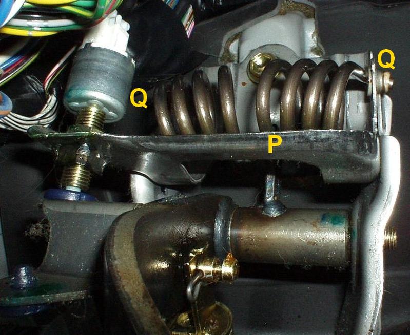

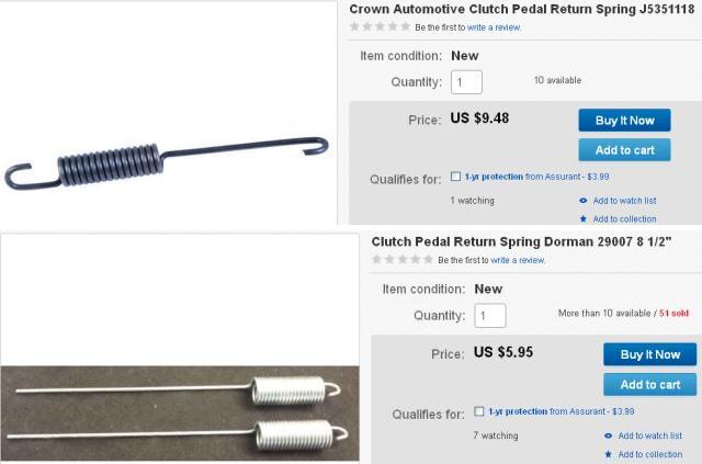

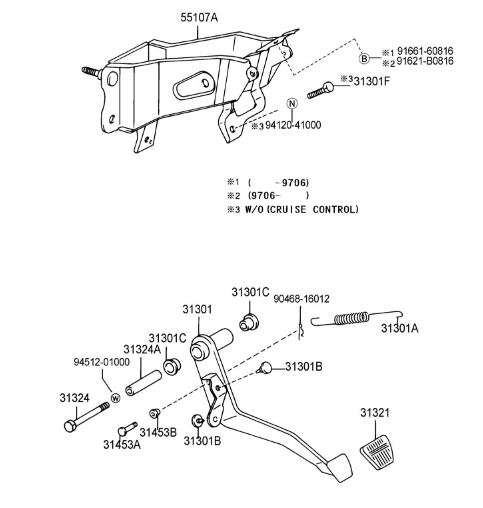

Notice that there are two kinds of long-arm pedal return springs:
a. The type where the arm is already formed
b. The type where you apparently form the arm yourself.
For example:

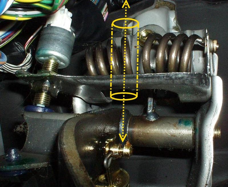

There is a reason behind the fancy Toyota coil spring design.
If you drove the 2 set ups back to back, you would notice that the clutch is much lighter in the original configuration. It is stiffer to push now with the linear spring. Why the difference? Surely not just the little linear spring.
The original spring lifts the pedal up in the pedal up position. But once you push the pedal down past a certain point the spring assists you in pushing the clutch down. This results in a very light clutch feel. I discovered this while bleeding the clutch. The original clutch spring will actually hold the pedal to the floor while you are bleeding the fluid. You have to lift it back up.
So I think it is a clever design. Assists in both directions. The new linear clutch spring will feel stiffer and take a bit of getting used to.
Of course this is just my observation and thoughts. Could be complete crap.

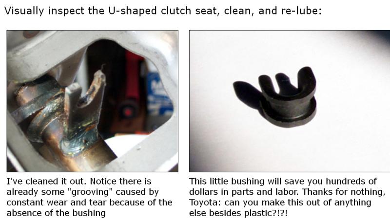

So almost exactly 2 years from restoring my pedal setup to factory with all new stuff. I got in my runner today and pushed the clutch in and got a squeak. Crawled under and my bushing from the center of the torsion springs is gone. but the side bushings seem to be intact. I plan on pulling the pedal assembly and and putting in a nylon bushing. I will take photos and document better this time. Thank you for all the info.

I have installed the #70 hardware store spring on 3 different 4Runners or Tacomas. It's worked well for several years in all cases.
The problem with the #70 spring is that it almost certainly will contact in one or two places.
a. The clutch-pedal bracket
b. The clutch-pedal tab
I agree the touching is a minor problem, but, the springs are cheap, so, all we really need to do is find a good part number that doesn't hit at those two points.
I think the SIZE needed is simply these three rough estimates:
1. About 4-1/2 to about 5 inches long
2. The long end is at least 3 inches long
3. Coil diameter is smaller than a typical Toyota brake-pedal return spring
As to interference with the clutch pedal's tab, I bent it out of the way if the tab was only mildly gouged out by the original spring, or I cut it off if deeply gouged. The clutch pedal is mild steel; I think it could be bent back and re-used if you later wanted to use the original setup.

TI'm not sure there is a perfectly sized nylon bushing available for sale. I purchased two different sizes, picked the one that was the closest fit, and then modified it to work. Here are some suggestions.
1) Pick a nylon bushing with an outer diameter larger than the notch in your clutch fork. This will vary depending on how worn your fork is. The inner diameter should be slightly smaller than the diameter of the spring.
2) Use calipers to measure the diameter of the spring and drill out the inner hole of the bushing to that size.
3) Cut an opening into the bushing so that it "snaps" over the spring.
4) Use a file to cut notches into the sides of the bushing so that it fits into the fork.

To that end, I measured the spring I replaced to be 0.1975 inches thick, which is essentially 5.0 mm, so that's the internal bore needed for all three QPQ bushings.
Now we need the external diameter of the three QPQ nylon bushings, which are probably best measured by the next person who performs an OEM replacement.

Squeaky clutch pedal
Anyone considering replacing the $3 plastic horseshoe is wasting their time IMO. Once the original is gone and the spring starts to eat into the pedal (causing the squeak), the plastic horseshoe insulator no longer fits in the pedal groove as intended. It's made of hard plastic and will break and fall out again before it distorts to fit (like my custom nylon special does).
If you can get tubular (cored) nylon, it should be sized so the ID fits around the spring and the OD drops into the pedal groove - roughly 1/8" wall or less going by memory, except I made mine from larger stock on the lathe spur-o-the-moment-style.
With a razor blade or sharp knife, cut it lengthwise so you can fit it over the spring. I also greased the spring/nylon so the spring slides inside the nylon and the OD of the nylon just crushes into the pedal slot. Be sure to thoroughly debur the spring or it will eat up the new part.
Has anyone since this writeup MEASURED the OEM PQ bushings?
Anyone yet have a good part number for a Toyota clutch-pedal return spring (that has a 3 inch arm and a 1 inch arm and a 1 inch long 1/2 inch wide coil)?
The reason the OEM measurements for the PQ bushings are needed is that the nylon replacements are problematic.
The reason an exact P/N for a suitable spring is because all springs described to date in this forum (as far as I can tell) hit (slightly) in one or two places.

I have the answer to the existence of the seemingly unneeded tab for the upper end of a linear clutch pedal spring. The first photo below is of my 2002 2WD Tacoma with the 2.4 liter engine. (The 2004 annotation in the photo is wrong. Should be 2002. My typo.)
I bought the vehicle new, so I know this isn't a post-factory mod.
The second picture is the parts diagram for that same vehicle.
The metal tube across and behind the dash, to which the small tab is attached, is likely common, at some point during manufacturing, to 4Runners and Tacomas. The 2.4 liter 2RZ engine, which never appears in a 4WD vehicle, has a clutch that will face less load than the 3RZ or the 5VZ engines.
Thus, the clutch cover has weaker springs and thus, no need for fancy engineering tricks to give the clutch pedal a softer feel. Also, Toyota had to figure out ways of keeping the 2WD Tacoma cheaper. That odd spring this thread's been discussing, with bushings and whatever, has to be more expensive to make.
Digression: another way the 2RZ is kept less expensive than the 3RZ is the elimination of the engine's balance shafts.
The part number for that spring in the second picture, item 31301A, is 90507-14030. I don't know its length. It's under $4. Note that the large bracket, too, 55107A, is different from the bracket for the 3RZ and 5VZ clutches.
Could one visit a junkyard, find a 2WD Tacoma, and move its entire clutch pedal assembly to a 4WD Tacoma or 4Runner and then forget about this spring & bushing business forever more? Good question.
So, Toyota has given its blessing to using that tab for a linear clutch spring, and blessed linear clutch springs as well.
Wow. There is so much good information in your post that I would nominate it for one of the best and most informative, since you've addressed more than a few puzzles that the rest of us have just been guessing about!
If you don't mind, I have taken the liberty to update your excellent photo, bearing in mind that it's extremely rare to find a photo of the setup with BOTH ends of the spring shown (the angle has to be just right for your cellphone).
This is good to know, as the Toyota I am working on also is on the first owner, so, in both cases (your Tacoma where it's actually used and my 4Runner, where it's vestigial) the upper tab is a factory installation.
I agree with you. The only viable explanation is that they share a part, and in the case of the 3rd-gen 4Runner, that shared part has this vestigial tab which we make use of to hang a clutch-pedal return spring on.
This is an interesting hypothesis, which is that the Tacoma you have doesn't need the far-more-complex double-coil torsion spring to lighten the load (or, it could be that Toyota figured the Tacoma owner could handle a bit more clutch feel than the 4Runner owner?).
If the Tacoma clutch-plate springs are weaker, this would make sense.
We agree that it's crazy expensive to make the double-coil torsion spring with bracket and bushings and pedal centerpoint than it is to just hook a linear extension spring onto the two tabs, so, Toyota must have had what they felt was a VERY GOOD REASON for all that expense for nothing.
The reason I say it's all that expense for nothing is that most people here (including me) have said they can't tell the difference between the old feel with the torsion spring and the new feel with the linear spring.
I'm sure Toyota had their reasons, but pedal feel doesn't seem to be a biggie if we can't feel the pedal feel being any different. Maybe it IS different though, as buttmeters are highly unreliable after all...
This is GREAT information! Part numbers are everything when we're trying to match geometries. Looking at your photo, the spring seems to be symmetric, which I had not expected, but probably because the bracket is different between the 4Runner and the Tacoma, they get away without the spring hitting in the two spots it normally hits in the 4Runner.
I can't tell but does the PEDAL on the Tacoma also have that middle u-shaped brazed-on tab?
I suspect that, while it would probably work, it seems like too much effort since the spring DOES work, even as it does hit in one or two places during pedal travel.
That's the good news. We know that Toyota has designed SOME vehicles with the pedal return spring, so, we're safer in assuming that it will work for us!
Thank you very much for all the great detail!
