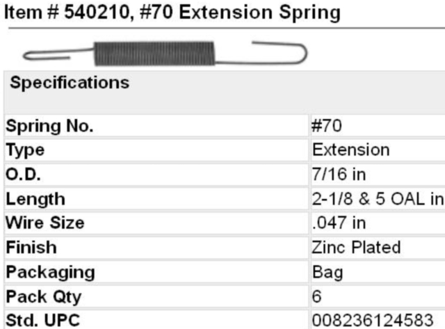

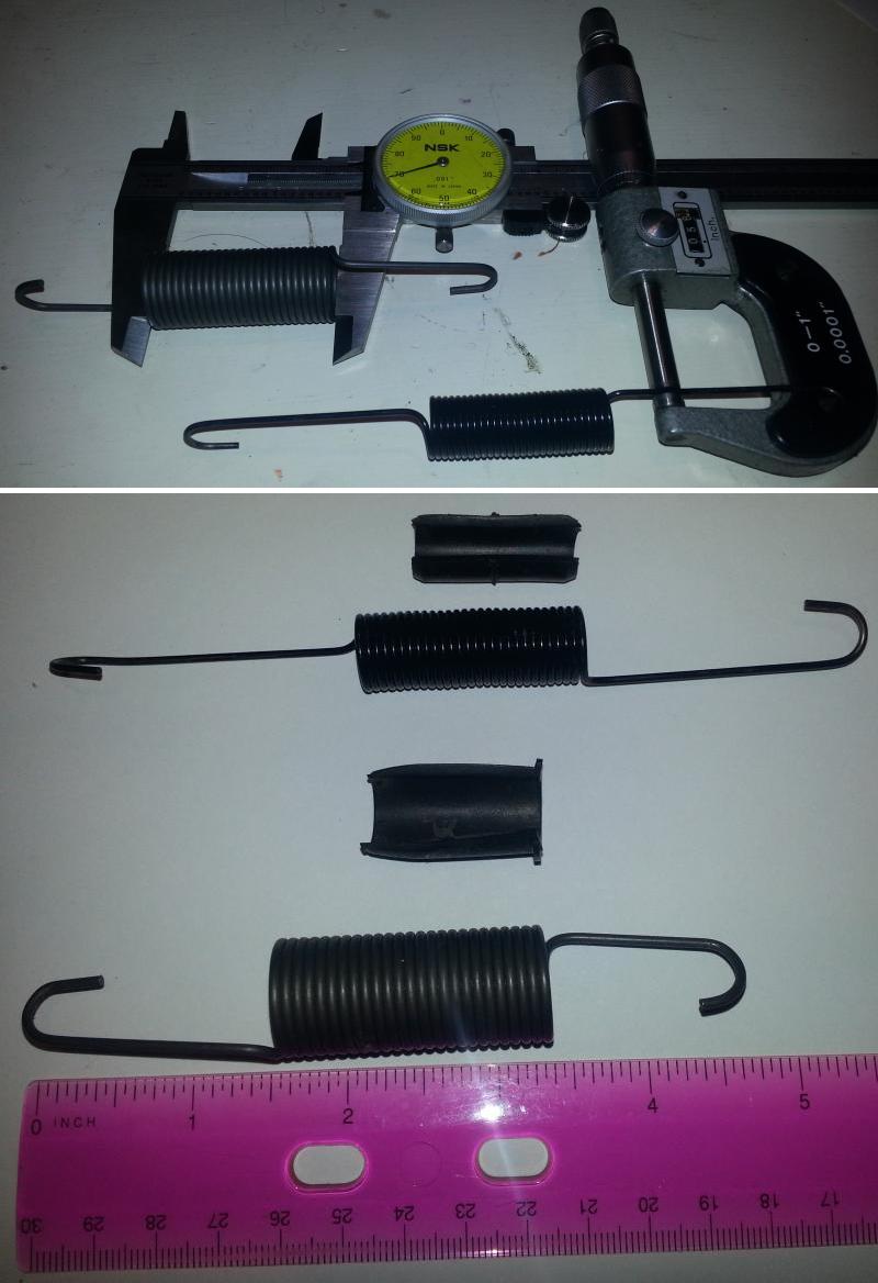

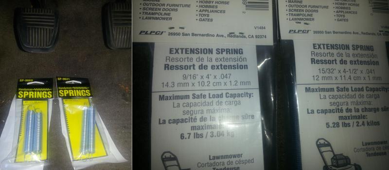

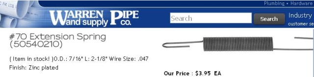

Today I'll see if I can get a spring at the hardware store. I think a "#70 extension spring" (whatever that means) is what I get (I didn't know they even had numbers).

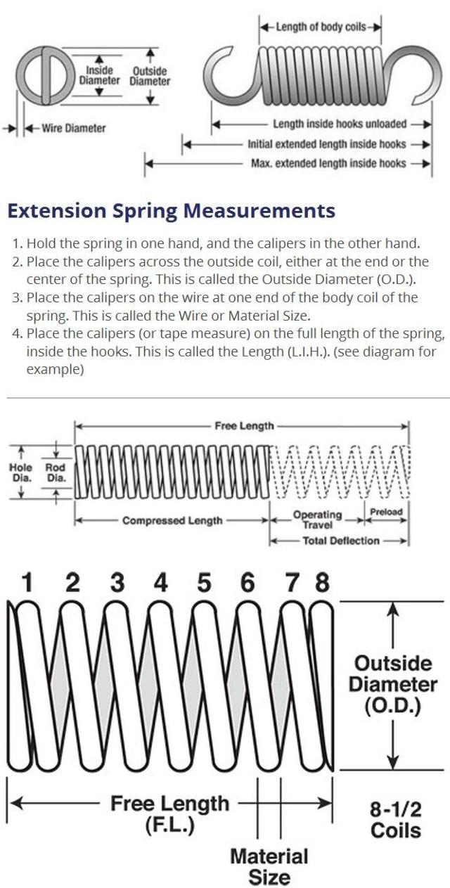

Googling for what a "#70 extension spring" even means, I found this
spring-measurement-guide.
It seems if I'm gonna buy the temporary spring at a hardware store until I can find the right nylon bushings, I should probably know the relaxed length and diameter, or, if the hardware stores sells them by #70, that will work also.
Once I get it, I'll try to measure the spring properly, so that others have a better handle on how to modify alternative choices.

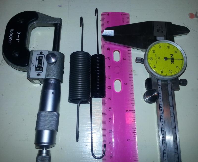

To that end, does anyone out there have any measurement for the size of the OEM Q-P-Q torsion-spring bushings that we need to find nylon replacements for?

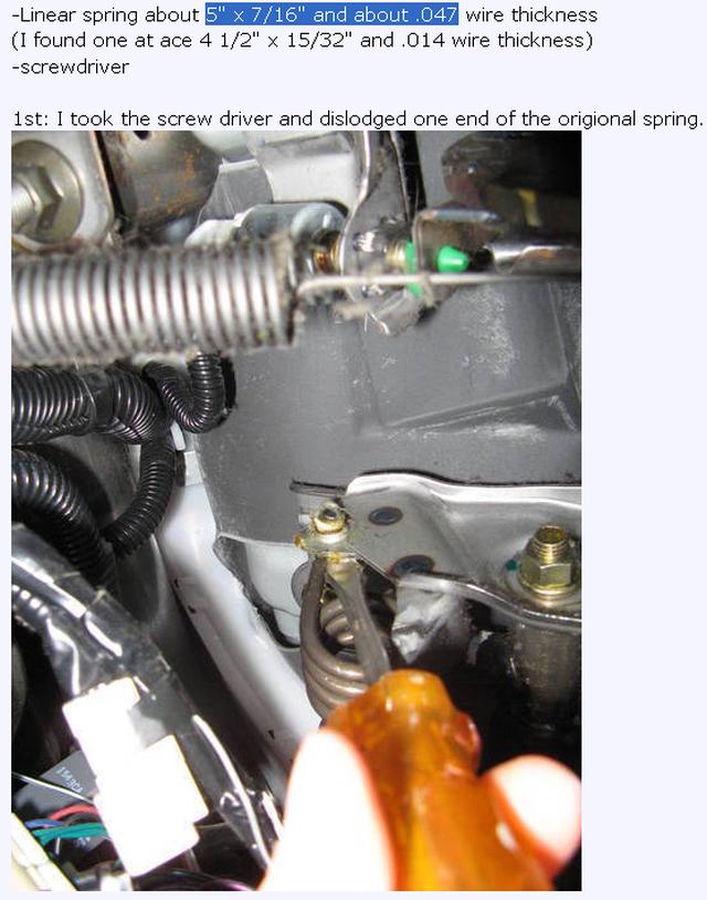

(The #70 extension spring is apparently 7/16" outside diameter, 2-1/8" long or 5" long, 0.047 inch wire size; but I don't know the size of the OEM Q-P-Q bushings yet.)
EDIT: This thread on a Tacoma forum suggests looking for a linear spring of 5" x 7/16" and about .047 wire thickness but the closest he found was at Ace at 4-1/2" x 15/32" and .014 wire thickness.

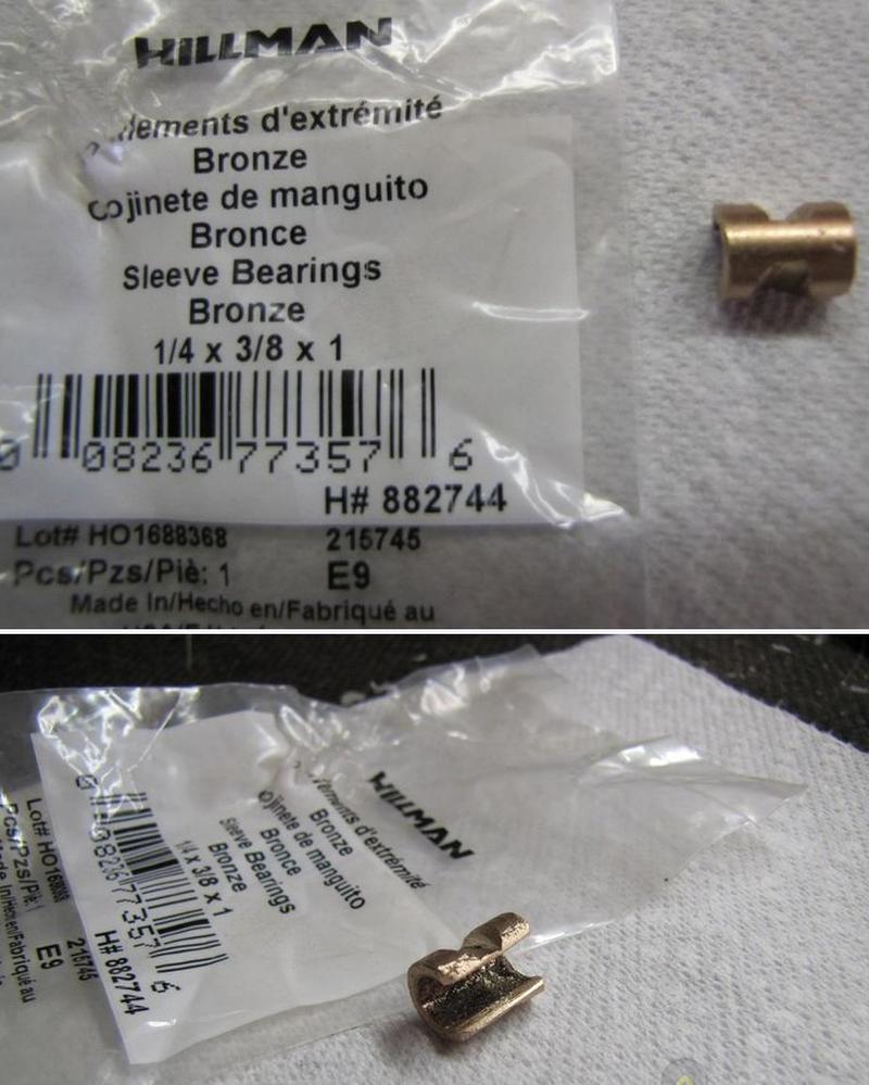

Q: What size bronze sleeve bearings should we buy to replace the u-shaped P bushing?
A: Some say a Bronze Sleeve Bearing of 1/4" x 3/8" x 1" will work.

A: Some say a #70 hardware-store tension spring (2-1/8" by 7/16" by .047 thick) will work, while others use a Toyota brake-lever return spring (PN 90905-07028? 90905-07020?, 90507-14030?), both of which work without further modification since the mounting points already exist.
Based on the wide array of tension springs people seem to be using, I'm gonna guess that the torsion-to-tension spring mod probably works no matter what spring you put in place.
Still, it would be nice to narrow down the choices so that we have a definitive answer as to what spring closest matches the desired pedal feel.
For those who have done the torsion-to-tension clutch pedal-return spring mod, can you suggest which spring worked best for you?

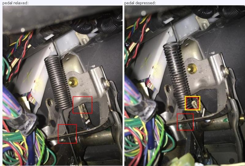

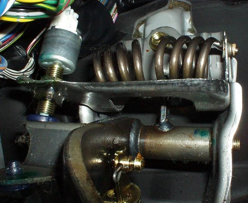

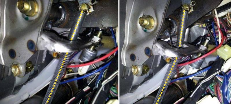

Caption: The first photo below is a shot of the hard-to-get rear view of the tension-to-torsion spring mod in a Tacoma; the rest are Toyota brake-pedal return springs other people used.
I used a Toyota brake pedal spring. i had an extra one when I did my transmission swap and it is working fine after a couple years.
A clutch spring from an 80s 2wd toyota pickup. Pretty much the same set up. Have had it in place for about 3 years. I found it in a junk yard.
I removed the torsion spring & bushings and was going to replace with a #70 extension spring but did find one and left it without the spring. It's been running ok without the spring for over a year.
Only issue is last winter it got to around 40 degrees a couple of nights and the pedal would return all the way up in morning. pulled it up with my foot and after a couple of pumps it was ok
The owner won't even drive the 4Runner, thinking it's not safe, so, I think I have to go OEM or retrofit with nylon bushings.
We have traded vehicles until I fix this, which is no big deal since I see no problem with driving it, while she's absolutely paranoid about the pedal not coming all the way up (and once in a while, sticking in the down position).
It did that on me just now as I drove to the hardware store to get the linear springs, so, sometimes the geometry of the torsion spring minus the three PQP bushings does cause enough friction for the pedal to remain down, about two inches off the floor, in the clutch-engaged position (it seems).
Anyway, a quick flip with my toe solved that, so it's not a worry for me, but it is for her, so, my plan is simple.

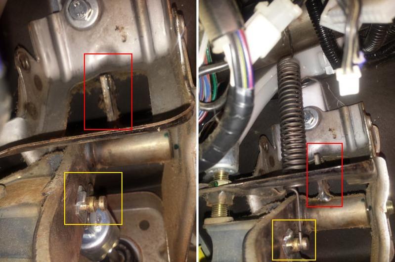

1. Remove the clutch pedal assembly (gotta look at the DIYs)
I can easily see the bottom catch for the spring, but I can't find (yet) by eyeballing it, the top catch, so, I'm gonna go through the DIYs to list the best one(s) for this repair, so that the next person following me can just go right to the best one for the 4Runner.
Despite what some threads said, the 4-cylinder seems to be the same clutch assembly as the 6-cylinder, and the same as what I've seen on the Tacomas, so, I think almost any DIY that is sufficiently detailed should do.

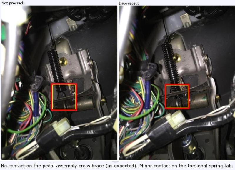

As I read the first mentioned DIY, I find instantly a problem to resolve:
Clutch squeak Linear Spring swap (TW how to)
While this guy just pried the torsion spring out with a screwdriver, he says the top of the linear spring attaches to a 'welded tab' (somewhere).
But he heard a click each time, which he presumed to be due to the width of the spring hitting something during travel.

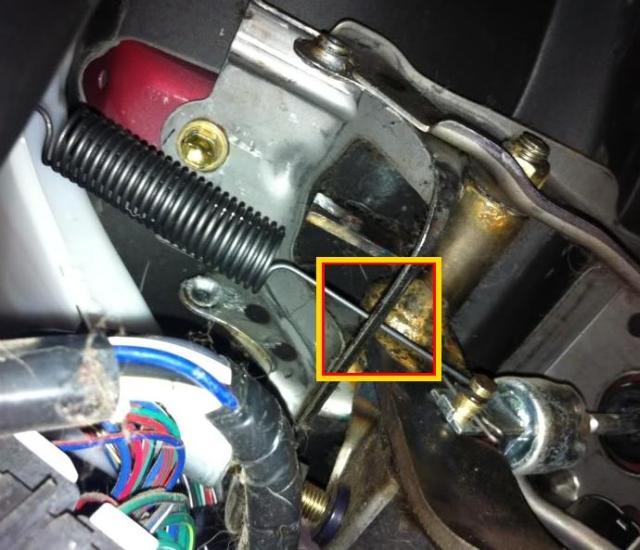

I began to hear a very faint "tick" every time I engaged and released the pedal. Of course only I am the one who can hear it but it's still pissing me off beyond belief.
Turns out that notch, in which the middle part of the torsion spring nestled into (just northeast of the spring in the pic above), rotates down when the pedal is pressed and back up again (on that axle with orange goop on it) when the pedal is released. When it does that, it ends up hitting the spring and making that ticking noise.
More concerning is when I was manually pushing and releasing the pedal with my hand, watching this crapfest unfold before my eyes, I can see the spring ever so slightly get hung up on that notch. My fear is that it gets fully hung up on it while driving.
Someone else felt the same notching:
well I just went out to check mine. (first time in probably a year) and noticed that mine hits it too. and also something strange. the spring looks stretched up until that point where it looks like it hasn't been used even when the spring is depressed. (like there is a small gap between the coils of the spring but when it gets to that part the coils are all touching. [this is when the clutch is depressed and released as well])
I just wrapped it in gaffer's tape.
Still making a little "click/tick" noise. I don't think that hitting the spring was it. It's something in the mechanism that goes through the firewall.

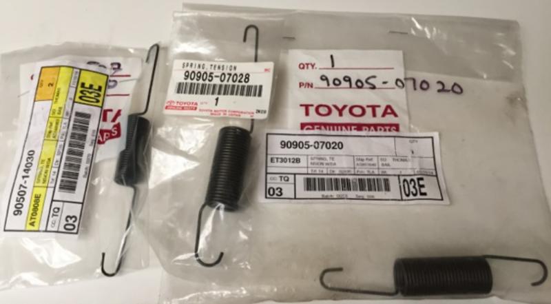

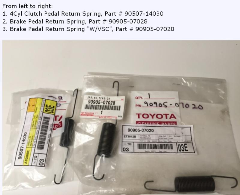

Apparently the OP switched out the spring to the Toyota brake return spring, which is of a different geometry.
After reading that entire thread for the first time, I found out that the springs I bought will have the "clicking and bending" problem on the Tacoma, which, if it happens on the 4Runner, the driver is certainly going to notice.
I wish I had known this before I went and bought the wrong springs.

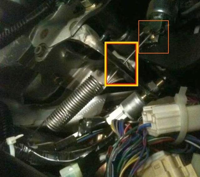

In the thread listed above, the guy finally removed the linear spring that was clicking and replaced it with the Toyota brake-pedal return spring.
The part number that Tacoma guy ended up using was Toyota 90905-07020

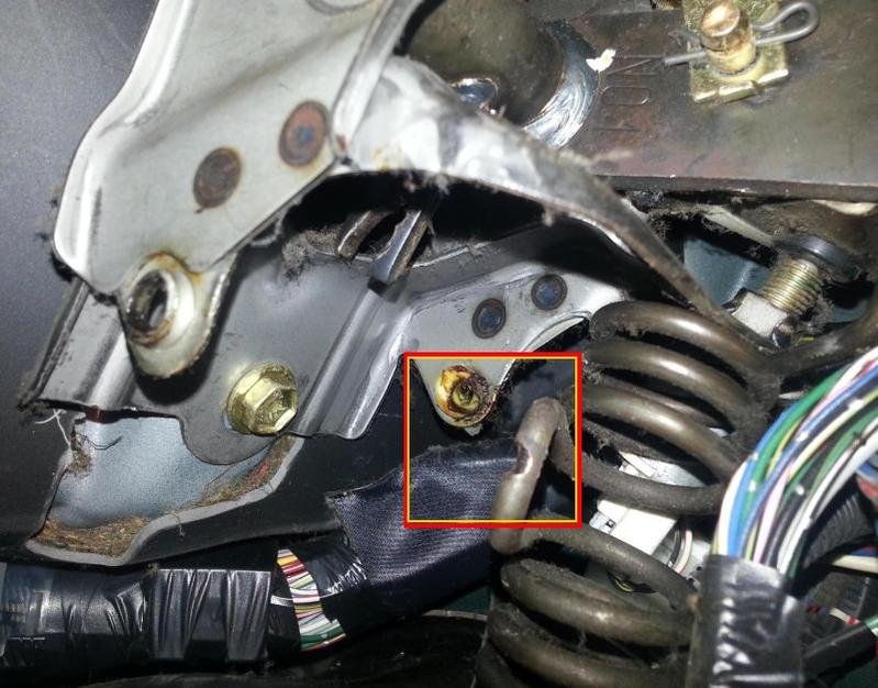

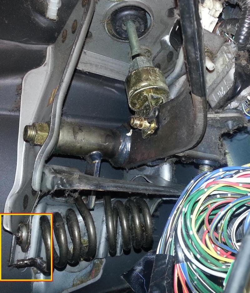

Now that I re-read all the threads, for detail, I see things that nobody mentioned here yet, which is that whatever spring is used, absolutely MUST clear that opening up high, near the upper connection tab!
For example, this picture, again on a Tacoma, shows the problem area well:
* Tacoma clutch pedal retrofit
Notice also that this picture is the best yet, for showing the upper mounting tab.

Now that I know it matters that you get a bona-fide "pedal" spring, I notice details I hadn't noticed before in the other threads.
For example, notice that the Toyota "clutch" pedal return spring seems to be of a thinner outside diameter than the two Toyota "brake" pedal return springs in this thread.
From left to right:
1. 4Cyl Clutch Pedal Return Spring, Part # 90507-14030
2. Brake Pedal Return Spring, Part # 90905-07028
3. Brake Pedal Return Spring "W/VSC", Part # 90905-07020
Looking more closely at the contact points, there seem to be two problem areas that the spring dimensions need to avoid:
1. Contact at the clutch pedal assembly cross brace
2. Contact at the clutch pedal torsion spring P-bushing tab
In the photo below, from the thread mentioned above, one of the two contact points was alleviated by the geometry of the large brake-pedal return spring; so I will try to get the smaller clutch-pedal return spring instead at the Toyota dealership.
Unfortunately, it turns out, at least on the Tacoma, that even the long-hook brake-pedal return spring 90905-07028 makes contact with the clutch pedal P bushing tab when the clutch pedal is pressed.
Based on these experiments on the Tacoma, if the 4Runner uses the same setup, and given that all three brake and clutch pedal return springs seem to make contact at either both places, or just at the P-tab, the best recommendation seems to be to go with the smaller clutch return spring, Toyota P/N 90507-14030
Out of the three, I recommend the 4Cyl Clutch Pedal Return Spring, Part # 90507-14030
The others have more spring contact and get a bit noisy.
Interestingly, the guy who ran those experiments said he felt no difference in pedal feel between the two different-sized springs:
1. Smaller 4-cylinder Tacoma clutch pedal return spring 90507-14030
2. Larger 6-cylinder Tacoma long-arm brake pedal return spring 90905-07028
As far as the difference between the 4cyl spring and the brake return spring, no real difference that I could tell with the little bit of test driving I did. The deciding factor was the amount of spring contact which can totally be solved by grinding down the torsional spring perch
Now that I have the two springs in stock, I'll run some measurements before hooking up the smaller clutch pedal return spring & checking for the two contact points in the Toyota 4Runner:
a. Toyota Tacoma 4-cylinder clutch-pedal return spring 90507-14030
b. Toyota Tacoma brake-pedal return spring 90505-07020
I don't remember anyone mentioning that the two Toyota springs come with less-than-full-size rubber inserts, so, I'll mention that now.
So that nobody else has to go to this trouble to help out, after pulling out the rubber inserts from each spring, I measure the following with the micrometer and caliper:
Brake Pedal Return Spring Toyota PN 90905-07020:
  • Length inside hooks unloaded = 4.585"
  • Length of body coils = 1.780"
  • Coil inside diameter = 0.610"
  • Coil outside diameter = 0.748"
  • Wire diameter = 0.0735"
  • Distance from the last coil to the inside curve of the hook (long end) = 1.540"
  • Distance from the last coil to the inside curve of the hook (short end) = 1.212"
Clutch Pedal Return Spring Toyota PN 90507-14030:
  • Length inside hooks unloaded = 5.610"
  • Length of body coils = 1.545"
  • Coil inside diameter = 0.413"
  • Coil outside diameter = 0.637
  • Wire diameter = 0.0555
  • Distance from the last coil to the inside curve of the hook (long end) = 2.075"
  • Distance from the last coil to the inside curve of the hook (short end) = 1.960"
Since both springs have a long end and a short end, I'm not yet sure which way goes up, so, if you already know, please let me know ASAP.
(The less-than-coil-length rubber inserts seemed to me, as I recall, to have been in the short end.)
  • Difference between long and short end on the brake-pedal-return spring = 1.540" - 1.212" = 0.328"
  • Difference between long and short end on the clutch-pedal-return spring = 2.075" - 1.960" = 0.115"
If it matters, if I close my eyes and hook my finger in each end of both springs, and pull, they seem "about the same" in feel initially, but after trying it a few times, there seems to be a slight more "bounciness" and "stretchiness" in the brake-pedal return spring than in the clutch-pedal return spring.
The deed is done, but what happened was entirely unexpected.
First off, getting the old clutch pedal return torsion spring off took only a couple of minutes, whereas I had expected that task to be somewhat difficult.
I removed absolutely nothing prior. All I did was lower the seat back on the front drivers seat and slide it back as far as it would go, and I raised the steering wheel and I put a shop light and a few pliers and screwdrivers on the carpet. That was it for prep.
The reason it took two minutes was that I was prying with only one large screwdriver for the first minute. When I added the second pry bar to the mix, pop, off came the torsion spring, which stayed in place and didn't bounce around.
Of the three plastic Q-P-Q bushings, only one Q bushing was still in place and the torsion spring had about 1/3rd of its diameter eaten away (so this problem was a long way in the making!).
Predictably, the P tab welded onto the clutch pedal was also well eaten away.
But, super surprisingly (to me, anyway), the clutch pedal feel when I tested it without any spring, was actually pretty good! Also, the cruise control switch seemed to be depressed (although I didn't test it on the road), even without any spring.
So, for sure, 95% or more of the clutch pedal return is simply due to the back hydraulic pressure from the pressure plate back onto the slave and master cylinders.
I then hooked the short end of the clutch pedal return spring to a tab with a hole in it up above, and then pulled with a pair of needlenose pliers, and in just a couple of tries, the linear spring was attached.
It was super easy! Five minutes, maybe ten, but no more than 10 minutes from start to finish! Wow. I had expected far worse from what some people had written (although others did mention the job was super simple).
The next surprise was when I tested the clutch pedal feel, in the garage (not yet on the road), where I couldn't tell the difference between the pedal feel with the spring and the pedal feel without any springs!
The only difference I could see is that the cruise control switch was definitely depressed fully with the linear spring in place. That was about it for what seemed different with and without the linear spring.
Up until now I thought people were crazy who said they removed the torsion spring and operated the clutch without any spring whatsoever, but now, I think that almost 98% or 99% of the pedal return is due to the back pressure from the pressure plate.
Very little pedal-return force seems to be due to the spring, which is surprising, considering how thick the torsion spring was.
At first, I thought that was crazy to operate without a spring, given how thick the torsion spring is; but now I have to agree with you.
The pedal feel without any spring is almost the same, if not the same, as the pedal feel with the linear spring in place.
The only difference I felt was maybe slightly less slop in the last quarter inch.
Here, by the way, is a picture of how badly the spring was eaten into.
I'd say it's about 1/3 the way through, so, this problem happened long ago.
So I'd say the P bushing goes first, then both the spring metal and P-tab go simultaneously (presumably causing the squeak), and finally the Q bushings fail when the spring geometry changes over time (where below there is only one Q bushing left).
