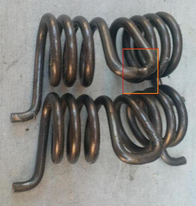

From that same thread by sggaz, it seems it's a bad idea to keep the eroded spring, since his worn spring wore through the new P bushing in less than 2 years.
Here's his worn and new spring, side by side.
Since there are strong springs and the space is limited under the dash, it's imperative to have a DIY that covers all the steps, so I started searching and found this, which may be useful.

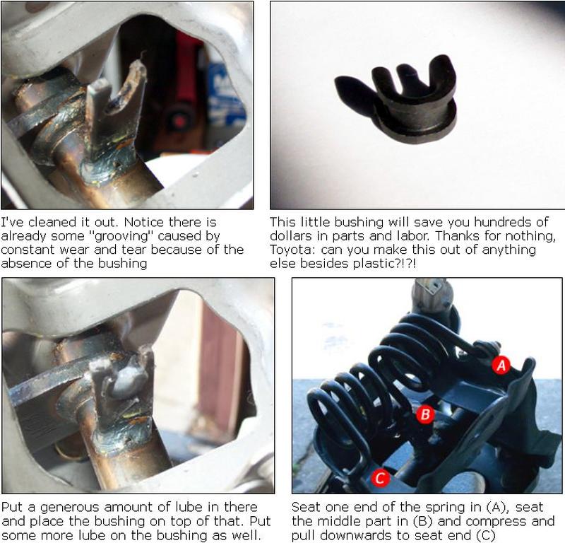

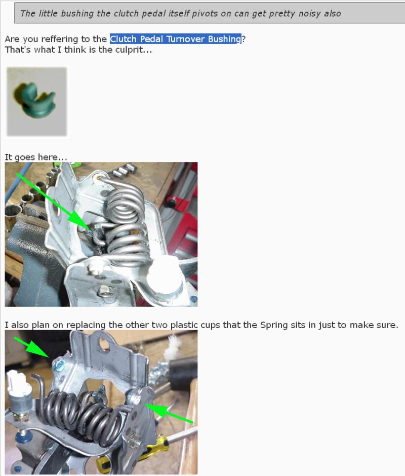

Replacing the Clutch Pedal Bushing
Date: 1/4/2004, By: Bob_98SR5
4Runners.org - Replacing the Clutch Pedal Bushing

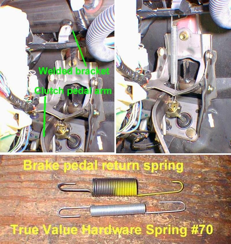

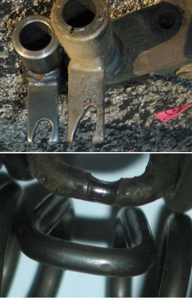

This thread says we can "re-engineer" the 4Runner u-shaped spring to use a linear spring instead, presumably from the tacomas, but maybe not:
http://www.toyota-4runner.org/3rd-gen-t4rs/188611-tacoma-clutch-pedal.html
The Tacos have a linear spring and the T4Rs have a horseshoe/ "U" spring. The linear spring is upgradeable on the 4Runner pedal.
-Chuckles89
From what I can find online, Tacomas had the same radial spring as 4runners, but quite a few guys remove them and replace with the linear spring similar to the brake pedal.
The radial spring is more than a return spring though, so it makes operating the clutch different. The swap is mostly done due to the annoying creak and constant wear of the plastic spring-retaining bushings.
I think I can use the Tacoma guts on a 4Runner bracket ordered through the dealer or other OE outlet, but a confirmation of that would be awesome.
This thread has pictures of the re-engineered linear springs used by one re-designer:

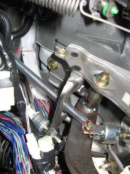

FSM Clutch specs (from my paper '99 4Runner FSM):
1. CHECK THAT PEDAL HEIGHT IS CORRECT
Pedal Height above Floor Panel: 175 - 185mm
Pedal Height above Asphalt sheet: 172 - 182mm
2. IF NECESSARY, ADJUST PEDAL HEIGHT
Loosen the lock nut and turn the stopper bolt until the height is correct. Tighten the locknut.
3. CHECK THAT PEDAL FREEPLAY AND PUSH ROD FREEPLAY ARE CORRECT
Push in on the pedal until the beginning of clutch resistance is felt.
Pedal freeplay: 5.0 - 15.0mm
Gently push on the pedal until the resistance begins to increase a little.
Push rod freeplay: 1.0 - 5.0mm
4. IF NECESSARY, ADJUST PEDAL FREEPLAY AND PUSHROD FREEPLAY.
a) Loosen the lock nut and turn the pushrod until freeplay and the pushrod play are correct.
b) Tighten the locknut.
c) After adjusting the pedal freeplay, check the pedal height.
d) Connect the air duct and install the lower finish panel.
5. CHECK CLUTCH RELEASE POINT
a) Pull parking brake and install wheel stopper.
b)Start engine and idle the engine
c)Without depressing the clutch pedal, slowly shift the shift lever until the gears contact.
d)Gradually depress the clutch pedal and measure the stroke distance from the point the gear noise stops (releae point) up to the full stroke end position.
Standard distance: 25mm (0.98in) or more (From pedal stroke end position to release point)
If the distance is not as specified, perform the following operation.
-Check pedal height
-Check push rod play and pedal freeplay
-Bleed the clutch line
-Check the clutch cover and disc.

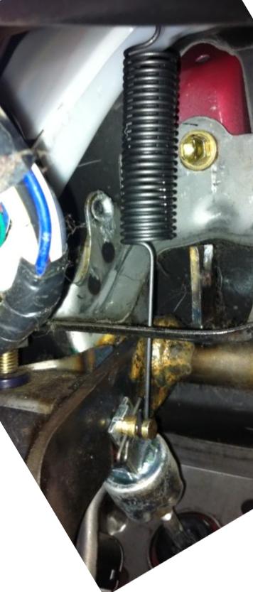

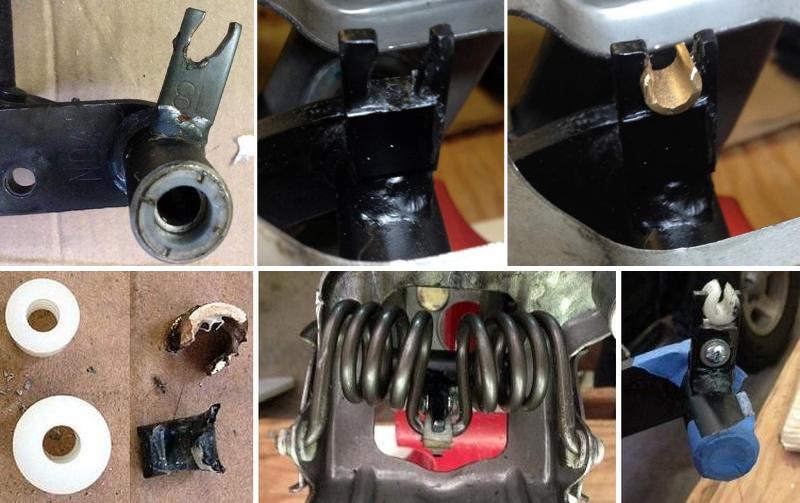

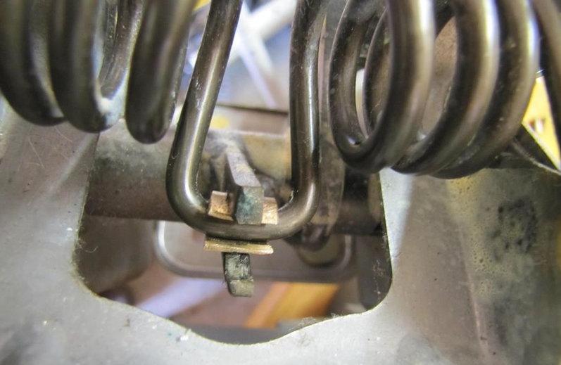

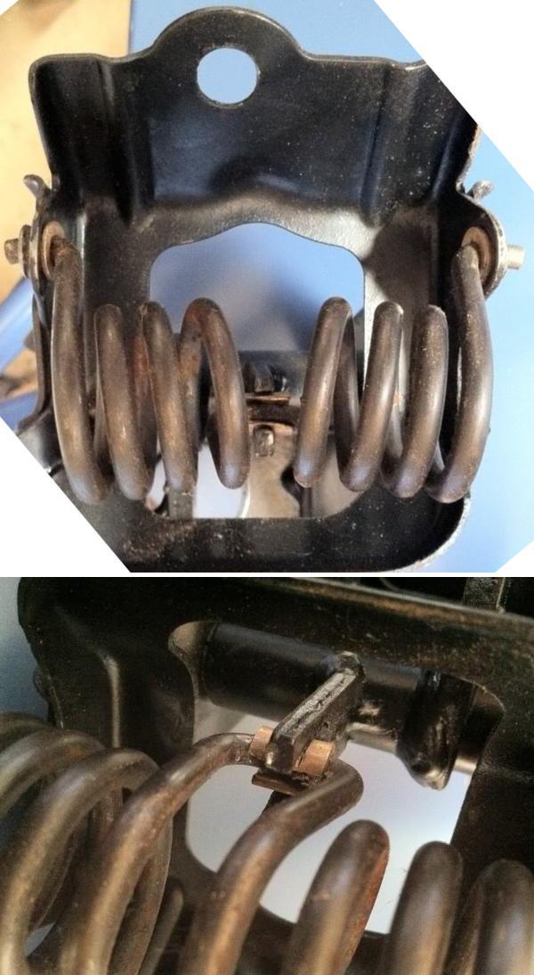

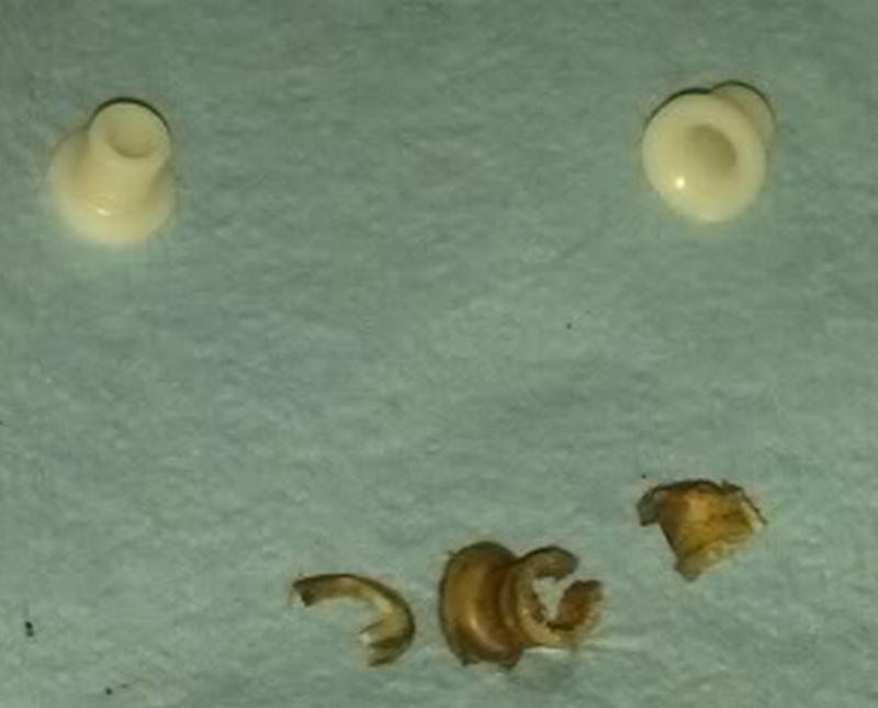

Thanks to your advice which pinpointed the problem, I was able to show the owner the the problem, and so I gave the 4runner back this morning for temporary use.
The owner asked WHY that little bit of broken plastic would cause the clutch pedal to either stay on the floorboards in the morning, or to not come back all the way up the rest of the time.
I don't know. Maybe friction?
The owner asked what the remedy is, and I said I'd talk to you guys to ask whether I should add the brake-spring retrofit or replace the clutch pedal and bushings.
I don't even see *how* the brake-spring retrofit works but I guess it just pulls up the clutch pedal just like my foot did when I was testing it out.

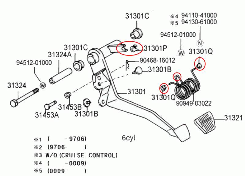

I'm usually inclined to just replace the bad parts with OEM parts (unless you think otherwise), which despite being plastic, did last almost 20 years.
I think all I need to order from Toyota is:
a. The clutch pedal
b. The one plastic U-shaped "P" spring-middle bushing
c. The two plastic round "Q" spring-end bushings
d. The double-coil "horseshoe" return spring
Do you recommend anything else?

Given that, then the linear spring workaround has a much greater chance of actually working (in that it just brings up the pedal that last inch).

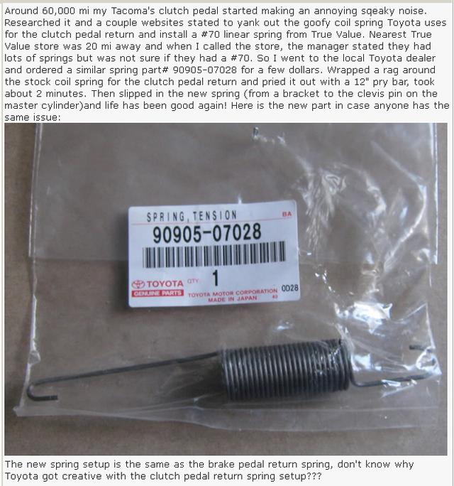

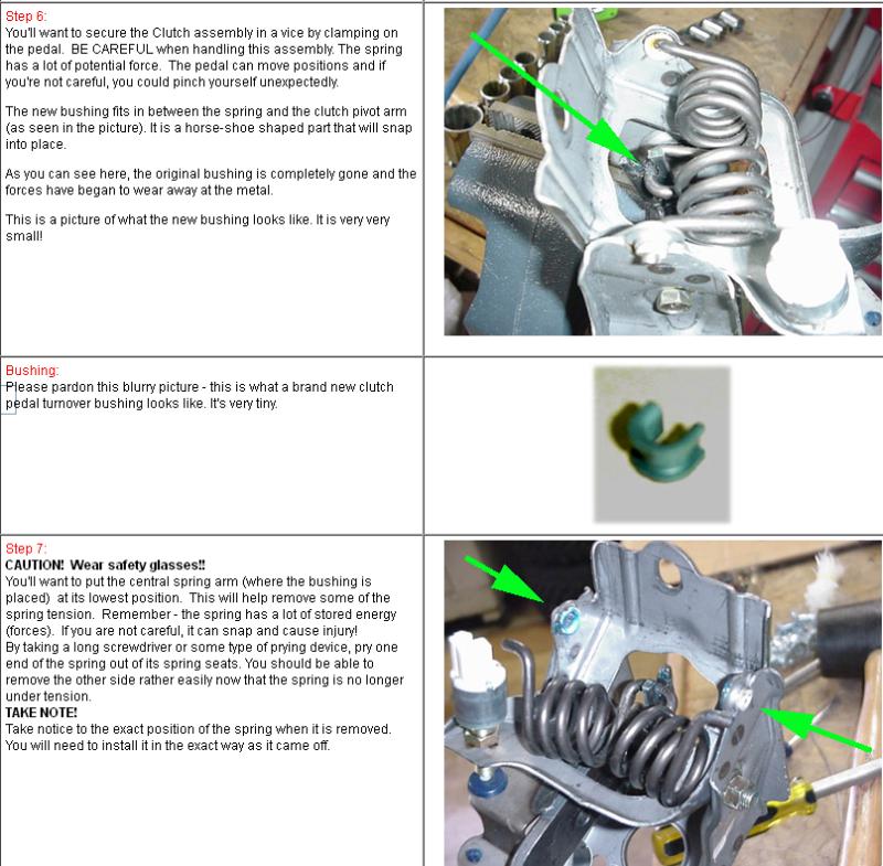

Our counterparts over on the Tacoma side have had similar problems, so here's a nice writeup for the next person who has this problem to benefit from.
Toyota Tacoma: Clutch Pedal Bushing Replacement
Welcome to LIEBLWEB.com's Toyota Tacoma Clutch Petal Bushing Replacement Write-Up!
Troubleshooting: On Toyota Tacoma trucks equipped with manual transmissions, a squeak or grind is often heard when pushing down on the clutch pedal. This squeak or grind can also be confused with another clutch related problem - so please make sure you are performing the proper repair for the problem you are encountering. Take time to read the information below- and you should be able to take a look at your current clutch pedal turnover bushing and make a decision if it needs to be replaced.

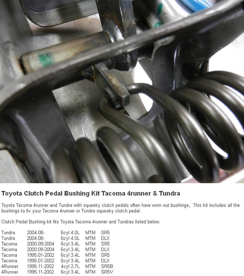

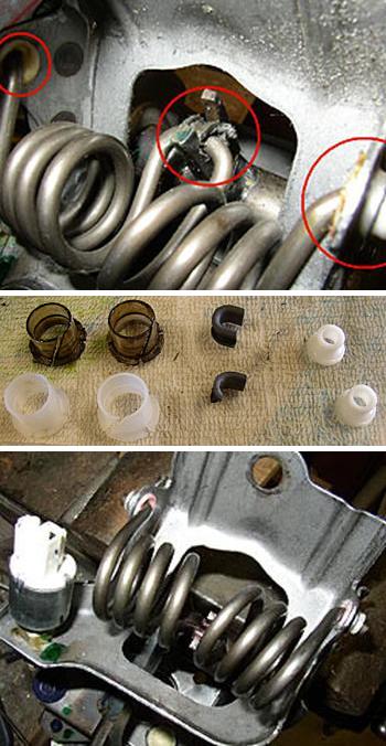

Toyota Clutch Pedal Bushing Kit Tacoma 4runner & Tundra - KIT-1028
Here's a similar clutch pedal squeak repair modification on the tacoma side:
Clutch squeak Linear Spring swap (TW how to)
Noisy Tacoma Clutch Pedal
They said it was highly unusual for a Toyota clutch pedal to squeak and that they couldn't figure out why it did that.
Thats BS! I've owned 3 manual toyotas (95 4Runner, 2011 Tacoma and 97 4Runner) and all three of them squeaked! I bought the Tacoma brand new too.
Since this Toyota had a squeak that the dealer couldn't fix under warranty, the reason for the squeak might actually be inherent, somehow, in the design.
This thread implies that the torsion spring itself is the cause of the squeak (and not bushing wear!) perhaps due to metal-on-metal rubbing of the horseshoe-shaped-spring coils?
https://www.tacomaworld.com/threads/clutch-squeak-linear-spring-swap-tw-how-to.159429/page-5
I mostly did it to get rid of the horrendous squeak the torsion spring made.
Added bonuses = better contact with the CC switch and better clutch pedal feel (IMO).
And FWIW, the brake pedal return spring I used (highly recommend this over the spring used in the OP - even the OP eventually made the switch to the brake return spring) has a little bit of wiggle room at the top.

Replace Your Clutch Pedal Bushings
Tech Knowledgebase - Replace Your Clutch Pedal Bushings
So, if you're like me, you wait until the squeal from your clutch pedal is driving you absolutely insane then you do something about it. Replacing the clutch pedal bushings is a fairly straight forward project. It also seems to be a near annual event for my truck. You will need the new bushings, a few tools, and an hour or so to complete the replacement.
Toyota Part Numbers for Replacement Bushings:
90386-05018 - 2 ea (Round for the sides of the spring)
90389-05017 - 1 ea (U-shaped for the center of the spring/pedal groove)
90386-13007 - 2 ea (Round for the center pivot tube of the clutch pedal)
90386-08002 - 1 ea (fork plunger through pin bushing)
90949-03022 - 1 ea (spring)

BTW, notice they have MORE bushings identified to replace than just the P/Q bushings I've seen until now.
Do we, on the 4Runner, have those additional bushings?
It looks like there have been a few different redesigns that attempt to solve both the problem of the chronic pedal-return squeak, and the frequent wearing out of the plastic bushings.
This guy replaced all the associated plastic bushings, not just the P/Q bushings, with bronze.
Tacoma Bronze Clutch Pedal Spring Bushing Replacement (PICS)
Tacoma Bronze Clutch Pedal Spring Bushing Replacement (PICS) - TTORA Forum
Them plastic bushings keep failing on me and there like $4.00ea at the stealership so I decided to make this a permanent fix. Cost me About $7.00 to replace all the bushings and took about 30min to make them fit right.
While I have been referring to the U-shaped bushing as the clutch return torsion spring "P" bushing, this thread calls it the "Clutch Pedal Turnover Bushing", so that may be a more proper search term in the future.
Throwout Bearing issues
Throwout Bearing issues - TTORA Forum

Grumble grumble stupid clutch bushing grumble (pictures)
http://www.ultimateyota.com/showthr...umble-stupid-clutch-bushing-grumble-(pictures)
Anyone with a 5spd 3rd gen 4Runner knows that Toyota dropped the ball with their design of the clutch pedal assist/return spring. Last week I entered round three of my battle with this little issue, and I would like to share my current solution in case it helps others.
This guy confirmed what the other articles merely implied, which is that you remove the factory spring and replace it with the linear spring:
I pulled out the factory spring and replaced it with a linear spring, which was the popular solution at the time.
However, it didn't work for long. So he replaced the u-shaped "P" bushing with bronze, and replaced the pedal-return torsion spring and the two "Q" bushings on each end of the torsion spring.
Unfortunately ...
Things worked fine for about a year, and then during a recent trip to Oregon the bronze bushing broke and wound up in my floor mat. Awesome.
His redesign was DIFFERENT than all the previous redesigns:
I don't have a welder, so I used some metal epoxy to glue on steel side plates and to fill in the worn out area. My idea was to increase the surface area so it wouldn't wear through so quickly.
He then fabricated a new bronze bushing, but ...
I then made a new bronze bushing and put it in place and re-installed the spring (after the epoxy cured overnight). Conveniently this new bushing failed after about 20s of testing on the bench, so the spring came back out. And to make things more fun the spring pressure was strong enough that it popped the new side plates off. Crap.
Since no good deed goes unpunished...
I needed the truck the work the next day so out came more tools. I drilled a hole through the side plates and bolted them in place. And since I had one sitting around I put a factory plastic bushing in place. It failed after about 15s of testing on the bench.
But he kept trying...
For those keeping score we are now at spring 2 and Matt 0. I was going to make another bronze bushing, but bronze is very fragile and as soon as it deforms due to pressure it crumbles. After a quick trip to the hardware store I came home with some thick wall nylon spacers. Here are the spacers and the remains of the bronze and plastic bushings.
Finally coming up with a NYLON bushing workaround:
At this point I decided that I would probably have to replace the clutch pedal, so it was time to have some fun. I used a file to widen the notch, and then machined the nylon bushing to fit, attempting to keep as much wall thickness as possible. This nylon is very tough and a pain to machine, which is a good sign.
223896d1477076665-5-speed-clutch-pedal-sticks-floor-morning-three-days-row-torsionspring.jpg
I did this on mine...removed the torsion spring altogether. Why they designed something so complex for that application is beyond me.
No more noise and pedal pressure is fine. Best 15-20 minutes I've spent on the runner.
hremoved the torsion spring altogether. Why they designed something so complex for that application is beyond me.[/QUOTE]
It's great that you provide experimental experience, since those of us merely contemplating the move, need to know the ramifications.
The suggestion to ditch the torsion spring in favor of the linear spring still brings up a question that I would LOVE if someone could answer.
[B]In the OEM setup, what exactly forces the pedal to return?[/B]
a. Is it a combination of the pressure plate plus the torsion spring?
b. Or is it just the torsion spring?
If it's just the torsion spring, and not the pressure plate working "backwards" (somehow, through the hydraulics???), then it seems that "any" spring that works, should work exactly the same; so the method below stands a chance, conceptually, of being exactly equal to the torsion spring. Is that correct?
Hence my question ...
