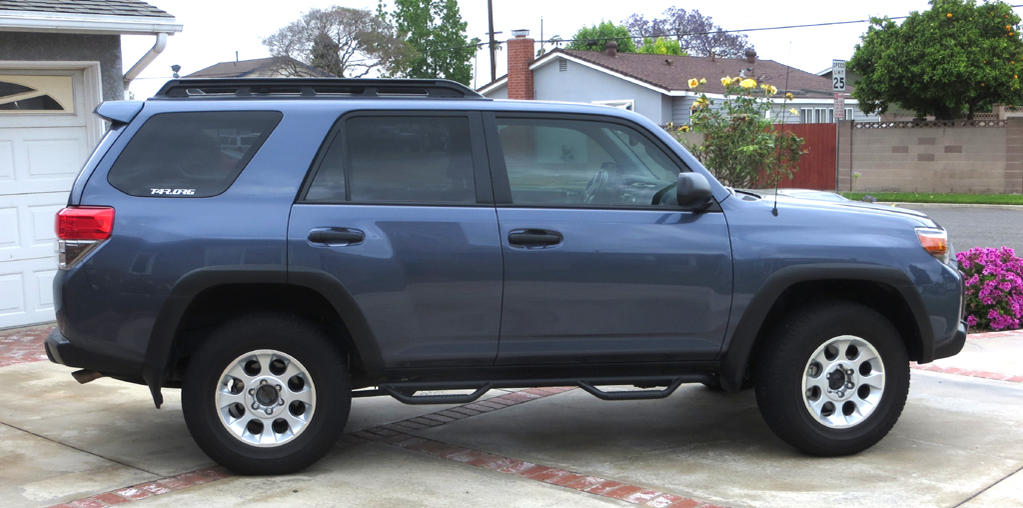

Was going to install myself but friendlys auto located in long beach New York did the complete install for $150
How could I say no?
So far so good
Love the look
Ride seems great
Did the .85" setting

I was going for level, the rear has Air Lifts but no increase in height. There was a 2 inch difference between the front and back when measured at the top of the fender well. I wanted to go with 1.75 but we put a floor jack under it, lifted to 1.75 and decided to go with 0.85. I looks almost level with a slight rake. I think without rear spacers 1.75 would have been too much.
Now I need to finish the job and put Bilsteins in back too.

-- After photo --
