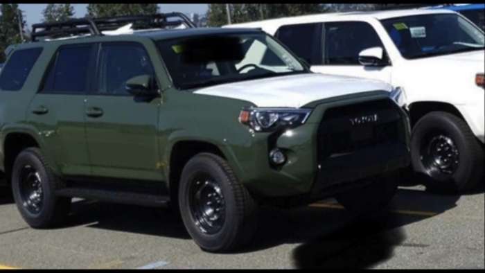

In full disclosure - there are times I wish I had gone for the Inferno TRD Pro vs KDSS Trail Premium. Inferno is the only color of TRD Pro I've really loved. But KDSS won out for me. And the sunroof is nice to have at times. It wasn't until later that the TRD Pro got the "premium" trim features like the sunroof and mirror puddle lights etc.
