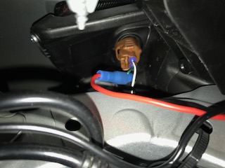

So here are couple of pics of where I've tapped into the side marker lights. Again, I've changed my marker lights to LED's. So the combined load of the marker lights and the 3 grill marker lights are relatively low and rest assured you won't be popping/blowing the fuse.
For reference, the green wire is the power. I just tapped into the green wire. The white is ground. For my ground wire from the grill lights, I just grounded it separately. In the pic, black wire to ground. Hope this helps.

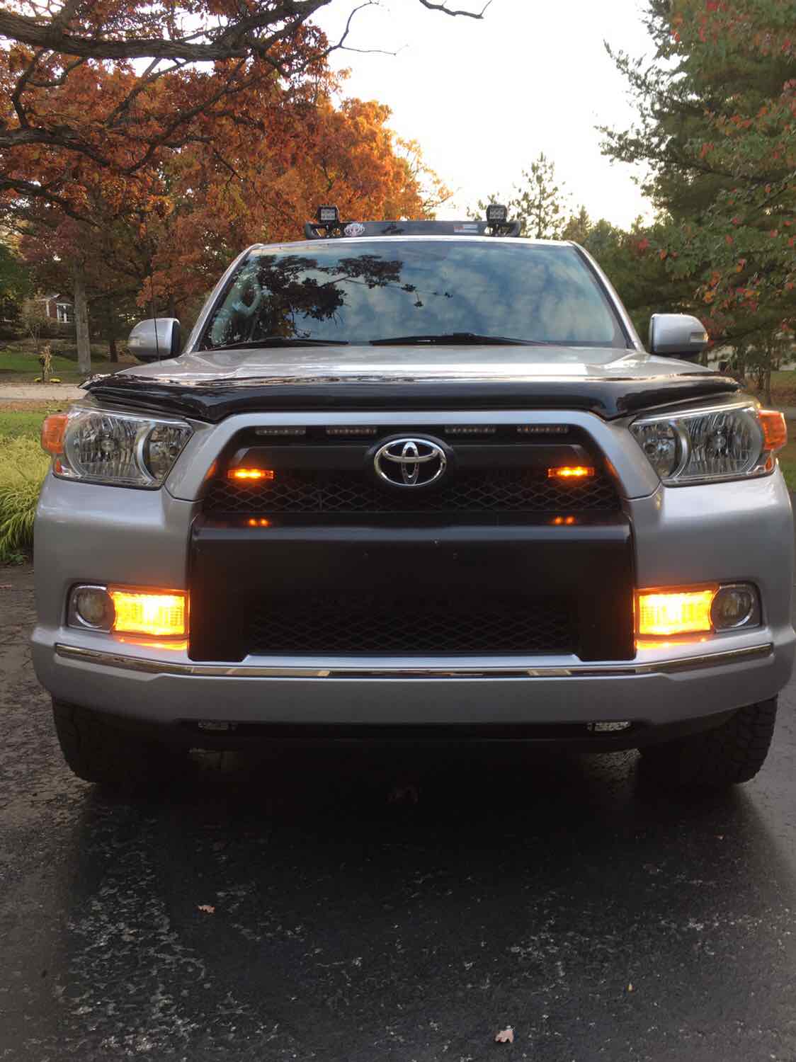

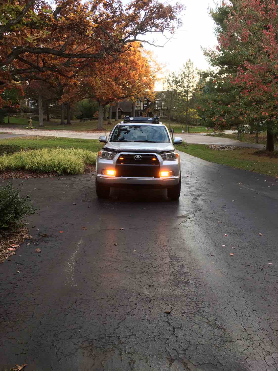

Work in progress. Using the clear lens red led. Intending to use it for off road only.

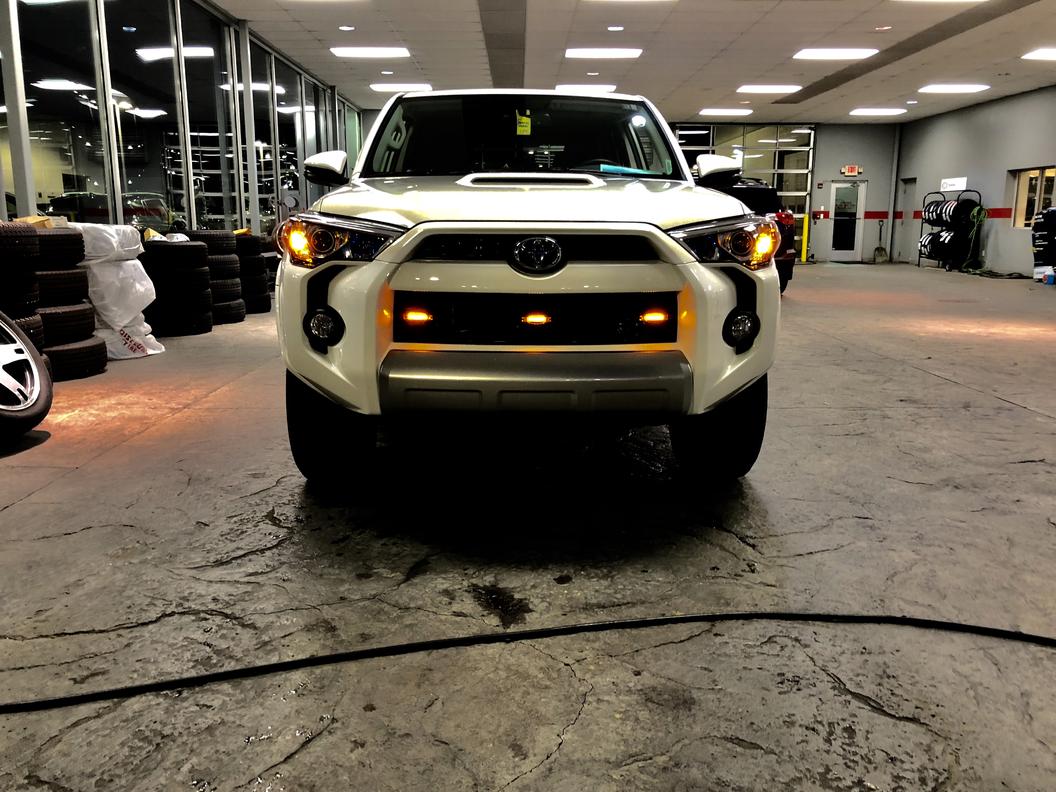

Hey all. Relatively new here, as I transition from a Tacoma (and tacomaworld). Finally got around to doing this mod and very happy with the results and ease of it. Went with the standard Amazon amber leds and wired into the running lights.

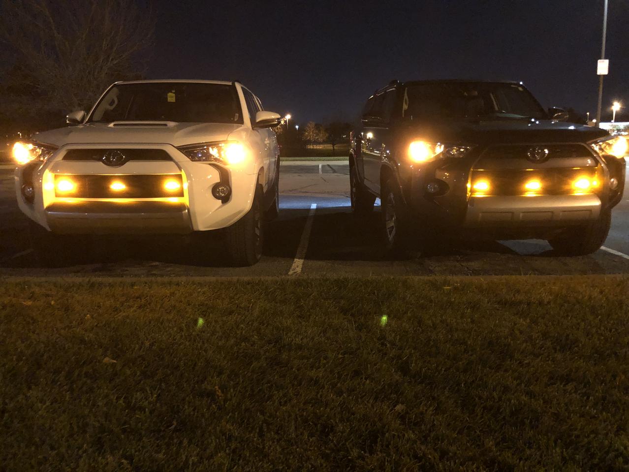

Followed RCO method on mine and my friends rig
Very happy the way both Rigs turned out
