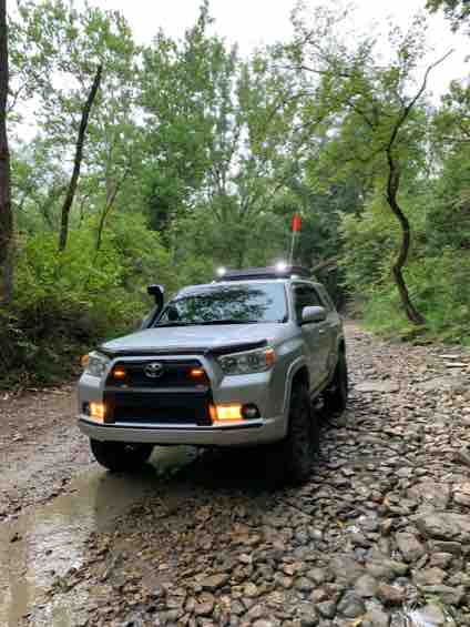

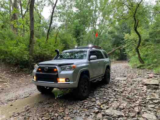

$75+ for these kits?!? Yikes.
I stand by my less than $20 set that have held up great.
