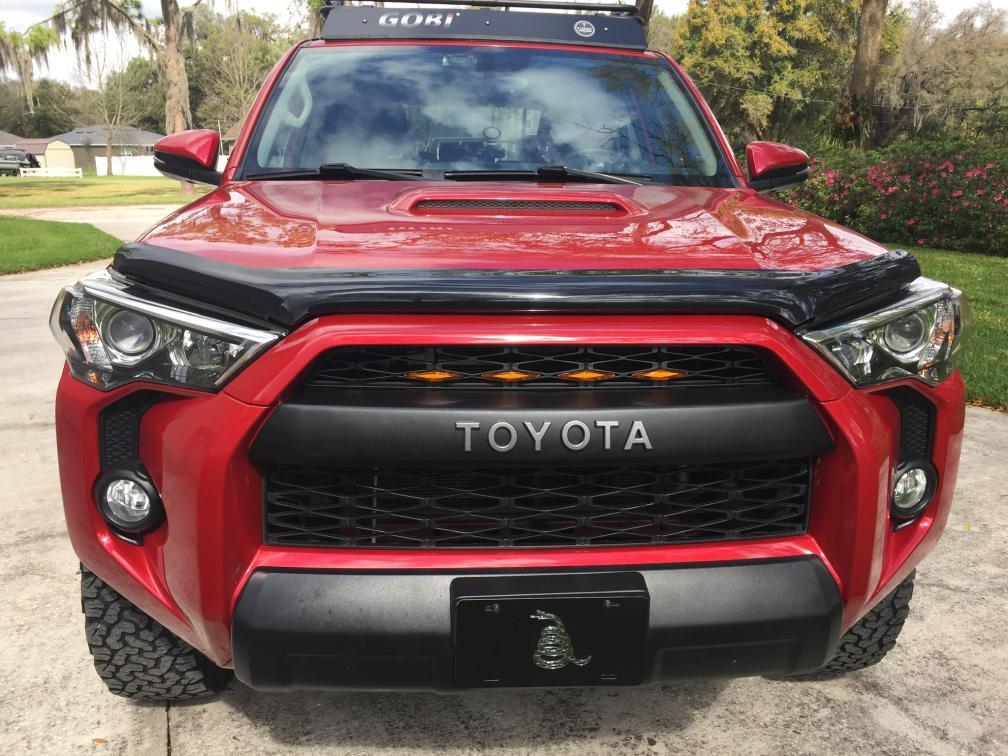

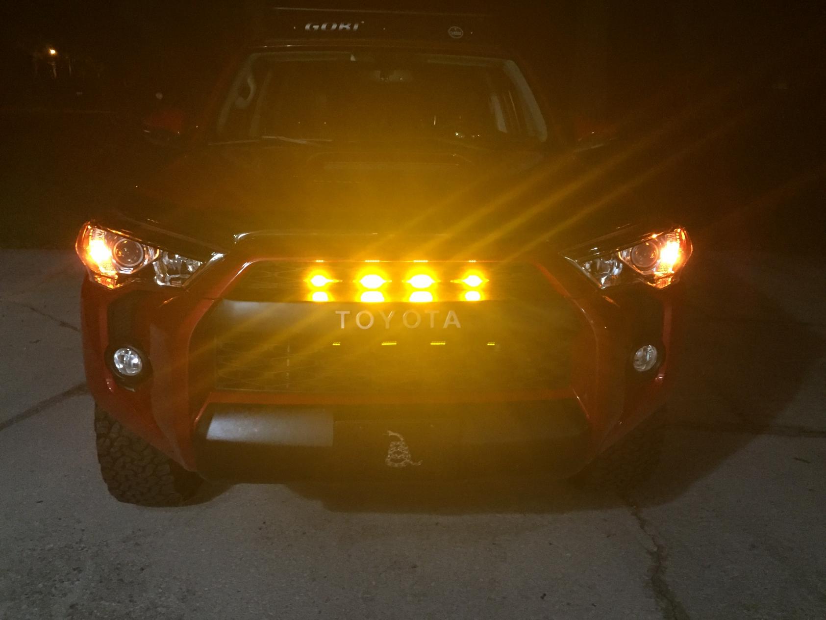

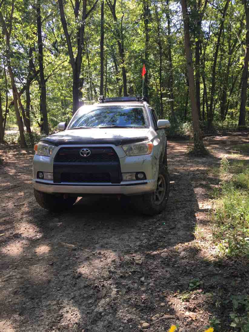

I bought my lights from Amazon and made the harness to be like the ones that Are sold. I have $29 invested.

Is that a SDHQ mount? On the limited the upper mount is just a tad low (it is made for the other trim models). Mine is just slightly higher than that but my light bar might not be as wide as yours. So it may be as high as you can go. You might have to take a look at the mount and see if it will side up any higher.
Cali Raised agreed that the light bar needed to be moved up a little to look better. They didn't believe that it effected the light beam but wanted to make me happy. They are making a new one to replace this one.
Now I just need them to make fog lights.

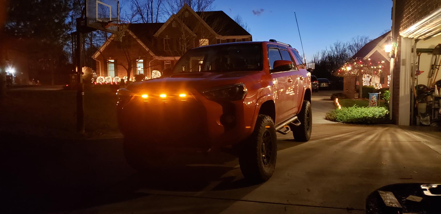

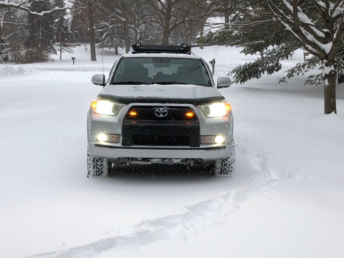

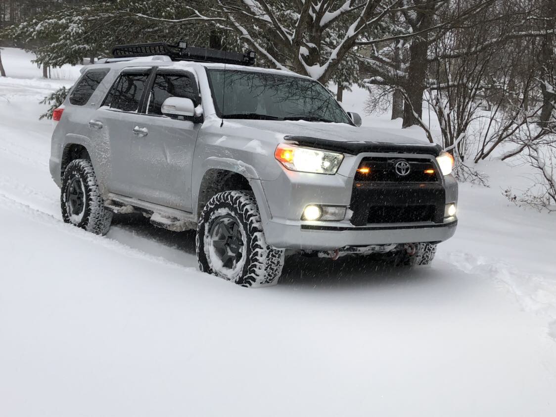

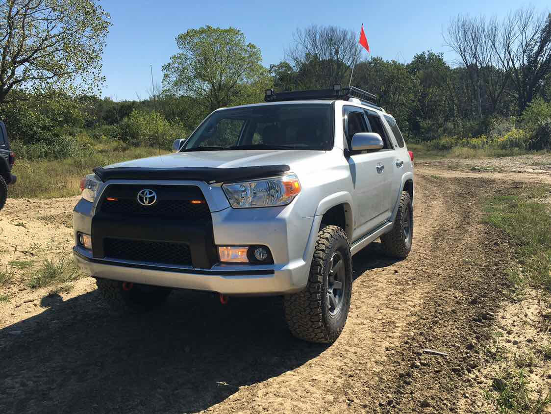

Quick update on mine...still going strong. These are the bar-style LEDs found at Menards. I’m sure you can snag them other places too. Thought it would look better with the boxy 2010 styling rather than the bullet lights. I simply mounted them using 3M mounding tape found at any Vato Zone or other car supply store. Still love the look and not one issue with the active winter we’ve been having.
[MENTION=140439]Decipher[/MENTION] are they these lights? I was actually looking at them when I was there today they are only $5 a pop in store the lumen rating looked high on them though for marker lights so I didn't get any yet but still may for the price.
https://www.menards.com/main/tools-hardware/automotive/towing-cargo-management/trailer-lighting-wiring/towsmart-reg-amber-led-running-light/2494/p-1444447120987-c-1527167451363.htm?tid=-3894824996779671377&ipos=18
Also for wiring did you just use T-taps, an add a fuse and body ground like most everyone else?
That’s them! And yes, exactly what I did for wiring. They’re plenty bright even in daylight. I love them!
Pic of them off...

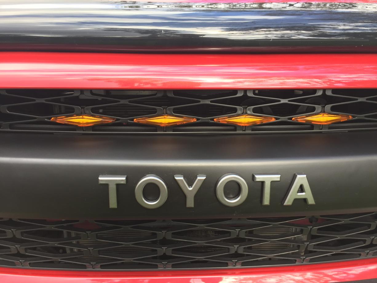

I went ahead and did this today. $32 into it and less than an hour longest part was making the harness and feeding wires through the loom. Lights are zip tied currently I have a PRO grille on the way and have a spot for #3 in the harness once I get the PRO grille I'll likely 3D print some mounting hardware or do away with the zip ties .
[MENTION=27343]jonz[/MENTION] where did you find the diamond shape lights that fit into your grill? Yotaled?
Thsnks
Thsnks
They were an optional add on with the TRD grill kit from cartrimhome.com. They can be purchased with the grill or as a stand-alone item.
