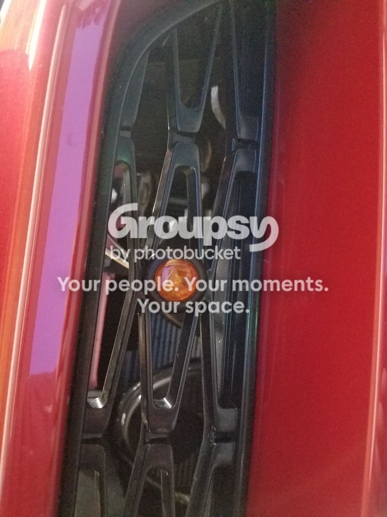

Thanks for the response, I'm going with the oznium bolts suggested by [MENTION=139136]OnTheRocks[/MENTION] now that amazon has the 11mm in stock again. I'm surprised they don't flash when unlocking with the remote/key. Guess I'll have to dig deeper.
[MENTION=117927]TRUSTYAXE[/MENTION] I was looking at having them flash when unlocking with remote but then you will probably need to tap into the turn signal fuse and they will flash whenever you use your signal as well. I've decided to keep them on the fogs and DRL. BTW, almost two months later and they are brighter than ever, didn't have any problem with them. I love Oznium products. not cheap but well worth

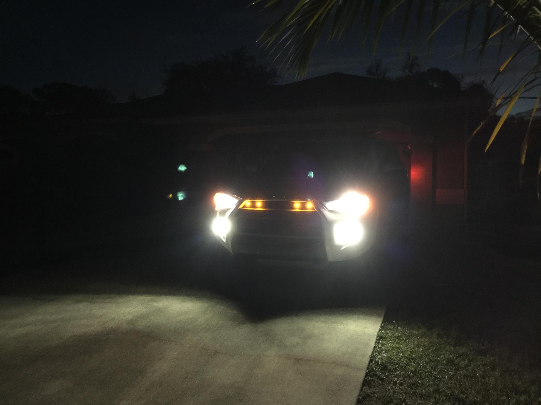

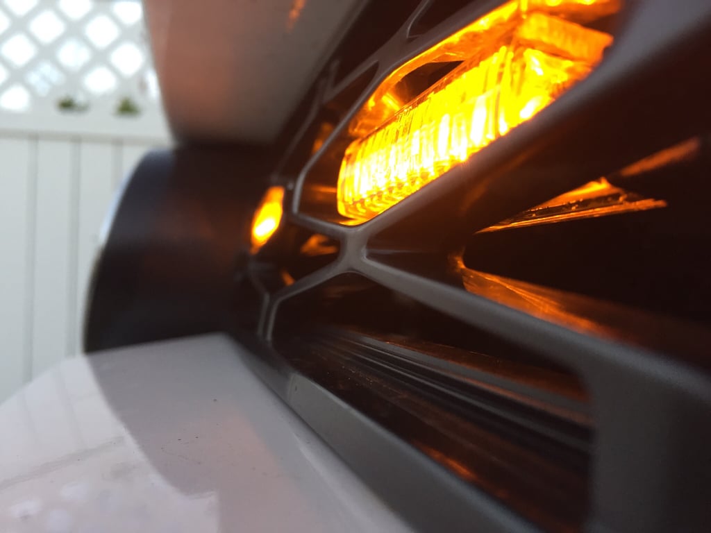

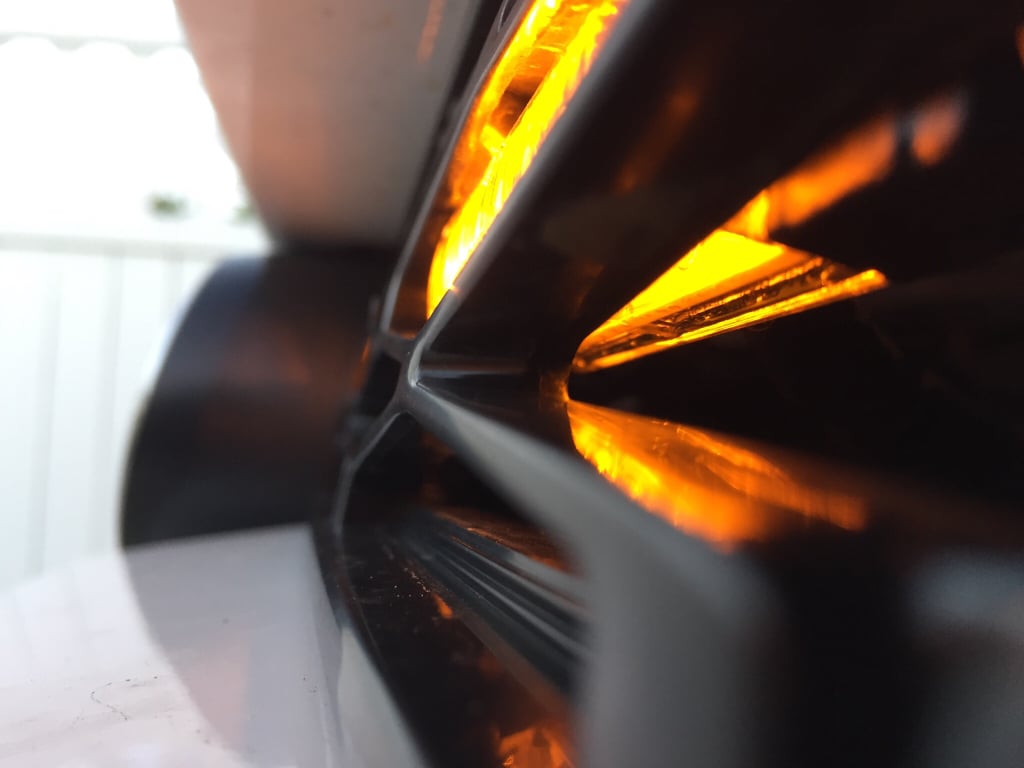

Cool, I'm good with no flash, nice touch getting them on your roof rack too. Yes they get good reviews, now I just have to decide whether to install 3 or 4. Maybe I'll start a poll...
:bolt:

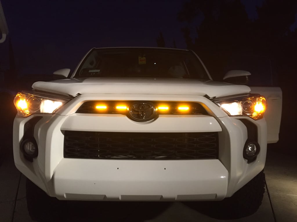

11mm Oznium Amber Bolt LED's
I think it looks better with 3 or 5. I installed 3 cause I think with 5 looks like I'm trying to hard, is a little more subtle with 3. Plus you can always install the additional two if you feel like it, but for me 3 was the winning number

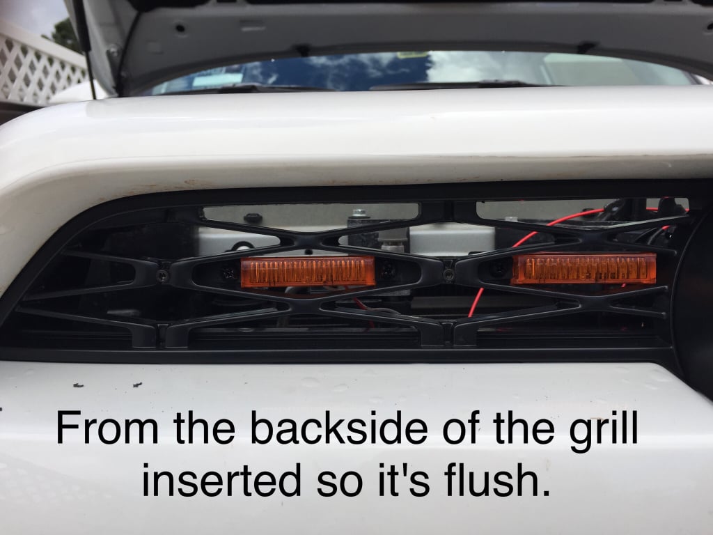

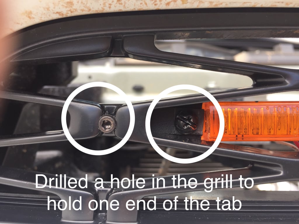

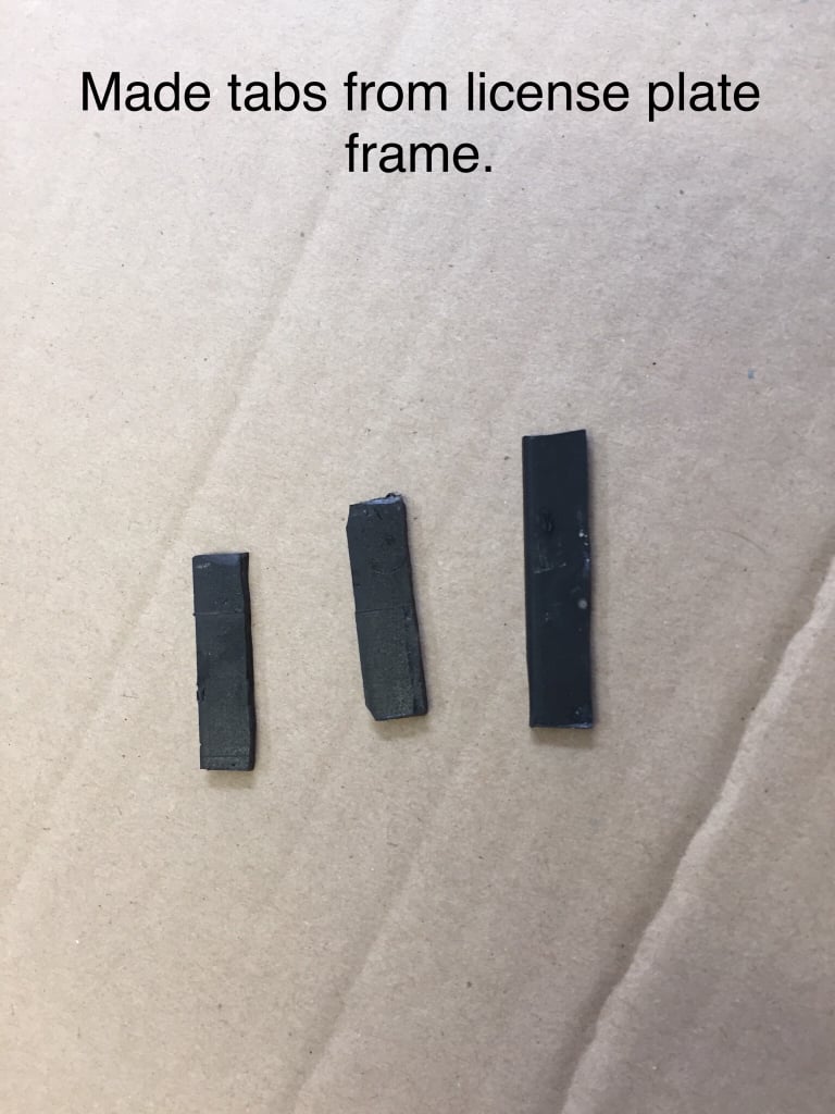

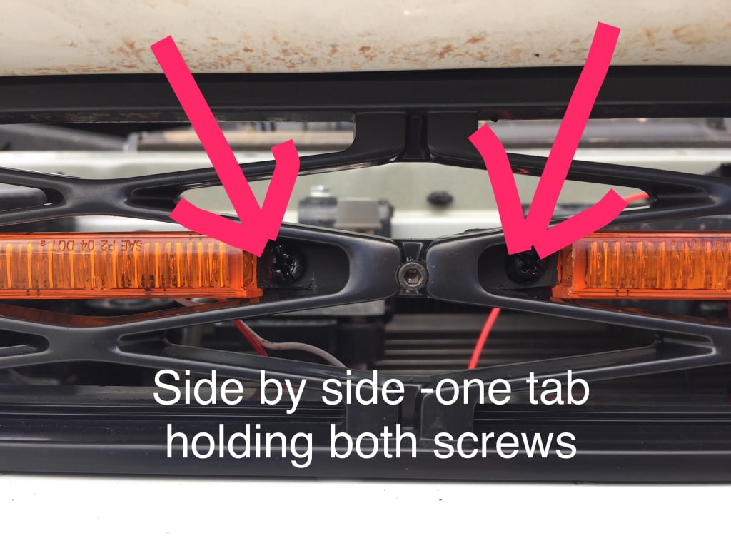

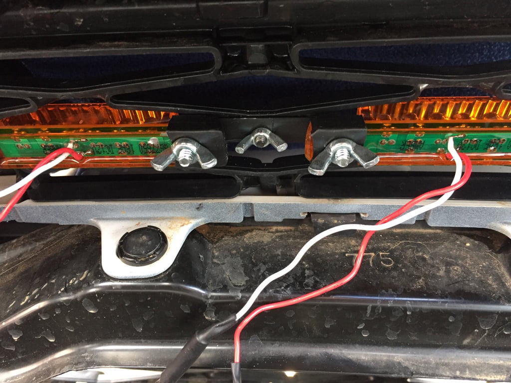

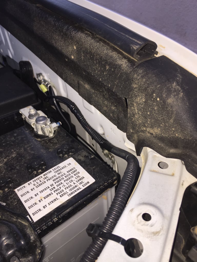

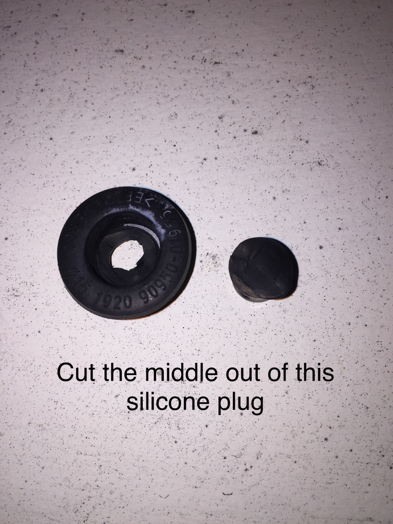

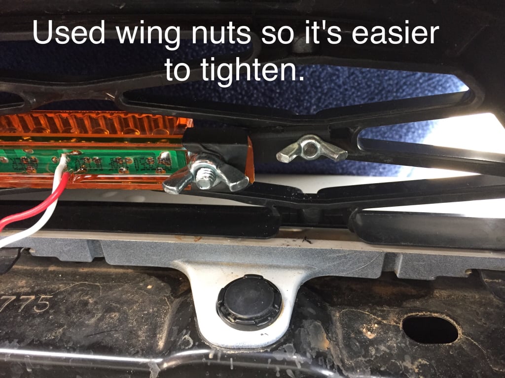

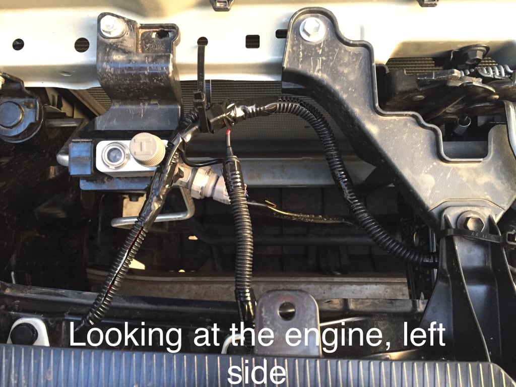

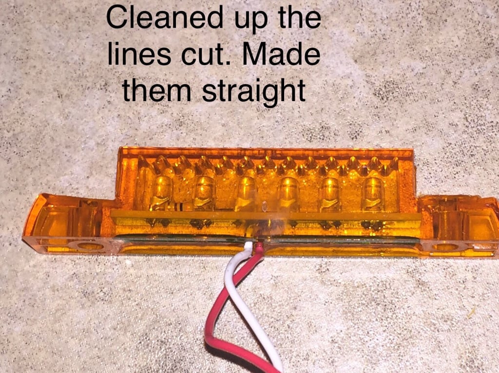

So I jumped on the band wagon and I installed the marker lights on my truck. I wanted something I can do and not pay for. I took RCO's advice on the install and incorporated with STORM RUNNERS advice on the tabs. This made the lights flush and not zip tied ( StormRunner Build & Adventure Thread- page 15).
Here is my voyage.

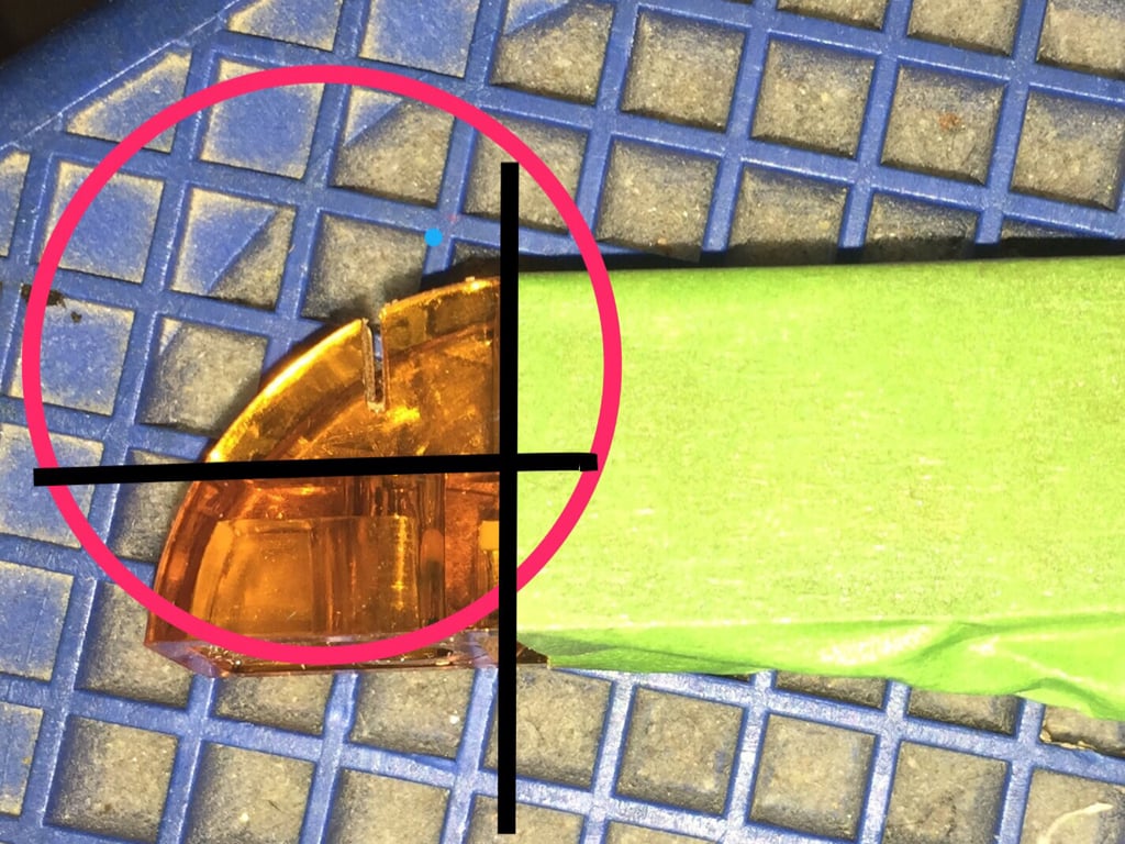

I used a dremel to cut the corners so they can be inserted from the back side.

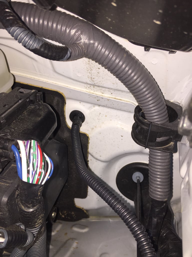

This black plug was on the fire wall. I pulled this out and cut the center of it. I used this hole to run the red wire to the add a circuit wire. This was to make a tighter fit and have some sort of waterproof protection just in case. I'm going to put some clear silicon around this as well just in case.

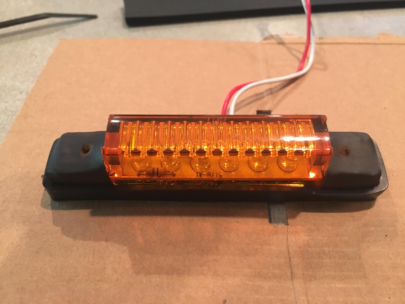

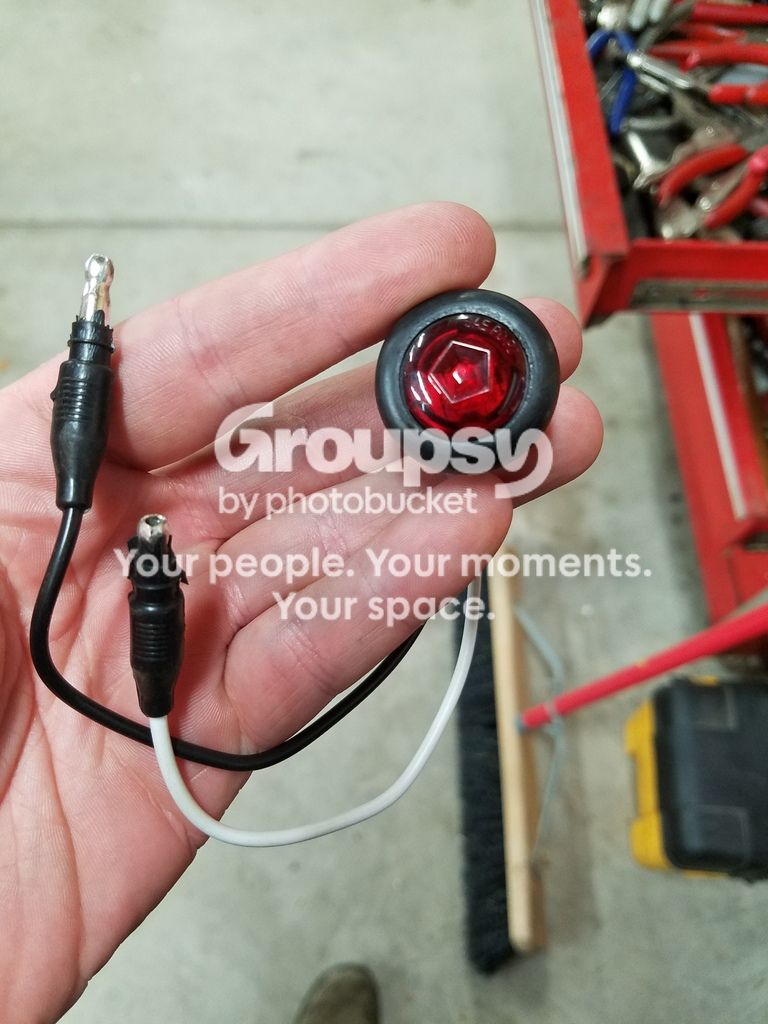

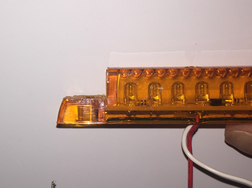

Sorry for the sideways pics... Had these LED trailer lights, looking like they might fit up pretty well. Not super bright. Bought a pack of 4 (2 red, 2 amber) off ebay last year for about nothing.
20170307_184631_zpsroporqri.jpg~original
20170307_184654_zpsbzeuf3tn.jpg~original
20170307_184711_zps1qjivhsj.jpg~original
20170307_184731_zpsfysqmaej.jpg~original

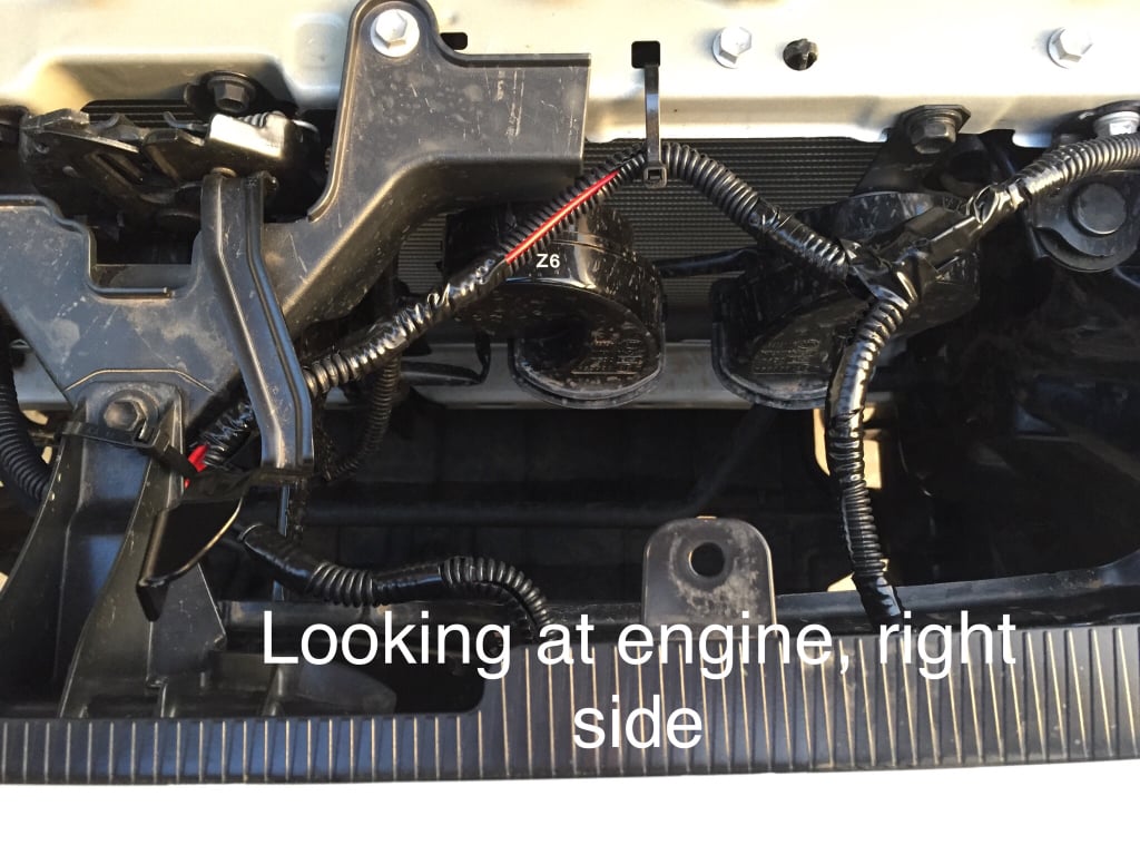

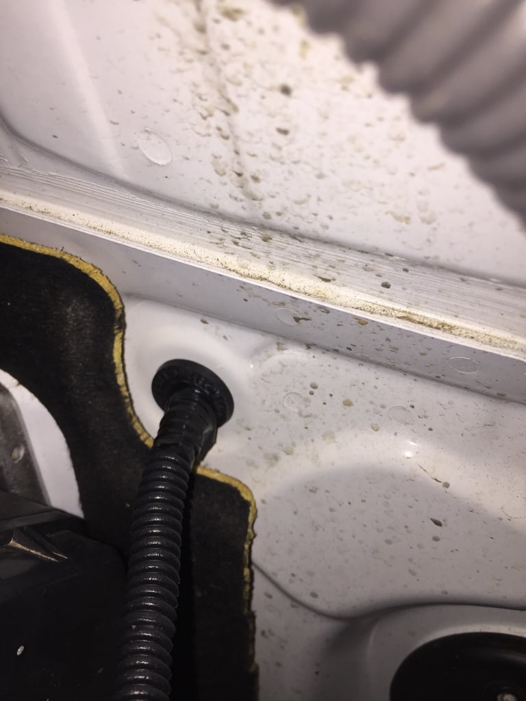

I got my 4 bolt leds and the add a fuse ready to go through the firewall. My question is where on the inside of the vehicle does that plug lead to? Is it a pain to fish the wires in there? Does anyone have a picture of where the wires pop through on the inside? Thanks.

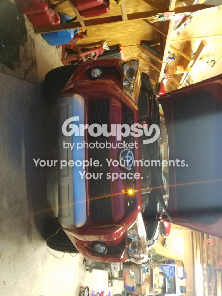

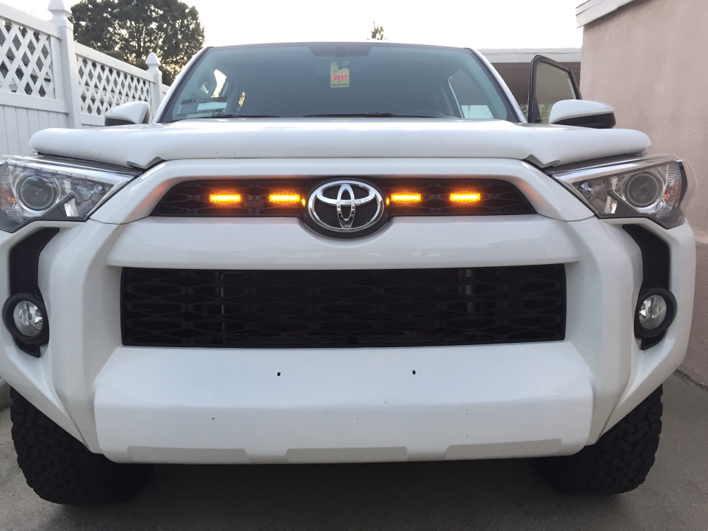

got my install done yesterday...
Nice codyHTX. I did the same trim for the flush mount.
