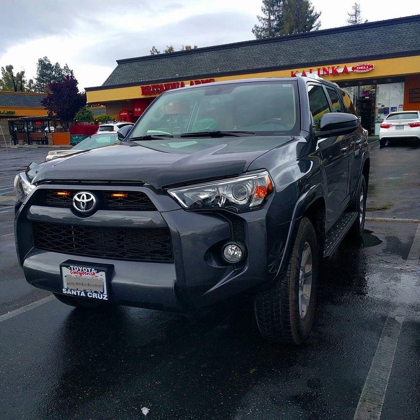

I like the look of these marker lights. I'm considering using possibly a few of them on each side next to my headlights as daytime running lights, to work like the DRL/turn signals on the 5th-gen 4Runners and 2nd-gen Tacoma's (examples below). However, I don't know how bright they actually are.
How visible are yours during the day compared to the ones on the 5th-gens and the second-gen tacomas like these below?
Do you think 2 of them on the left and two on the right would be as visible as those below?
Thanks in advance.

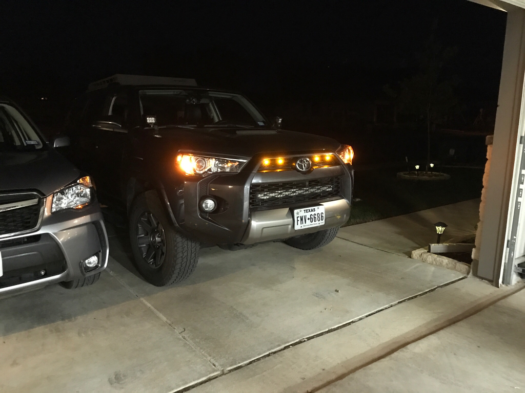

I am relocating my front-facing bumper-mounted turns (first-gen) to the corner marker location. I want to maintain front-facing visibility and this seems to be a clean and inexpensive solution.
Added two markers last weekend, closely following the RCO method without any issues. Thanks for all the inspiration!

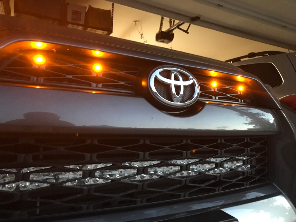

I think it looks better with 3 or 5. I installed 3 cause I think with 5 looks like I'm trying to hard, is a little more subtle with 3. Plus you can always install the additional two if you feel like it, but for me 3 was the winning number
1-2-5! 3 sir! 3! Boom!

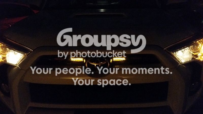

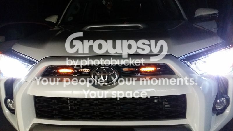

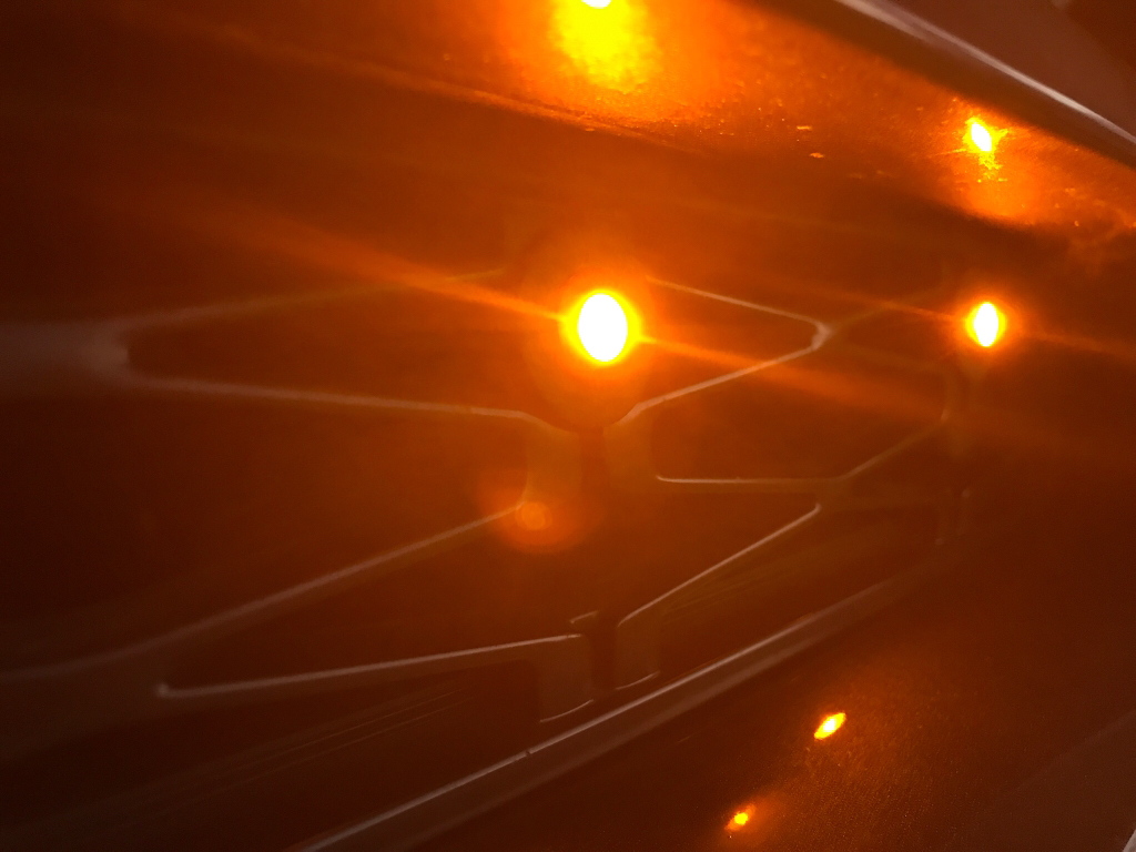

got my install done yesterday, combined [MENTION=57196]needsmoresalt[/MENTION] install using RCO's add a fuse method he posted earlier in this thread and parts of [MENTION=62757]chudiddy[/MENTION] install by shaving the light down around the ends, covering the excess with shrink wrap and installing from behind the grill through the slots.
note: using the RCO add-a-fuse method the lights are on when the key is in "ON" mode (not "ACC"), when the vehicle is started / remote-started, and when the parking brake is set (similar to the parking lights when p-brake is set - if parking/headlights are on).
they are independent of the light system all together, so even when the stalk is rotated to "OFF" they are still on. (this may matter to some who like to go full blackout-stalker mode when in that setting)
pics: 1st - DRL, 2nd - Low Beams, 3rd - remote-start w/ headlights on

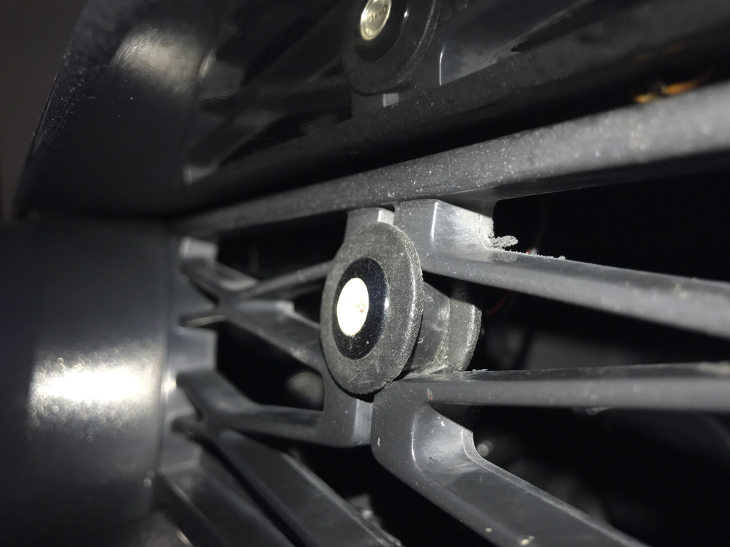

What size ozniums did you use?
I want to replace my eBay special marker, they keep burning out and are not very bright at all.
I did the 11mm bolts. Then I got some washers and painted them with rattle can bedliner. The washers grab onto the grill slots. My goal was to not modify the grill at all, but I did end up using a dremel on the back side to shave a little off. This was just for my own piece of mind as I wanted these to be a set and forget install.
I will try to get some closer pics this evening.
  • Like
Reactions: kuh
Did yiu use the 1Watt or the 3 Watt version of the bolt light?
Thanks
I do remember now that I used a plastic spacer in the middle to help line things up. I had these laying around. So, I unfortunately don't have a measurement on those.
