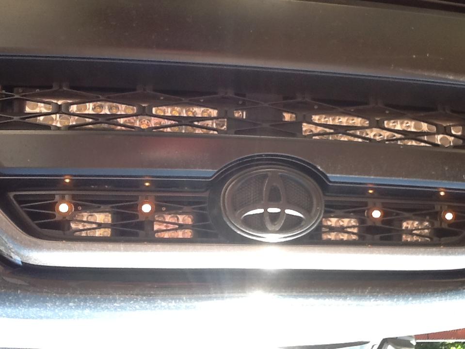

I used the Superbright LED bolts.

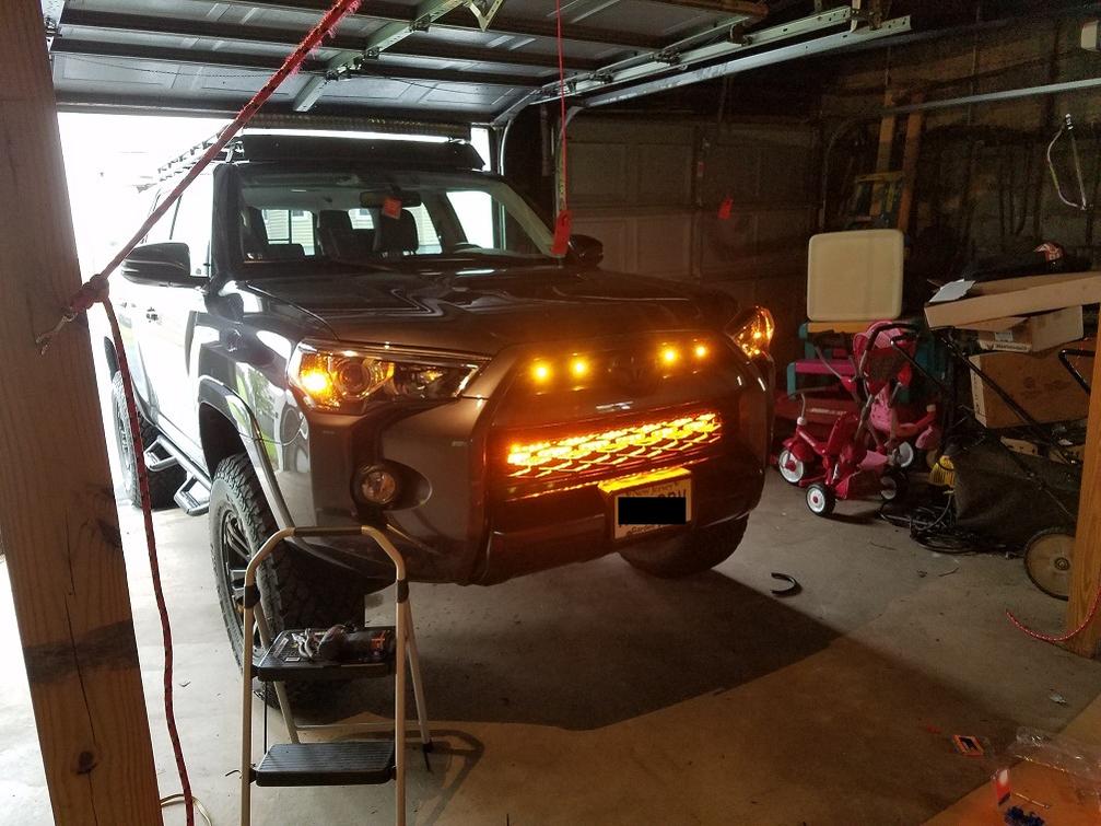

Install them and post pics. The mod is cheap and relatively easy to do. $13 for 10 eagle eyes and then a couple of bucks for splices and butt plug connectors.
The hardest part on mine was when I tapped the side markers. Should have pulled the head lights when I had the bumper off for the hidden light bar install.

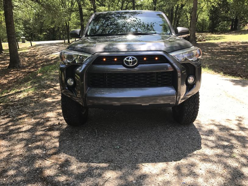

I used the cheapo Amazon LEDs for mine.
<a href="http://s1180.photobucket.com/user/travelintony/media/IMG_20161214_234956_zpsppnhmwtx.jpg.html" target="_blank"><img src="http://i1180.photobucket.com/albums/x412/travelintony/IMG_20161214_234956_zpsppnhmwtx.jpg" border="0" alt=" photo IMG_20161214_234956_zpsppnhmwtx.jpg"/></a>
<a href="http://s1180.photobucket.com/user/travelintony/media/IMG_20170528_155610_zpsxjkfxm7s.jpg.html" target="_blank"><img src="http://i1180.photobucket.com/albums/x412/travelintony/IMG_20170528_155610_zpsxjkfxm7s.jpg" border="0" alt=" photo IMG_20170528_155610_zpsxjkfxm7s.jpg"/></a>

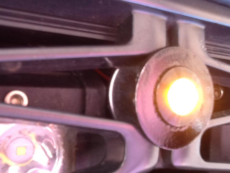

Replaced my Amazon cheap lights for oznium 11mm 1 watt amber. Got the sizing from tacoma007.
The cheap lights were either burning out, moisture or just going dim over time. That's why they were less than a dollar.
Used two 3/8" spray painted black washers to hold the lights in place. Overall a lot cleaner and brighter look

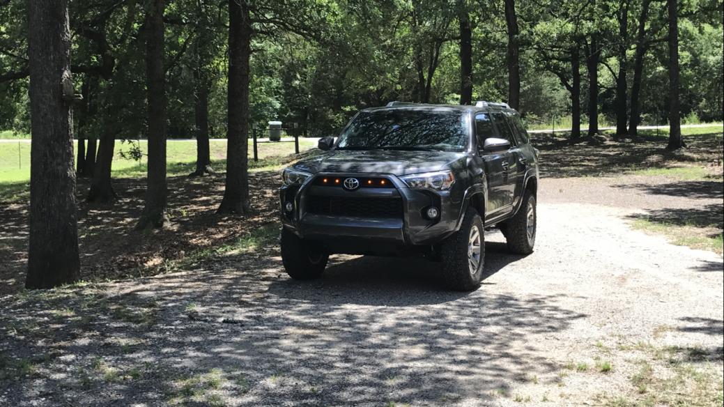

Here's a daytime shot of all 4lights
Sorry didn't realize the photos were upside down.
