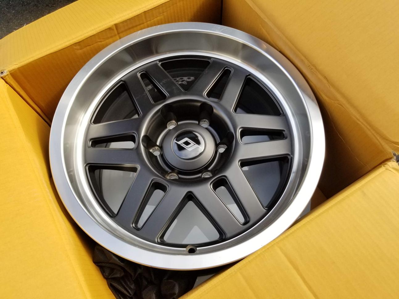

Big thanks to Vin [MENTION=88453]SCSPerformance[/MENTION] for selling me this set of SCS Stealth 6 in Matte Black w/ Machined Lip. They came off one of his personal vehicles. 17" x 8.5" and in overall good condition. Will post more pics once they're on my rig.

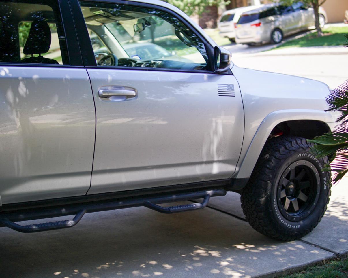

SCS SR8s wrapped in 275/70R17 KO2s. 55k miles on the tires but upgrading to 285 Ridge Grapplers next week!
