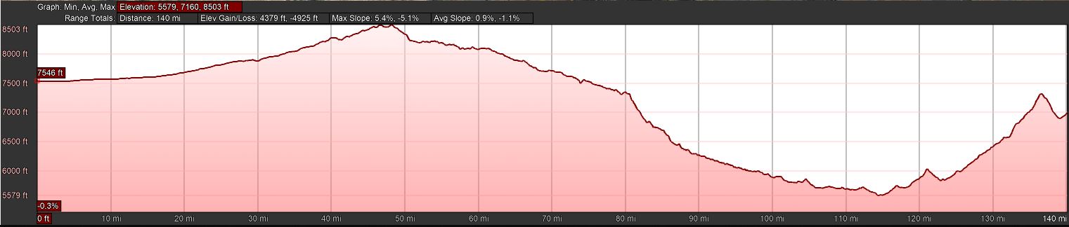

Tail wind and slightly down hill. Turn around, go back, average the results.
Yup. Slight gradual decline for the first 45 miles, then 70 miles of constant downhill, will give you excellent MPG every time.
