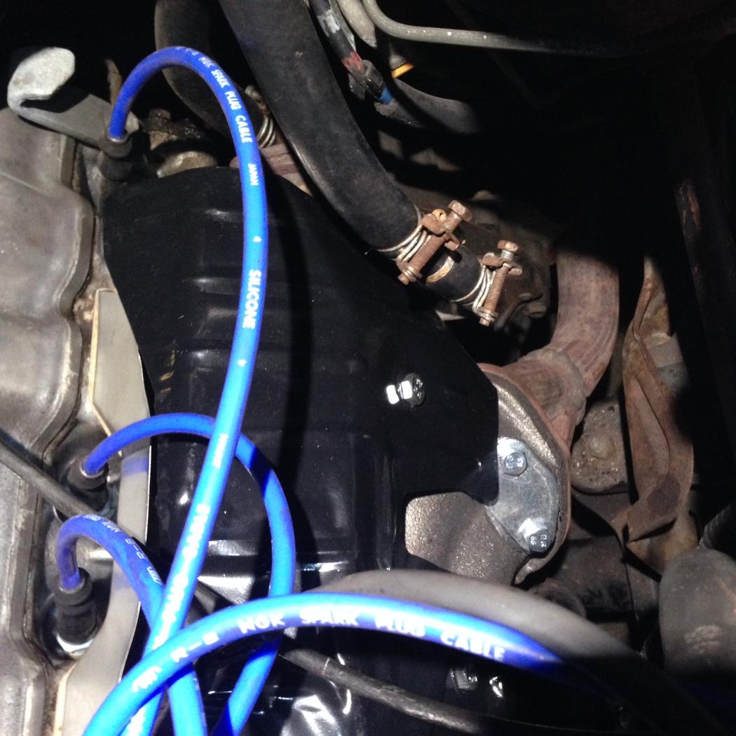

Got the new manifold in place last night. Much more difficult job than I thought it would be! I also didn't realize that my truck was supposed to have a factory heat shield.
Truck runs fine but I can't tell if the exhaust leak is gone. Also when I started it up the first time I got some smoke from this block off plate. My factory manifold didn't have one and I assume this is for an additional 02 sensor in another model?
Anyway, with a second start up this morning I still got a tiny bit of smoke from that little plate as well as a faint smoky odor. This is the little bugger in question.

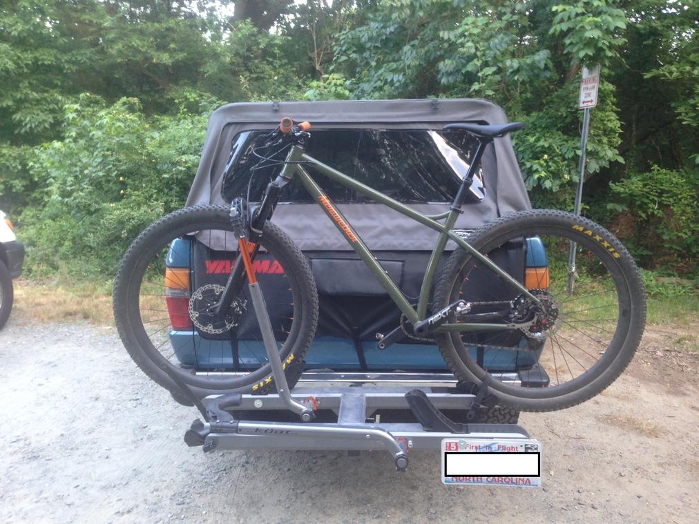

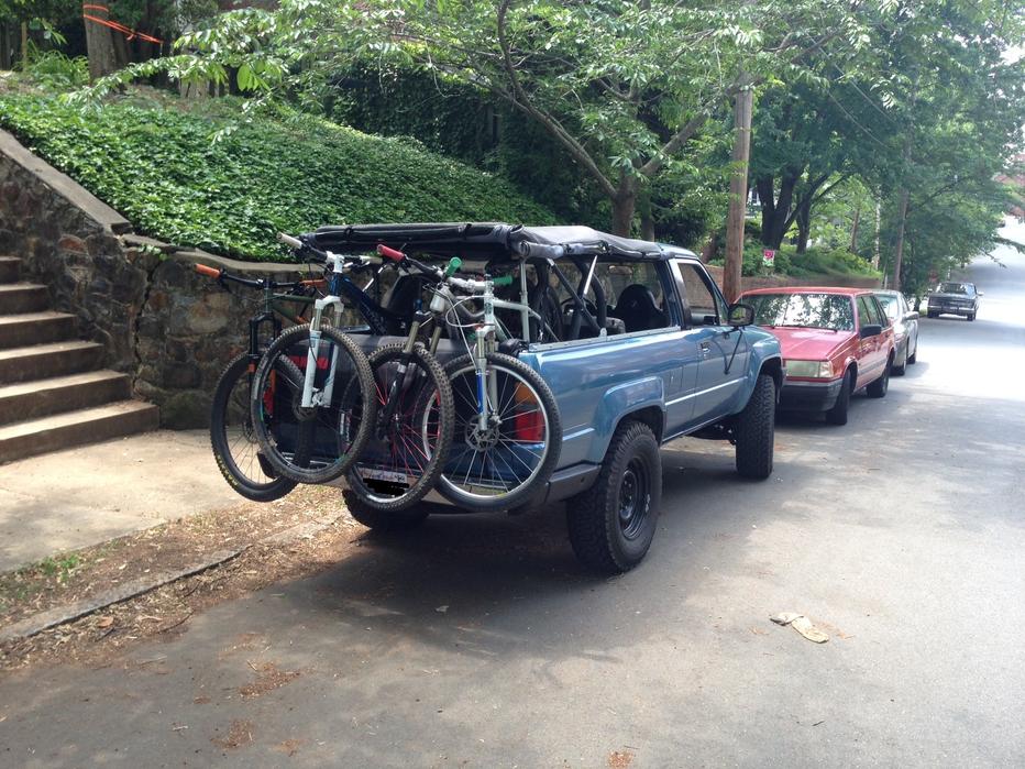

I also got the hitch and bike rack installed. Bad news is it won't clear the 265-75-16 spare. About 1.5-2" too tight. Will need to find a way to modify the hitch to fit or switch to a tube bumper with integrated hitch. I want to continue to store the spare underneath.
If I could get a tubular center section for the hitch that curved outward slightly it would work well. Don't have a welder or know someone with fab skills though. Seems like it'd be simple enough.

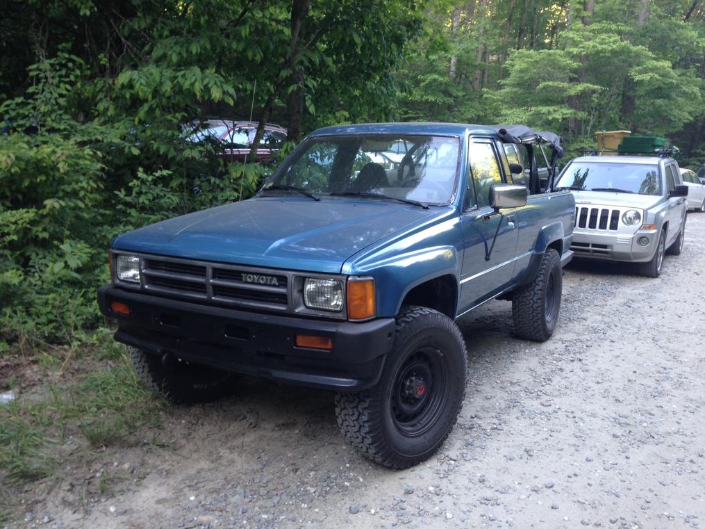

Truck was a lot of fun camping in Pisgah last weekend!
Fighting the crowds last Saturday in Pisgah! Great camping rig.
Also bike transport solutions: Yakima pad works great on the tailgate and was only $70 from backcountry. Can fit four bikes and four passengers but not much else. Got a great deal on a kuat rack which is fantastic however, I can't get the tailgate all the way down with it installed. Had to try a couple of license plate relocates too.

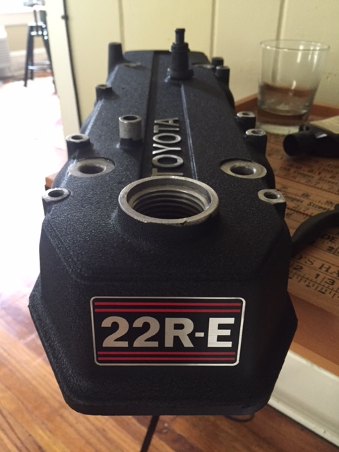

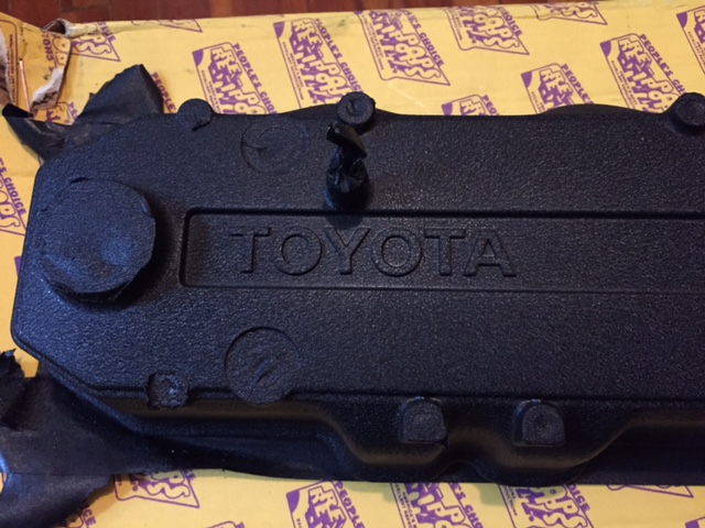

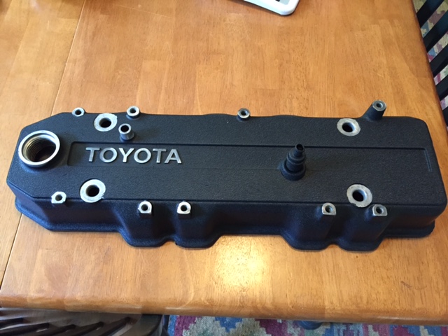

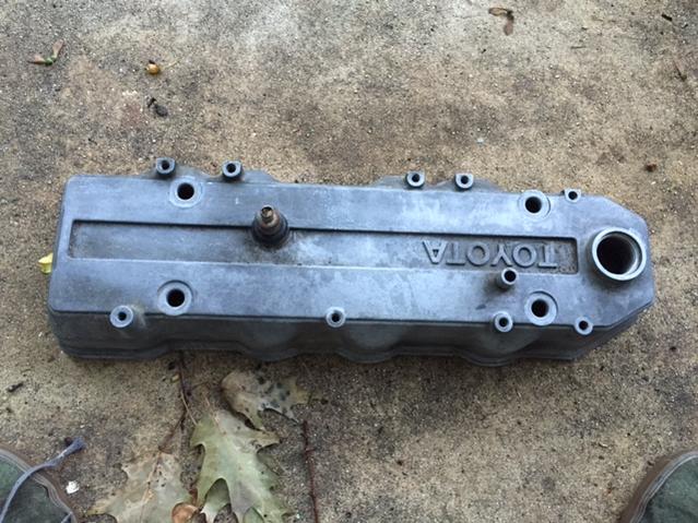

It's almost time for the engine swap! To occupy my time waiting for the new motor I got me a $19 valve cover on ebay to dress up. Shot some $8.99 VHT wrinkle paint and a new sticker on it and I must say, I'm pretty pleased. Will actually make it look like I put something new under there!
Other parts are accumulating, clutch, header, fuel filter, belts, vacuum hoses, thermostat, distributor cap, etc. I'm spending too much money but I want to do it all right while I have the motor out of the truck. More updates next week.
