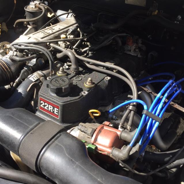

The valve cover is pretty. To get the shiny letters did you sand the wrinkle paint off? Was it that simple?
Yeah pretty much, I taped up all the bolt/vacuum holes and then I sanded the letters clean with a sanding block and a brass wire wheel on my rotary tool. It was a bit harder than I thought though, paint seems tough.

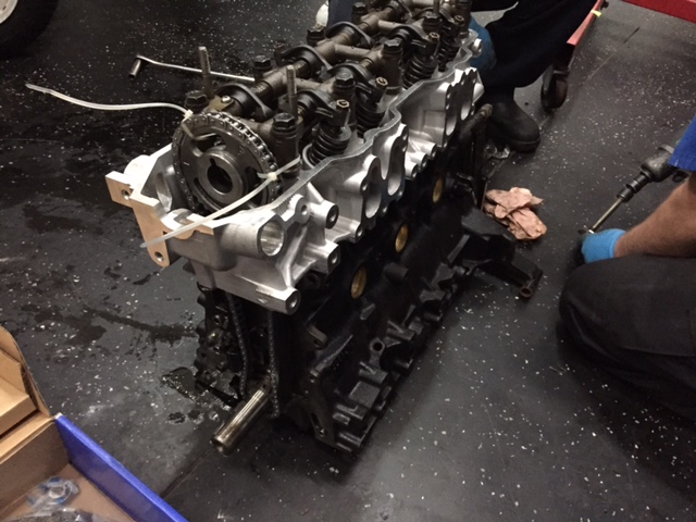

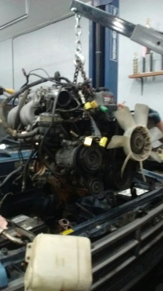

Heart Transplant

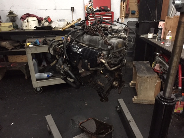

Hate how long this has taken me to do but we're finally getting through the motor swap!!!

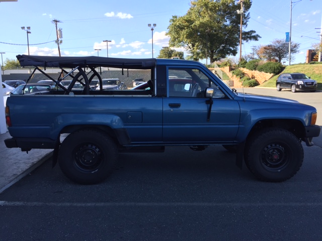

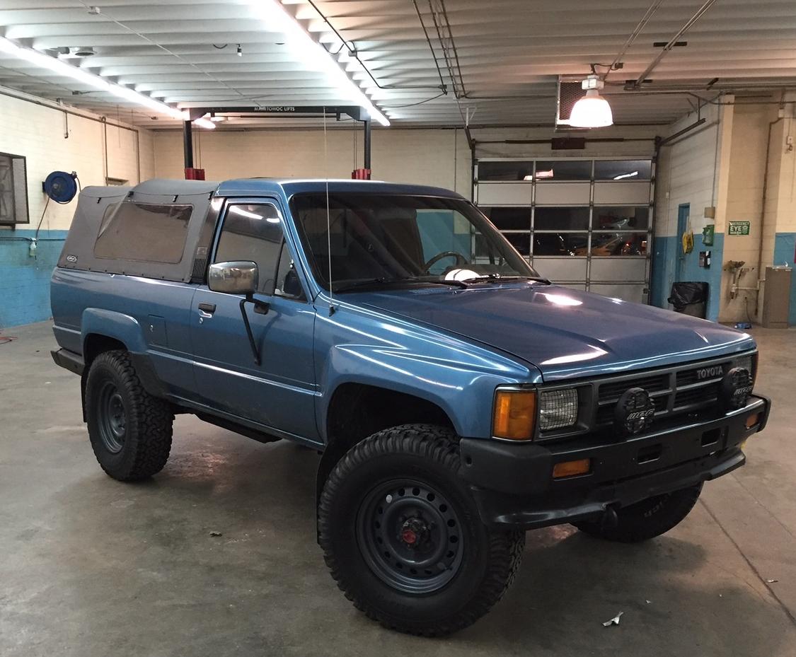

Engine swap and new 2.25" exhaust all done! Love having the truck back on the road! Lots to address now with the interior, suspension, and minor exterior cosmetics.

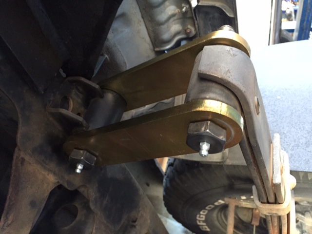

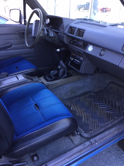

Some All-Pro Shackles on the back fixes that saggy rear. Difficult to see in the pics but they gave me about 1.5" of lift. Plus I put in some carpeting and replacement back seats! Things are startin to shape up!

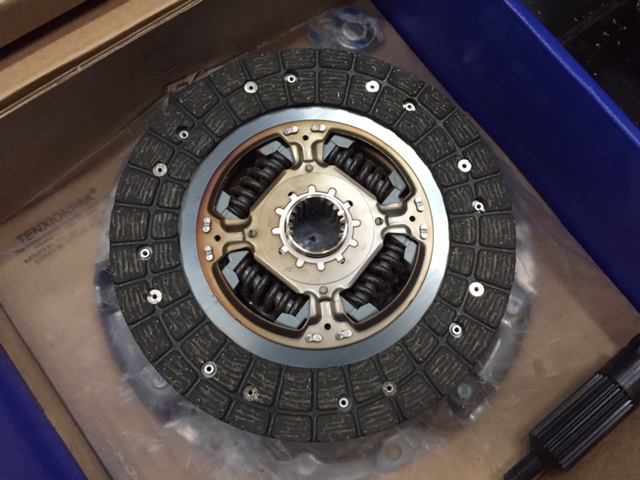

I'm starting to think this truck is cursed! Drove out to Brevard for the weekend, driving great Friday and Saturday, but on Sunday, I could not get it into 1st or reverse. Clutch was totally inop and even though I didn't notice any dripping fluid, my clutch master cylinder was bone dry. I had to limp it home with no clutch doing my best to rev-match shifting but still grinding some gears. Really hope I didn't hurt anything!
Ordered a new master cylinder and slave cylinder as both of them look pretty rusty and ancient. I just want like 1 month without some kind of failure!

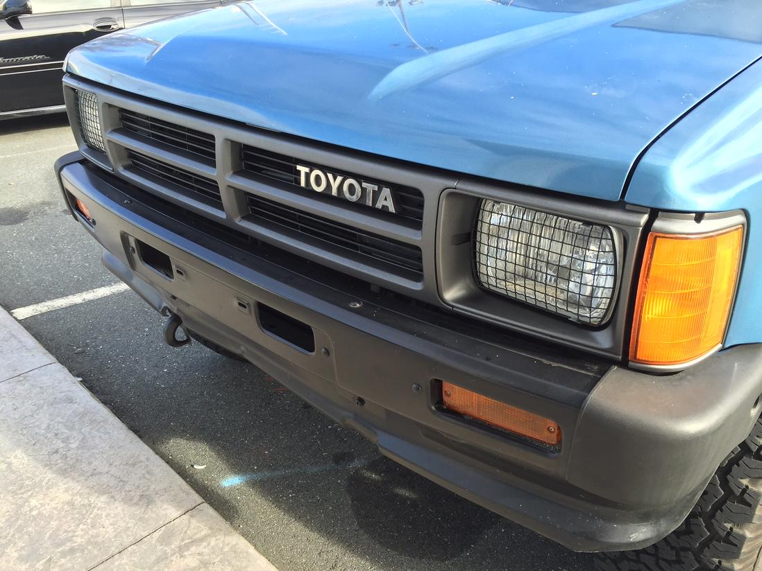

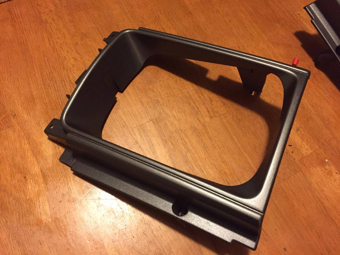

Decided to repaint the old grill and headlight buckets. Went with a duplicator spray paint. Turned out a little darker than I think was stock but I don't really mind. I think it looks pretty nice but we'll see when I reinstall tomorrow in the daylight.
I think it turned out pretty good though I wish the paint wasn't quite so dark, also managed to break one of the old brittle clips holding the grill on. Need to find a new one. Valance on the way from ebay to replace the crunched one, it was pretty darn cheap, just 29.99.

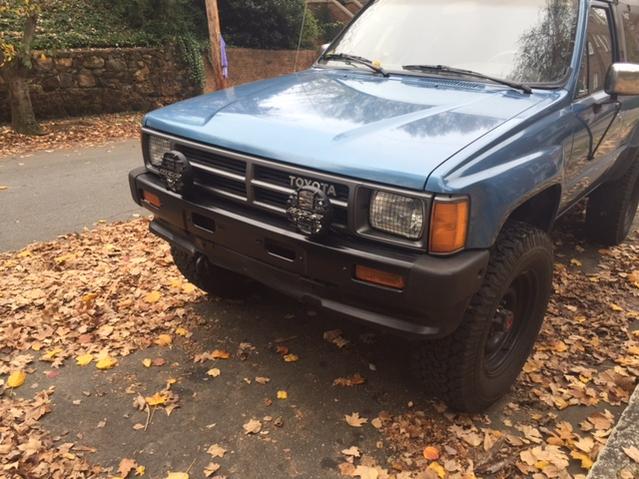

Got my IPF's mounted up but not wired yet, was surprise to find the factory bumper already had holes in a nice location, just needed to bore them out slightly. Lights bolted right up and I will have a go at wiring them this evening.

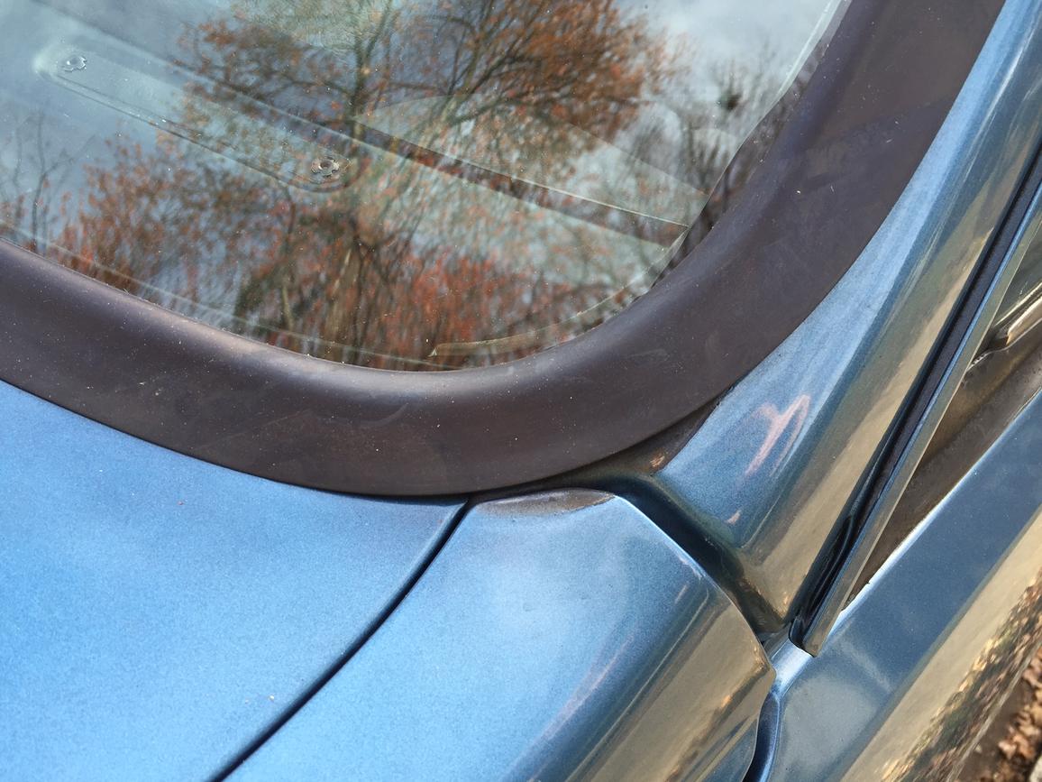

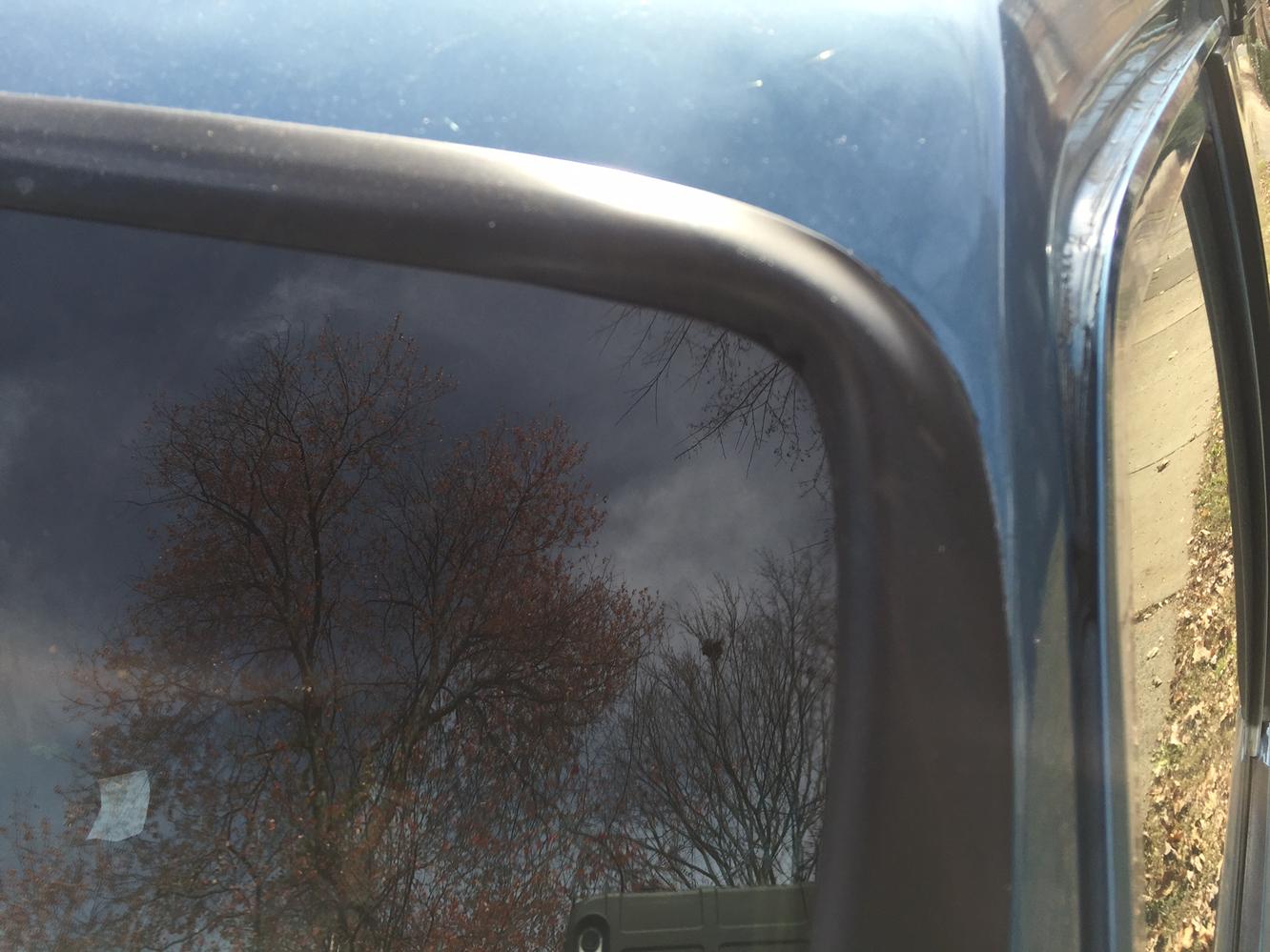

Also, did a windshield swap through a guy at work. Ended up getting it super cheap. He wasn't 100% satisfied with how the rubber trim turned out and to be honest neither am I, but I couldn't find a full set of trim for a reasonable price anywhere so this is the best solution. Can see so much better at night without pitted, scratched up glass.

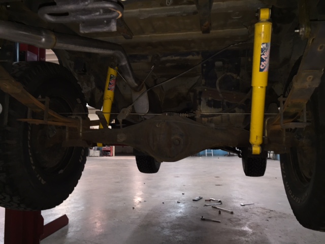

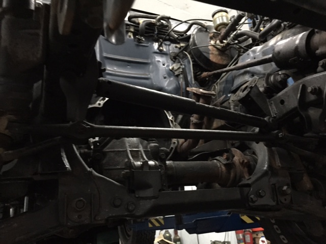

Got some lift time last night at work! I guess I didn't really need it for the work I was doing but it did let me get a good look around under there and so a little bit of underbody painting. I also determined that my leak seems to be coming from the front diff and not the engine, (I think). Got to get that addressed.

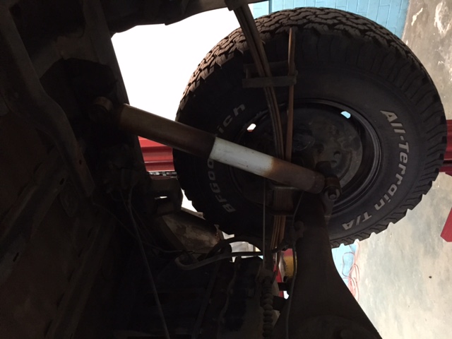

I replaced my rear shocks with some OME's I picked up on the (very) cheap. I wanted to do the fronts as well but needed a 22mm box wrench as I could not get a socket on the rear lower shock bolt. Hopefully will pick one up today and get the job done.

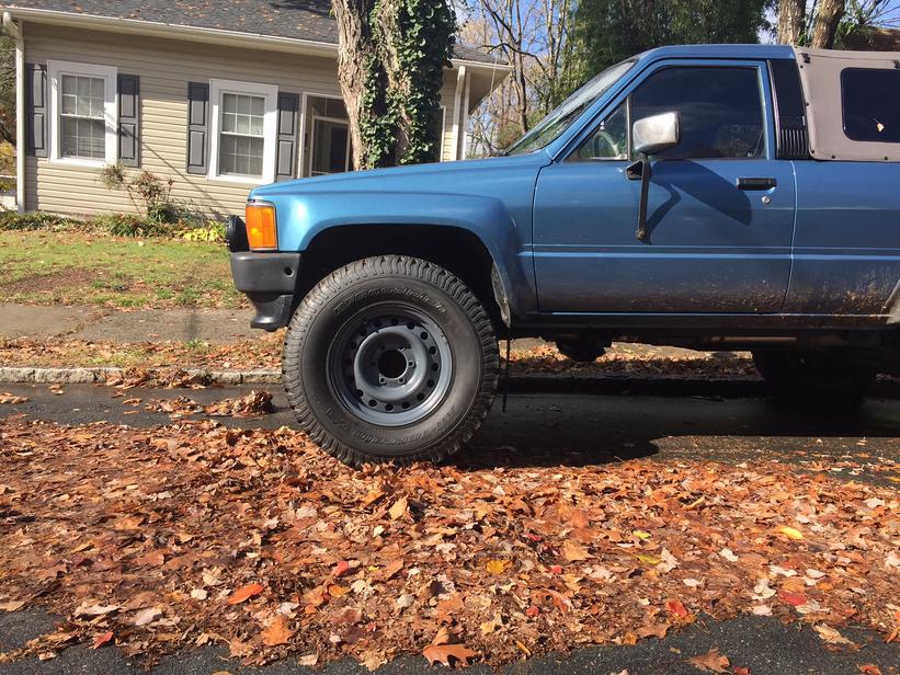

Finally finished plasti-dipping my wheels gray. It was a quick and easy job and the finish is actually quite good. Couldn't resist a glamour shot as the truck looked pretty cool in the shop at night.
