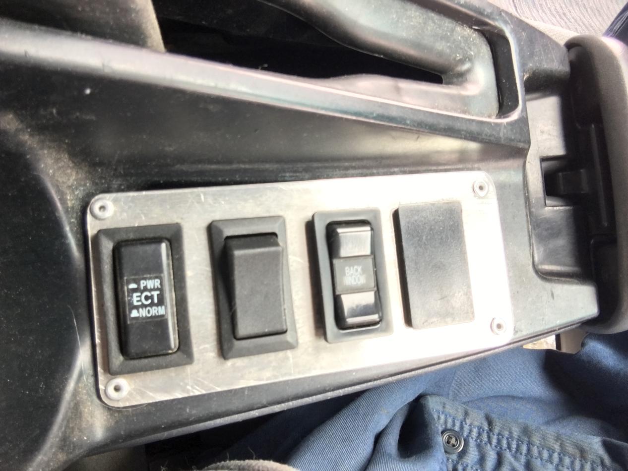

I didn't really want to move my switches when changing to the newer center console, so I didn't.
I made a little panel from a piece of aluminum. I cut out the switch holes with my scroll saw (was a pain!), cut out the little hole/space/dirt collector spot on the newer console, and then used pop rivets to hold it there.
There is one empty space, and the middle one is for my antenna... since I rarely listen to the radio I mostly leave it down, and I can use the switch to put it up when I want.
Far from perfect, and at least my switches are still right there at my fingertips.
Steve

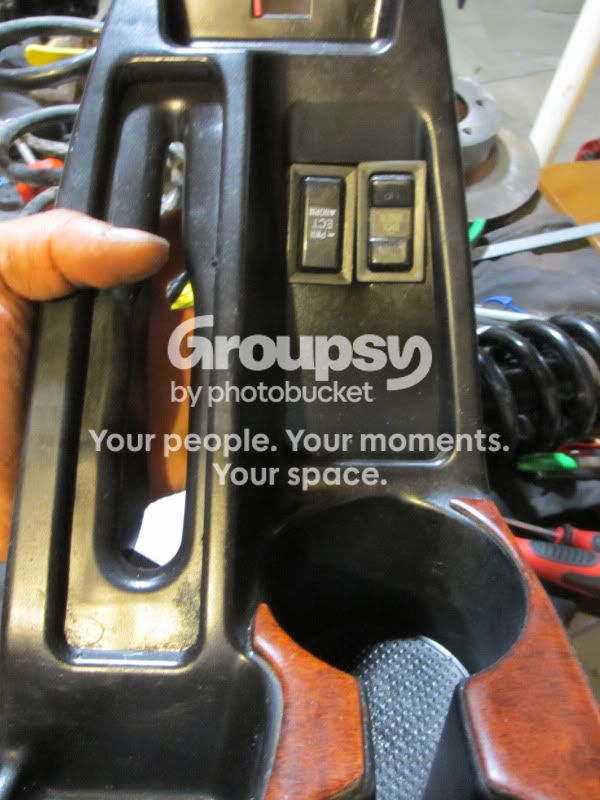

I found a local 2000 being parted out. I'm going to go get the drive shaft for myself and he told me the interior is decent. Would anyone be interested in a console/cupholder? If so, I think I can pick it up and ship it. It may be $50-$75 or something like that, I'll check to be sure. I asked him to send me pictures so I'll also post them when I get them. I'm getting the DS tomorrow so I can pick this up also.
Around noon or so, I'm picking up a drive shaft, so let me know if anyone wants this.
