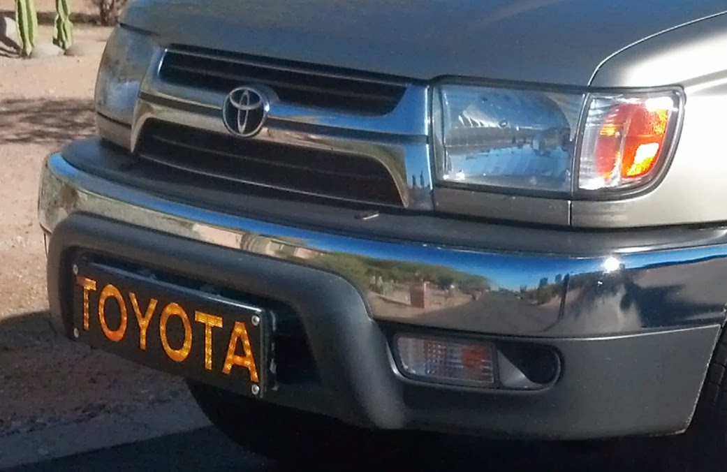

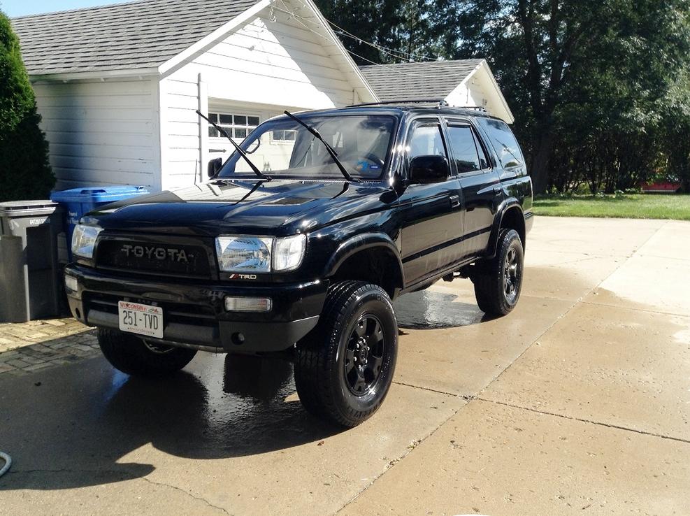

whats the deal with the recall? Also sick toyota grille, I made an led plate from scratch and I made a cover for it that is clear amber, so in the city I just run that on top of it and it lights up with a big orange toyota.
Thats pretty cool man. Definately creative

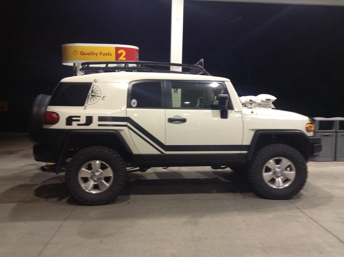

Super cool FJ Cruiser I pulled up next to at the gas station tonight. I got talking to the guy for a bit. He did the graphics himself with auto vinyl. I think it looks sleek and unique.

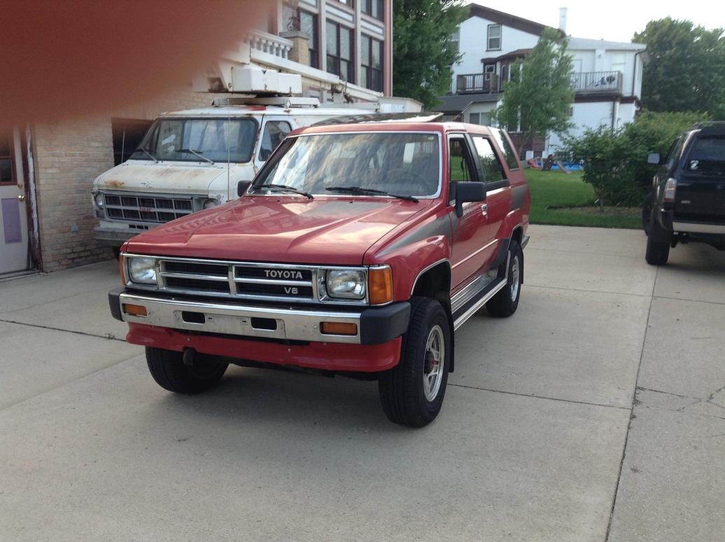

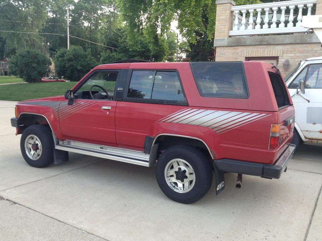

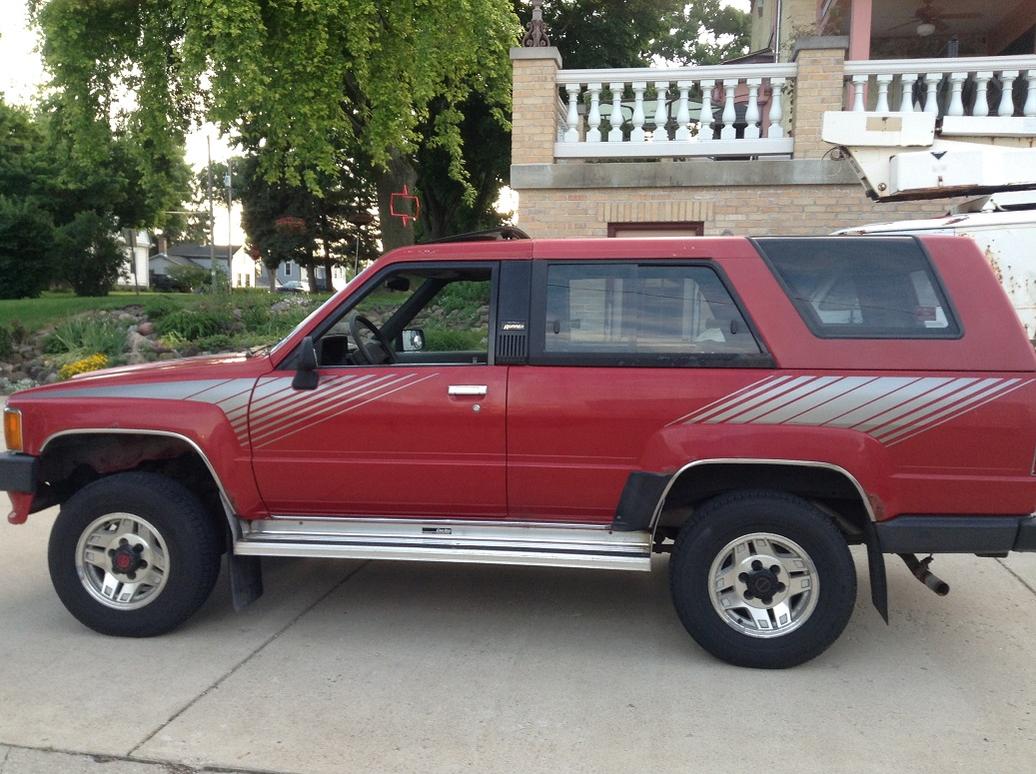

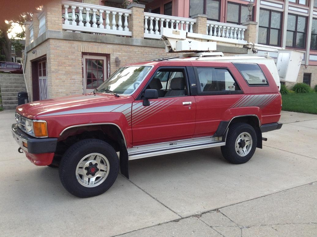

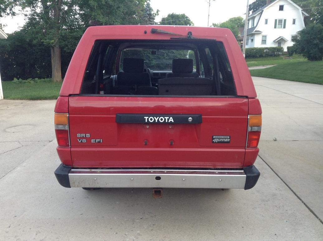

My new Toy. 1988 4runner. 3.0L. Manual. 4x4. 211000 miles with the engine rebuilt at 120000 via the recall for the head gasket. Interior is almost mint. All stock and very well maintained and was originally a California truck. Though, the salt has done a number on it in its time here in WI. Im planning on doing a full restoration over the next year or so.
I was very impressed with how it drove and handled on the highway at 70mph. No rattles or vibrations, fairly quiet, and has a lot more pep than I expected for 150hp. Stick shift is awesome! Its been years since Ive owned a manual.

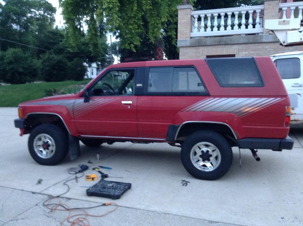

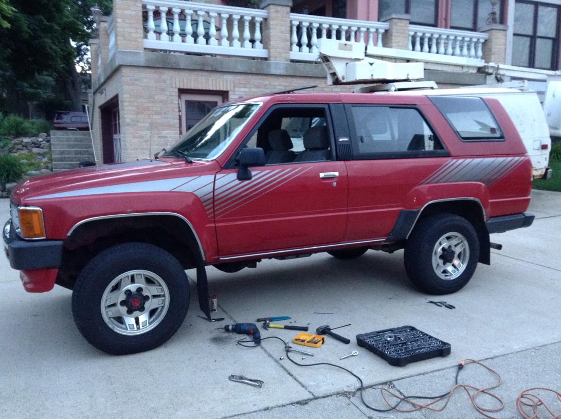

Running boards off.

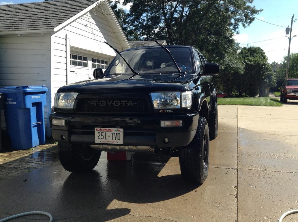

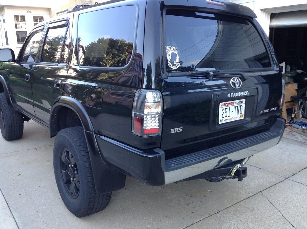

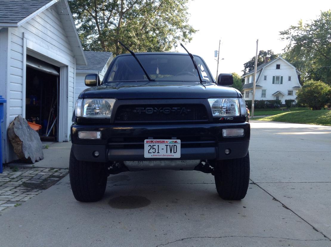

It's kinda been forever since Ive posted here, so I figured I would give an update on Jitters as I actually have a lot going on with it right now.
New tail lights as of the beginning of the summer. The leds are a ton brighter than my old bulbs.

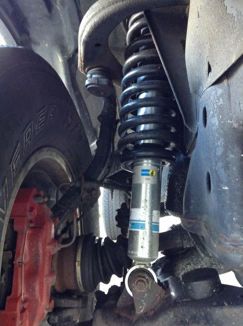

Switched out the Tundra setup with Taco 5100s and stock 99 coils. Set on the highest perch, this actually gave me another inch over the Tundra setup, and rides so much nicer. Still running OME 890s with LC shocks in the back. By the way my Tundra setup (around 130k miles) is now for sale.
Right now I also have a plethora of parts sitting in the garage ready to be installed, when I get the chance. To include . . .
-New Safari LTD steering rack with poly bushings
-Low mileage power steering pump
-New OEM rod ends
-New OEM upper ball joints
-Plugs and wires
-Diff drop
-Used OEM cv's
-Bumper valance color matched black
-Sport flares color matched black
And Jitters still looks amazing at 229000 miles and four Midwest winters.

Just gotta say I love what you've done to your 4runner.... I have a couple questions.... What did you use as a rust converter and paint for rust protecting the undercarriage of your truck? How has it held up? I live in Canada and badly need to do this to mine while its still clean underneath. Also if you could clarify.... how much lift would you say you currently have over stock height with the 99/bilstiens, and the 890/LC's.... and how is the ride compared to stock?? I Would assume the 99/bilstiens would ride quite nice, but I've heard that the 890's can ride really rough and stiff.
And also I love that 88 4runner... They just look so fun.
Hey thanks for the compliments!
For the rust converter I used a brush on solution from PlastiKote. Then I covered that with rustoleum black enamel. But honestly it hasn't held up that well. I think that's because plasikote is a cheaper product, and I didn't do quite enough prep work. I would recommend going on eastwood.com and looking through their rust prevention products. They have a ton of great products. There are quite a few choices for rust converters/encapsulators these days.
My lift is around 2.5" in the front and 3" in the back in those pictures. The ride up front is great with the 99 coils/5100s. The 890s work quite well and I don't have a single complaint about them paired with the lc shocks. They are stiffer than stock Im sure, but probably not by much. Though it is impossible for me to say at this point as its been 3 years since Ive had OEM rear coils. But before the 890s I ran Performance Products coils with KYB gas shocks, followed by LC 7 wraps with the lc shocks, and the 890s ride better than both of those at stock weight. A lot of members use and like the lc coils, but they were WAY too tall for me. Im talking 4.5" of lift.
I am actually going to be changing my rear setup this weekend. I ordered 99 rear coils to match the fronts, and a 1.5" spacer to match the height with the front. I would keep the 890s, but I don't like the offset of the rear axle, and I don't want to pay for an adjustable panhard bar. So Ill have my 890s up for sale soon. If you are interested in them let me know!
