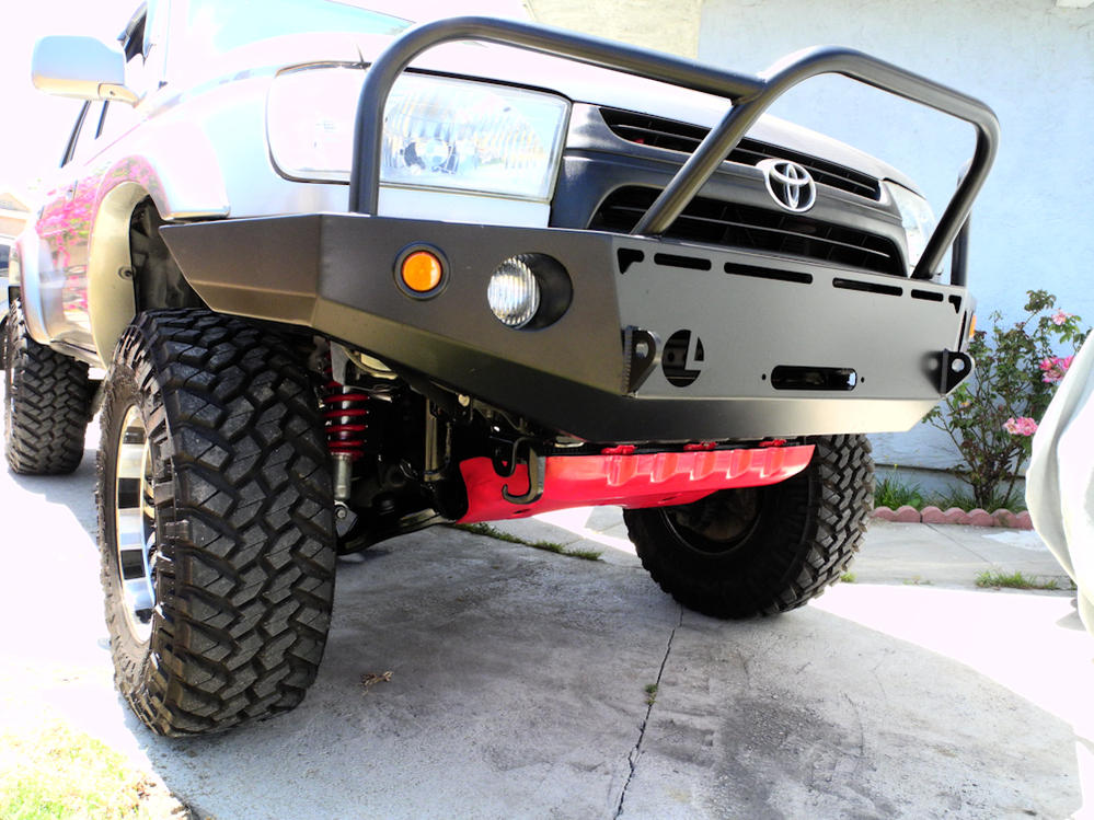

Just a painted red stock skid plate >.< lawlz
You may not be active anymore, but any more info on how you painted the skid plate? It looks sick, and I would do this in a heart beat! Any cleaning/pre coats? And what paint did you use?
http://www.toyota-4runner.org/attachments/3rd-gen-t4rs/48629d1312759896-real-corny-build-thread-20110807-dscn2968.jpg
haha i'm still active, just haven't had any money to update anything on my rig.
stock skid is 2 piece and you have to remove the "front" skid first which is like 3 bolts up front then like another 2 or so in the back; once that's off there's another plate you remove which is more of the same bolts. take those off and it should come right out.
But depending on your truck the bolts might be tough to take off, so have some WD-40 ready ahha. Also i just washed off all the grease and dirt before painting it with some rust-o-leum engine enamel spray paint. wasn't too picky with my paint or prep because at the end of the day its just a skid plate on the bottom of the rig. good luck! :D
