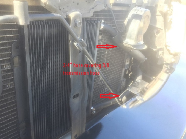

The included 5/16 hose does reach from the transmission return line (driver's side) to the cooler with a couple feet to spare. It's OK to use that diameter right? There aren't any complicating issues from using a slightly smaller diameter as far as pressure on the system or anything? I'm going to order 5 feet of 3/8" transmission/oil hose from Amazon for the cooler return to metal hardline on the transmission. Does this stuff look OK to you all? https://www.amazon.com/Derale-13016-Transmission-Engine-Hose/dp/B004XONNTE Oh and since I'm ordering, I'm getting the filter you recommended too.
Thanks!
Is yours mounted on the drivers side? I can't tell from that sentence, but if so, that's what I'll be attempting too!

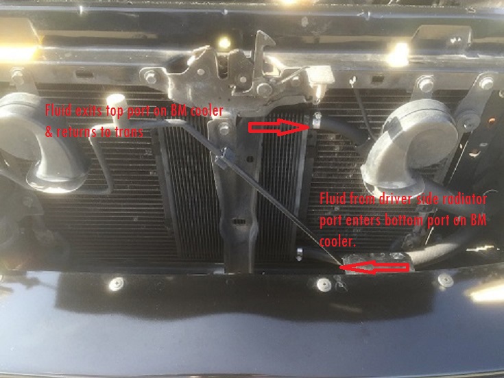

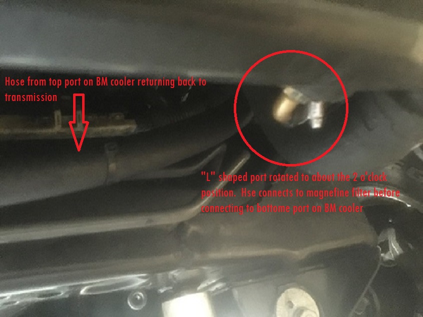

The cooler is mounted in the middle of my AC condenser with the ports facing the driver side.
I was also thinking of going that route but when I read a write-up from [MENTION=78997]Drcoffee[/MENTION] saying he had to bend the driver side L-shaped cooler fitting a little to clear the fan shroud, I decided to run the lines to the passenger side. I didn't like the idea of cranking on that fitting, because any time you bend metal, you fatigue it and increase the chances of it cracking. You obviously just can't point the fitting towards the 3 o'clock position because the lower radiator hose connection is in the way. Did you have to bend the fitting to clear the fan shroud to have it at the 2 o'clock position?
Any chance you could share some pictures of how you ran your lines? I'm sure people would appreciate seeing how you did it.

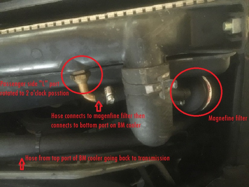

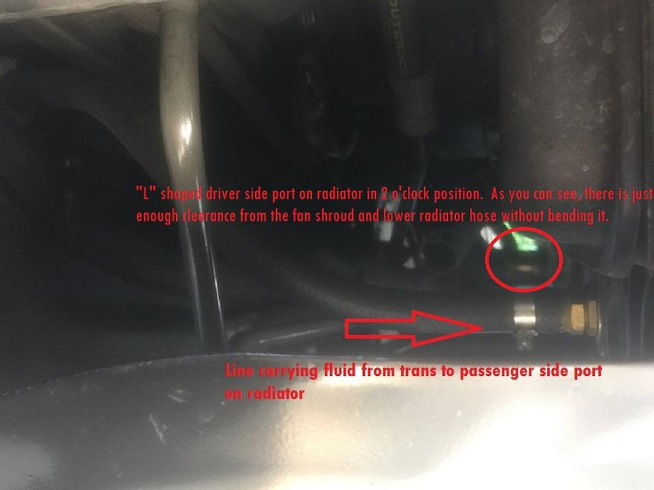

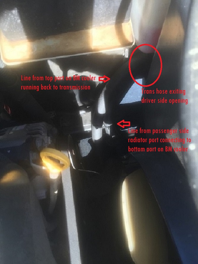

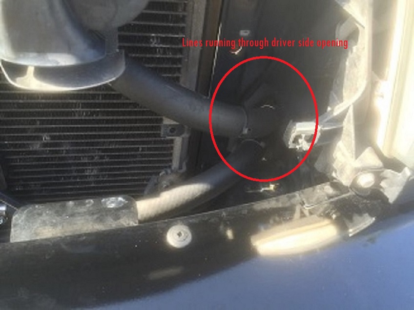

I did not bend the L shaped fitting. In the 2 o'clock position, it give me just enough clearance from the lower radiator hose and fan shroud.
Some pics of how I mounted my B&M cooler and how I ran my lines. I mounted it in the middle of the condenser in order to give my ac condenser a little more exposure for airflow coverage. The drawback is that the bar in the middle is blocking some airflow to my B&M cooler. I used the supplied zip ties and as mentioned earlier it is mounted only to the condenser and not radiator + condenser but it is still very secure.
Some pics of how I mounted my B&M cooler and how I ran my lines. [...]

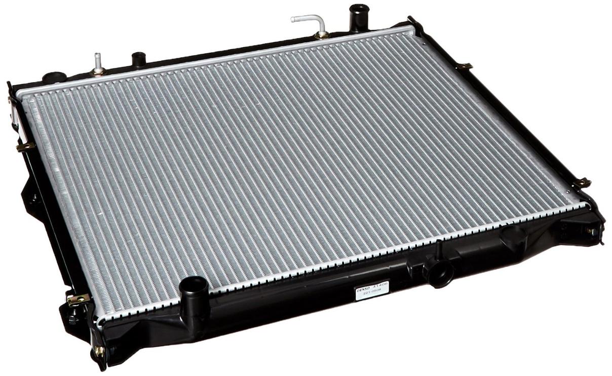

That is a very nice setup! I'm pretty convinced that our radiators are different though. I unscrewed that nut around the L-shaped port, and that thing wasn't rotating for the life of me. In fact, I could see the inlet port physically moving when I was trying to rotate the L-return port. I didn't want to break that section of the radiator, so I stopped. Once I replaced that nut and was trying to force on the 5/16 hose (yeah I know, too small) the L-shaped port moved toward the driver side. I figured maybe it only rotated with that nut on, so I kept pushing...until I realized I was physically bending the port.
To me it looks like I can see the difference in construction between my radiator's L-return and yours (attached the Amazon product photo). It's too bad though because I *really* like your install and how it's on the driver's side. There's so much less going on over there and more room for it to breathe. Ah well, the zipties have been tightened anyway, so it is where it is now (almost exactly where mtbtim's video shows).
