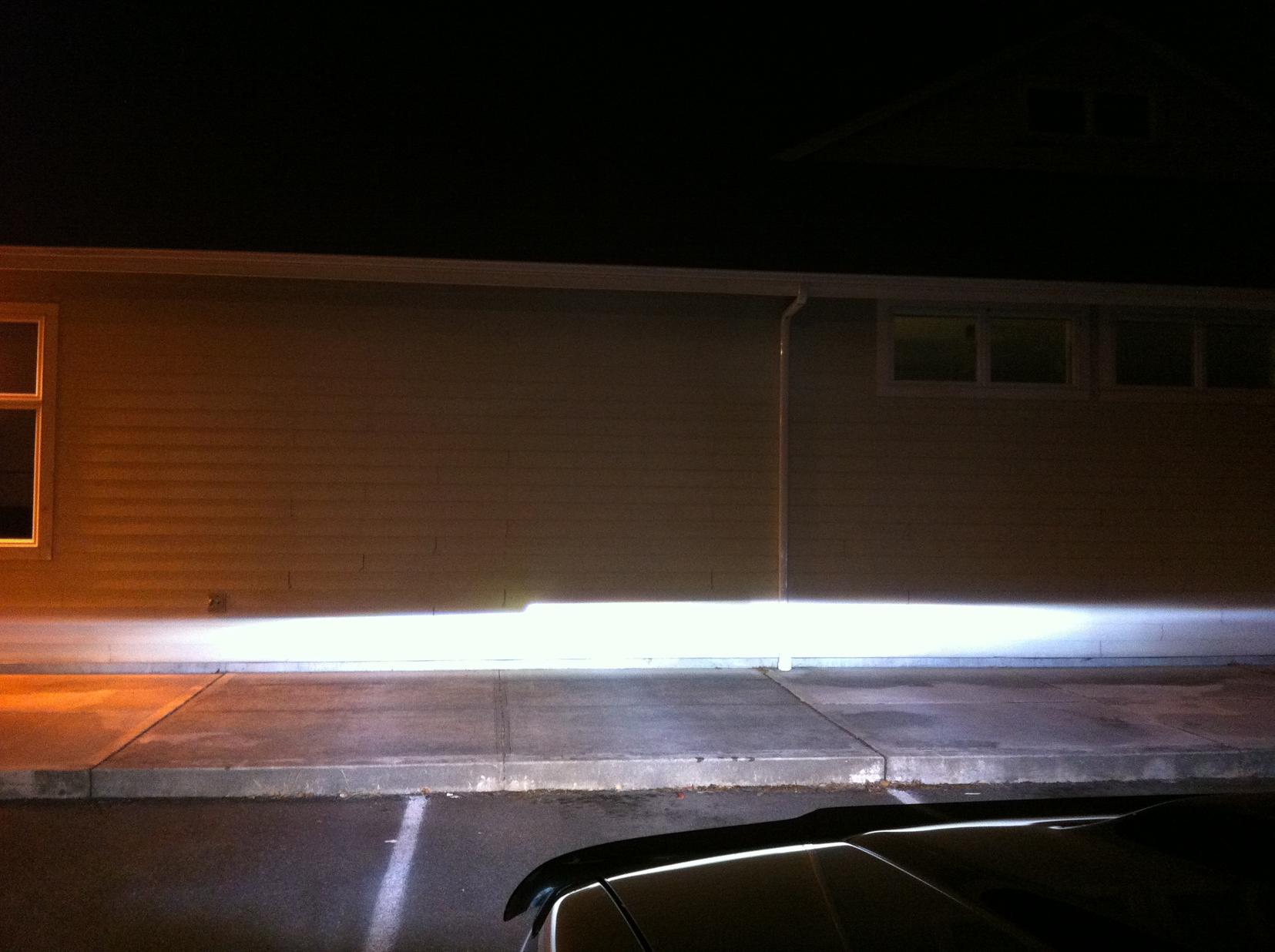

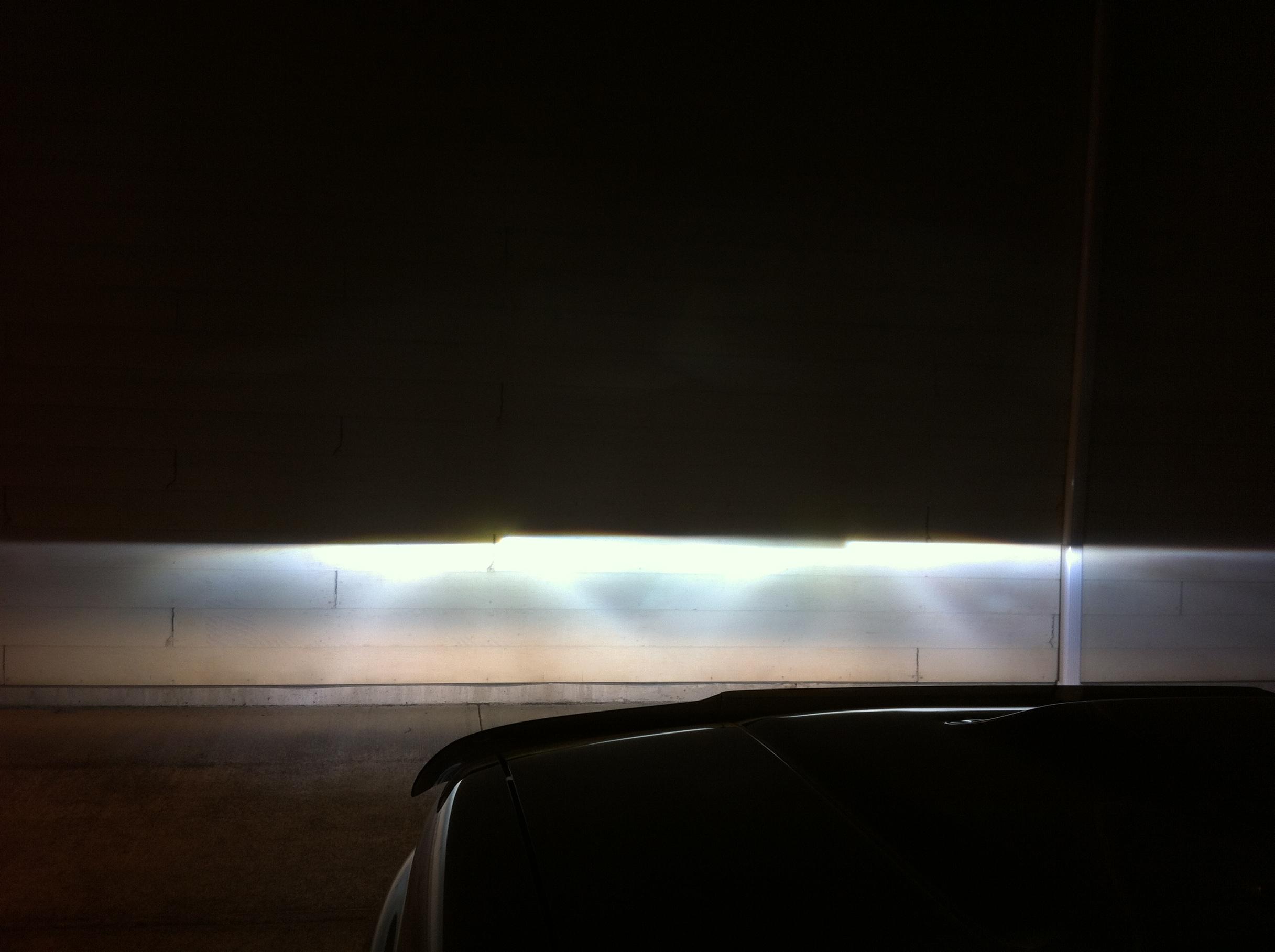

My output shots were clearly taken with a potato, and I apologize for that...
One shot is at ~30ft away, and one is ~8ft away.
This was just a hasty aiming with intent of being driveable this evening. Tomorrow I will complete the aiming using Rickashay's guide.

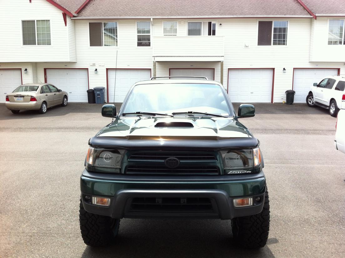

Last shot is everything assembled... The TOYTEC decal was just a feeler; it didn't feel good and is now gone. I wish folks made decals more discreet, but I guess that's counterproductive to free advertising...

Well, I toyed with the aiming a bit more and this was the result. They're still a bit low, but I know if I were in a small car, I'd appreciate that. PLENTY bright.
